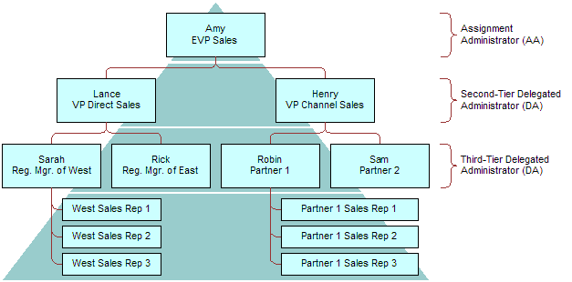

      The following figure provides a sample process flowchart of the delegated assignment feature. Each of the process steps are explained in further detail later in this chapter.
      Sample Process Flowchart for Delegated Assignment: This image is described in the surrounding text.
      This figure shows the following relationships:
      • Amy is the EVP of Sales and is the assignment administrator. Amy must first create root-level rule groups, child rule groups, and rules, and add criteria templates and owners of the child rule groups to the assignment rules before delegated assignment can be implemented.
      • Lance and Henry are Sales VPs and are delegated administrators (second-tier). Lance and Henry must first inherit rules in the rule group Amy created for their respective areas, and can then further refine and delegate those rules further down the hierarchy.
      • Rick and Sarah are Sales Managers and are delegated administrators (third-tier). Rick and Sarah inherit the rules created by Lance for their respective areas, and then further refine those rules for their sales representatives.
      • Robin and Sam are Partners and are delegated administrators (third-tier, similar to Rick and Sarah). Robin and Sam inherit the rules created by Henry for their respective areas, and then further refine those rules for their sales representatives.

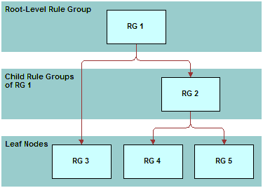

              A parent rule group is a rule group that directly precedes another rule group in the hierarchy. A root-level rule group is a rule group without a parent. For example, in the following image, RG 2 is the parent of RG 4, but RG 2 is not a root-level rule group. Only RG 1 is a root-level rule group, because it is the only rule group in the hierarchy that does not have a parent rule group (and, subsequently, is at the head of the hierarchy).
              The following image provides a sample rule hierarchy that shows how parent and root rule groups relate to other rule groups in the same hierarchy.
              Relationships Between Parent and Child Rule Groups in a Hierarchy: In this image RG1 (root-level rule group) has the following children: RG2 and RG3 (leaf node). RG2 has the following children: RG4 and RG5 (both of which are leaf nodes).
              This image shows the following relationships:
              • Rule groups that have no parent are root-level rule groups. There is only one root-level rule group for each hierarchy and that root-level rule group appears at the head of the hierarchy (RG1).
                Note: Only assignment administrators (not delegated administrators) can create root-level rule groups.
              • Rule groups that are parents to no other rule groups (rule groups with no child rule groups) are considered leaf rule groups and appear at the lower levels of the hierarchy (RG3, RG4, and RG5).
              • Rules at the leaf nodes are processed first by Assignment Manager. If none of those rules pass, then Assignment Manager processes rules in the set of rule groups that precedes the leaf nodes, and so on, until the root-level rule group is processed. This method of processing the rules ensures that, if a rule is inherited from one rule group to another, then the inherited rule is passed first.
                Note: The Default Rule Group is a root-level rule group (has no parent) as well as a leaf node (has no child).

                                                A sales organization for a high tech company wants to create assignment rules that are inheritable and configurable by several different levels in the organization. The requirements are:
                                                • Handle large sales leads internally; handle small sales leads externally using partners
                                                • Promptly assign sales leads to the most qualified representative
                                                • Design complex assignment rules, making use of the delegated assignment inheritance and criteria templates features to allow for uncomplicated rule administration by persons at all levels
                                                In this scenario, the Sales EVP, vice presidents, regional sales managers, partners, and sales representatives participate in delegated assignment for one rule group hierarchy, as shown in the following figure.
                                                The following figure shows the following relationships:
                                                • Amy, Executive Vice President of Sales, is the assignment administrator (AA).
                                                • Two vice presidents report to Amy:
                                                  • Lance, VP Direct Sales
                                                  • Henry, VP Channel Sales
                                                  Lance and Henry are second-tier delegated administrators.
                                                • Two managers report to Lance:
                                                  • Rick, Eastern Regional Manager
                                                  • Sarah, Western Regional Manager
                                                  Rick and Sarah are third-tier delegated administrators (DAs).
                                                • Two partners report to Henry:
                                                  • Robin, Partner 1
                                                  • Sam, Partner 2
                                                  Robin and Sam are also third-tier delegated administrators (DAs).
                                                • Three Western regional sales representatives report to Sarah.
                                                • Three partner sales representatives report to Robin.
                                                Sample Delegated Assignment Organization Chart: This image is described in the surrounding text.
                                                The following table provides sample responsibilities for each of the positions discussed previously.

                                                          This topic is part of Examples for Using Delegated Assignment.
                                                          The following bullet points further summarize the delegated assignment activities as they pertain to the examples provided:
                                                          • The examples describe a four-level assignment model. However, this is no limit to the number of levels that the delegated assignment feature supports, and there is no limit to the number of branches in a level. In these examples, the levels are:
                                                            Level 1 = Amy
                                                            Level 2 = Lance, Henry
                                                            Level 3 = Rick, Sarah; Robin, Sam
                                                            Level 4 = Eastern and Western Sales Reps; Partner 1 and Partner 2 Sales Reps
                                                          • Rule group hierarchies are executed from the bottom up (from the lower levels to the higher levels of the hierarchy). For example, Assignment Manager attempts to use Robin's rules to match a particular lead to a candidate before it tries to use Henry's rules. However, if Robin's rules fail, then Assignment Manager then tries Henry's rules, and assigns the lead to Robin, and so on up the hierarchy.
                                                          • Each rule group owner can assign a designee.
                                                            Designees have the same responsibilities as an owner. You might want to delegate your ownership to someone else, such as an administrative assistant, to perform the tasks.
                                                          • Each partner might assign one person as the delegated administrator (in these examples, either Robin or Sam) and that person would manage the partner's rule group. This same person should receive all leads that are not assigned to the partner's sales representatives.
                                                          • AAs and DAs can create new criteria (you are not required to use criteria templates). However, it is recommended that the AA create criteria templates for the most common criteria to ease the learning curve for the DAs.
