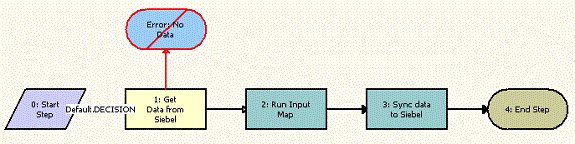

The following figure includes an example workflow process that passes a large property set from the Create Siebel Message step to the 11i Process Order step.
If you configure a sub process step to support Pass By Reference, then it is not necessary to map the output argument in the sub process step for the hierarchical properties that Siebel CRM passes. The sub process step overwrites the passed input hierarchical argument. Optionally, you can define the sub process step to modify the passed input hierarchical argument.

You can define a test workflow process that uses a Siebel operation to update a process property. For example, you can use the sum of two business component integer fields that provide input to a decision that resides downstream in the workflow process. Siebel CRM uses the sum of the two required fields to update a process property in the Siebel operation step. You can then use this property on a subsequent branch connector.
The example in this topic references the Action business object.
To use a Siebel operation step to update a process property
In Siebel Tools, add a new workflow process using values from the following table.
Property
Value
Process Name
Updating a Process Property
Business Object
Action
Workflow Mode
Service Flow
For an example, see Creating the Workflow Process.
Add steps and connectors until your workflow process resembles the workflow illustrated in the following figure:
For more information, see Overview of Workflow Process Steps, and Diagramming a Workflow Process.
