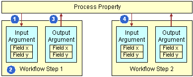

The following figure describes how Siebel CRM uses a process property in a workflow process.
How Siebel CRM Uses a Process Property in a Workflow Process: This image is described in the surrounding text.
Explanation of Callouts
Siebel CRM does the following when it uses a process property in a workflow process:
  1. The process property sends data to Workflow Step 1 as an input argument.
  2. Workflow Step 1 modifies the data according to the configuration for Step 1.
  3. An output argument on Workflow Step 1 sends data from the step to the process property.
  4. An input argument on Workflow Step 2 brings the data that Step 1 uses into Workflow Step 2, where the workflow process can use it according to the internal configuration that is defined for workflow Step 2.
You can define the process property and step arguments in the Multi Value Property Window. For more information, see Using the Multi Value Property Window.

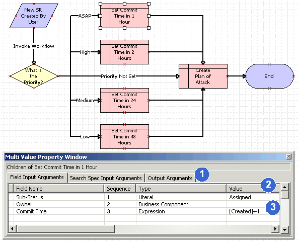

The following figure includes an example of the MVPW that displays the arguments of the Set Commit Time in 1 Hour step.
Multi Value Property Window Displaying the Arguments of an Object: This image is described in the surrounding text.
If you choose an object in the canvas, then the MVPW includes the following items:
  1. Argument tab. The argument tabs change depending on the type of step that you choose.
  2. Field. A field in the MVPW is a parameter that you can specify that provides instructions for the argument. MVPW Usage with the Step Argument displays the Field Name, Sequence, Type and Value fields.
  3. Argument. All the fields of a single row in the MVPW represents the definition of a single argument.

Passing a Process Property In and Out of a Workflow Process Step
It is recommended that the Type field of the top level of a hierarchical argument not contain data. If Siebel Workflow passes a hierarchical process property to a workflow process step, then it overwrites the Type field of the top level process property for the duration of the call. It does this so that the process property matches the name of the argument that the configuration for the input argument defines. This configuration applies only for a long-running, interactive, or service workflow process.
For example, assume MyTree is a process property and that the data type for this process property is Hierarchy. MyBusSvc is a business service that contains a hierarchical input argument named SomeTree. The following table describes the configuration for this process property.
Input Argument Type Property Name
SomeTree
Process Property
MyTree
Business Object
The name of the associated business object.
Created By
The name of the person who creates the process.
Created
The date that the process is created.
If you use the values that this table describes to define the input argument, then the call to MyBusSvc receives a child in the input process property for the argument where the Process Property Type field is set to SomeTree instead of MyTree. The rest of the data in the child process property remains the same as the contents of the MyTree process property.
Siebel Workflow expects an output argument of a workflow process step that passes out a hierarchy as a child of the output property set. To locate the child, Siebel Workflow examines the Type field of the child.
The string in the Type field must match the name of the Output Argument field, as defined in the output argument applet of the step. If Siebel Workflow finds such a child, then it does the following:
  • Copies the data into the destination process property.
  • Discards the Type field on the incoming hierarchy.
  • Replaces the value that the Type field contains with the name of the process property.

Configuring a Decision Condition for a Workflow Process
This topic describes how to use the Compose Condition Criteria dialog box to configure a decision condition for a workflow process. It includes the following topics:
To define conditional logic in a workflow process, you define conditions and values that determine the path that the workflow process pursues. For example, you can define a decision condition that uses the value of a priority field:
  • If the priority is equal to high, then the workflow process pursues a branch that includes a step that sends an email to a vice president.
  • If the priority is equal to medium, then the workflow process sends an email to an engineer.
You can define a decision condition for the following items:
  • Start step
  • Decision point
  • Wait step
  • User interact step
Viewing an Example of a Decision Condition
This book includes several examples that use a decision condition. Here are two examples:
  • If the Revenue field in the Opportunity business component is greater than $10,000, then insert an activity for the parent opportunity. To examine the example that uses this condition, see Defining a Decision Condition for the Decision Point.
  • Use a CASE statement to identify one of several branches to pursue in the workflow process, depending on the value of the Priority field in the Service Request business component. Insert an activity with a value for the commit time according to the result of the CASE statement. To examine the example that uses this condition, see Defining a Workflow Process That Creates a Service Request.
Adding a Branch Connector
A branch connector is a type of connector in a workflow process that can include a decision condition. You define conditional logic on a connector that emanates out of the step, and not on the step itself. A branch connector typically emanates from a start step, decision point, wait step, or user interact step.
To add a branch connector
  1. Move, and then place a connector from the palette to the canvas. Make sure you connect the decision point with the new next step.
    Make sure that the connector is correctly attached. For more information, see Diagramming a Workflow Process.
  2. Make sure the connector you added in the previous step is still chosen in the Process Designer.
  3. In the Properties window, enter or modify the connector name.
    The connector name must be unique in the workflow process. If it is not unique, then you cannot save the workflow process.
  4. Set the Type property.
    In most situations, this value is Condition or Default. If you define a decision condition on the connector, then choose Condition. If you use this connector as an exit route, then choose Default. You can set other values. For more information, see the topic about the Connector object type in Siebel Object Types Reference.
    If you define multiple branches on this step, then, for caution information, see Adding Multiple Branches to a Single Workflow Process Step.
  5. Enter comments.
  6. Define the decision condition, if necessary.
    If you use this connector to incorporate conditional logic, then use the Compose Condition Criteria dialog box. For more information, see Creating a Decision Condition on a Branch Connector.
You can use the Compose Condition Criteria dialog box to define a decision condition on a branch connector. A branch connector can be a connector that emanates from a start step, decision point, wait step, or user interact step. The Compose Condition Criteria dialog box constrains the values that it lists according to the Business Object property of the workflow process. For an example that uses conditional logic on a connector, see Defining a Decision Condition for the Decision Point.
To create a decision condition on a branch connector
  1. In the Process Designer, right-click the connector where you must define a decision condition.
  2. Choose Edit Conditions.
  3. In the Compose Condition Criteria dialog box, create a condition.
    For more information, see Configuring a Decision Condition for a Workflow Process.
  4. Click OK.
A start step, decision point, wait step, or user interact step can each reference multiple branch connectors.
Caution: If you define multiple branch connectors, then make sure you define at least one connector with the Type property set to Default. This configuration makes sure an exit route exists if a work item does not meet any of the decision conditions. If you do not do this, then you might create an infinite loop.
To add multiple branches to a single workflow process step
  • Do the procedure described in Adding a Branch Connector for each branch that you must define for the step. Each branch can contain a separate decision condition.
