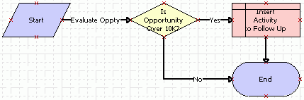

In the Workflow Processes list, right-click the workflow you defined in Creating the Workflow Process, and then choose Edit Workflow Process.
Add steps and connectors until your workflow process resembles the workflow illustrated in the following figure:
For more information, see Overview of Workflow Process Steps, and Diagramming a Workflow Process.
Click the decision point, and then use the Properties window to change the Name property to the value described in the following table.
Property
Value
Name
Is Opportunity Over 10k?
The Properties window is context-sensitive. If you click a step or connector in the Process Designer, then Siebel Tools displays the properties for the step or connector in the Properties window. If the Properties window is not visible, then right-click a step, and then click View Properties Window.
Clicking each remaining step in succession, use the Properties window to change the Name property for each step according to values described in the following table.
Step Type
Name Property
Siebel Operation
Insert Activity to Follow Up
End
End
Clicking each connector in succession, use the Properties window to change the Name property for the connector according to values described in the following table.

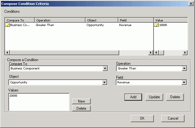

To define a decision condition for the decision point
In the Process Designer, right-click the Yes connector, and then choose Edit Conditions.
For more information, see Adding a Branch Connector.
In the Compare To drop-down list, choose Business Component.
The value you choose in the Compare To drop-down list instructs Siebel CRM to use an object, expression, or process property in the comparison. In this example, it compares the run-time value of a field from the Opportunity business component, as defined in the Object drop-down list. The items in the Object drop-down list are context- sensitive. Siebel Tools changes them according to the value you choose in the Compare To drop-down list.
In the Object drop-down list, choose Opportunity.
In the Operation drop-down list, choose Greater Than.
In this example, if the value you define in the Values window of the Compose Condition Criteria dialog box is greater than the run-time value of the Revenue field for the business component, then the Operation drop-down list defines the decision condition. You define the Revenue field in the Field window.
In the Field window, choose Revenue.
In the Values window, click New to add a new value.
In the Add Value dialog box, type 10000, and then click OK.
In the Compose Condition Criteria dialog box, click Add.
Siebel Tools adds the decision condition that you define in the lower portion of the Compose Condition Criteria dialog box to the Conditions list in the upper portion of the dialog box. You can now add another decision condition. For this example, you add only a single decision condition.
The decision condition you set in the Compose Condition Criteria dialog box must resemble the condition illustrated in the following figure. At run time, if the Revenue field of an opportunity is greater than 10000, then Siebel CRM runs the Yes branch. Otherwise, it runs the No branch:
Click OK.

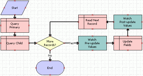

Defining a Workflow Process That Traverses a Record Set to Close Service Requests
In this topic you create a workflow process that traverses a record set to close obsolete service requests. To develop this example, you do the following tasks:
This example identifies, and then closes obsolete service requests. If a service request is more than one year old, and if the Status for this service request is not Closed or is Cancelled, then Siebel CRM must consider the service request as obsolete. The workflow process identifies obsolete service requests, and then traverses the resulting record set. It does the following:
Changes the Status for each obsolete service request to Cancelled
Changes the Sub-Status to Resolved
Changes the Close Date to the current date
Adds a message to the Description field that indicates that the service request was cancelled due to obsolescence
For more information about the configuration used in this example, see Using a Siebel Operation Step to Traverse a Record Set.

In this topic you create a workflow process that does the following:
Accepts a record of the Service Request business component. It does not process this record.
To identify obsolete service requests, it queries the Service Request No Link business component for records whose Created date is more than one year old and whose Status is not Closed or Cancelled.
Traverses records in the query result, modifying the Status, Sub-Status, Close Date, and Description fields so that they indicate the obsolete status of the record. For more information, see Using a Siebel Operation Step to Traverse a Record Set.

Add steps and connectors until your workflow process resembles the workflow illustrated in the following figure.
The business service steps allow you to use the Watch window to debug the workflow. You remove them later.

Defining a Decision Condition for the Decision Point
This task is a step in Defining a Workflow Process That Traverses a Record Set to Close Service Requests.
In this topic you define a decision condition for the decision point.
Click the Yes connector.
In the Properties window, set the Type property to Condition.
Right-click the Yes connector, and then choose Edit Conditions.
Define the following decision condition, and then click Add.
Property
Value
Compare To
Process Property
Operation
Greater Than
Object
NumAcceptedRecords
Value
0
This decision condition handles the situation where the query returns no records. If this condition is met, then the workflow process runs the No connector.
Property
Value
Compare To
Process Property
Operation
All Must Match (Ignore Case)
Object
noRecord
Value
false
This decision condition determines when the workflow process reaches the end of the record set in situations where the query returns at least one record. For more information, see Creating a Decision Condition on a Branch Connector.
Click OK.
Click the No connector. Make sure the Type property in the Properties window is set to Default.
Configuring the Remaining Workflow Steps
In this topic you configure the remaining workflow steps.
To configure the remaining workflow steps
Click the Watch Pre-update Values workflow step.
Use the Properties window to define values described in the following table.
Property
Value
Business Service Name
Workflow Utilities
Business Service Method
Echo
The Workflow Utilities business service allows you to view variables that the Watch window displays. For more information, see Workflow Utilities Business Service.
In the MVPW, click the Output Arguments tab. Add four new output arguments using values from the following table.
Property Name Type Business Component Name Business Component Field SR Close Date
Business Component
Closed Date
SR Description
Business Component
Description
SR Created Date
Business Component
Created
SR Status
Business Component
Status
This workflow process step provides data that the Workflow Utility business service uses to display field values for the business component record that Siebel CRM is currently processing. Siebel Tools displays these values in the Watch window before it updates them.
Depending on your testing requirements, you can display more descriptive record data, such as data from the Abstract field. To display other record data, you can define another field, similar as you did with the fields described in Creating the Child Business Component. In the workflow process, you define a process property that references this field, and then add an Output Argument on the Workflow Utility business service that references the new process property.
Click the Update Fields workflow step.
Property Value Business Component
Operation
Update
In the MVPW, click the Field Input Arguments tab. Add three new input arguments using values from the following table.
Field Name Type Value Closed Date
Expression
Timestamp()
Description
Literal
This SR's Status set to Cancelled due to this SR's obsolescence
Status
Literal
Cancelled
Click the Watch Post-update Values workflow step.
Property
Value
Workflow Utilities
Echo
In the MVPW, click the Output Arguments tab, and then add four new output arguments using values from the following table.
Business Component
Closed Date
SR Description
Business Component
Description
SR Created Date
Business Component
Created
SR Status
Business Component
Status
Click the Read Next Record workflow step.
Property
Value
Business Component
Operation
NextRecord
In the MVPW, click the Output Arguments tab, and then add a new output argument using values from the following table.
Field
Value
Property Name
noRecord
Type
Output Argument
Output Argument
NoMoreRecords
Add a second argument using values from the following table.
Field
Value
Property Name
vRowId
Type
Business Component
Id
Choose the File menu, and then the Save menu item.

In this example, one record meets the search specification that is defined on the Query Child step.
noRecord
false
noRecord is a process property that references NoMoreRecords, which is a variable that the traversing a record set configuration uses.
The NextRecord operation sets NoMoreRecords to true if there are no more records to traverse in the record set.
The NextRecord operation on the Read Next Record workflow process step writes the value of NoMoreRecords to the noRecord process property. It does this write operation for every iteration through the record set.
The BusComp section of the Watch window only displays record data from the query that Siebel Tools runs on the primary business component. This information does not change for the remainder of the simulation. For more information, see Defining the Primary Business Component.
Click Simulate Next.
The simulator runs the More Records decision point, and then highlights the Watch Pre-update Values step. To determine if flow continues or stops, the Yes connector performs two tests:
A value of 0 in NumAcceptedRows indicates that no records match the search specification on the Query Child workflow process step.
A value of true in noRecord indicates that there are no more records to process in the record set.
If either of these situations is true, then the workflow process ends.
In this example, the value for NumAcceptedRecords is 1 and noRecord is false. Siebel CRM runs the Yes connector.
The simulator runs the Watch Pre-update Values step, and then highlights the Update Fields step.
Several values under the Process Properties entry in the Watch window update when this step runs. Four service request fields that Siebel Tools modifies during the example are defined. Writing to the Watch window before and after the Update Fields workflow process step allows you to determine if the workflow process correctly updates the business component fields. The following table describes these values.
Property
Value
Explanation
SR Close Date
(empty)
The search specification on the Query Child workflow process step excludes closed records. The Close Date is empty.
SR Description
Test SR
The test records include Test SR in the Description. This value makes sure that Siebel Tools evaluates only the records that exist in the test record set.
SR Status
Open
The search specification on the Query Child workflow process step:
Excludes service requests that are Closed or Cancelled.
Includes service requests that are Open, Pending, Field Visit, or Quoted. The record set in this example includes only one record and it is Open.
noRecord
false
The NextRecord operation does not run, so noRecord contains false.
The simulator runs the Update Fields step, and then highlights the Watch Post-update Values step. The Update Fields step updates values in three service request fields. Siebel Tools does not display the new values until the workflow process writes the updated information to the Watch window.
The simulator runs the Watch Post-update Values step, and then highlights the Read Next Record step. The Watch window displays the updated values for the business component record, as described in the following table.
Property
Value
Description
SR Close Date
11/12/2007 14:21:04
Set by the Input Argument on the Update Fields process step.
SR Description
The Status for this service request is set to Cancelled due to the obsolescence for the service request.
SR Status
Cancelled
noRecord
false
NextRecord operation is not run, so noRecord still contains false.
The simulator runs the Read Next Record step, and then highlights the More Records decision point. Values for the process properties remain constant in the Watch window except for noRecord. The record set includes only one record, so the NextRecord operation sets noRecord to true.
The simulator runs the decision point, and then highlights the End workflow process step. To run the simulation again, you must first reset values that the simulation changed in the record set. This simulation modifies one record. You must reset the SR Description for this record to SR Test and reset Status to Open.

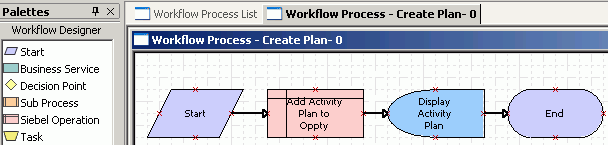

In Siebel Tools, create a new workflow process using values from the following table.
Property Value Process Name
Create Plan
Business Object
Opportunity
Workflow Mode
Interactive Flow
For an example, see Creating the Workflow Process.
In the Workflow Processes list, right-click the new workflow process, and then choose Edit Workflow Process.

In the Process Designer, click the Add Activity Plan to Oppty step.
In the Properties window, define the business component and the operation. Use values described in the following table.
Property
Value
Business Component
Activity Plan
Operation
Insert
If you configure an Insert operation on a business component, then you must supply a value for each business component fields that is required. To insert a new activity plan, you must provide the name of the template that Siebel CRM uses for the activity plan.
Make sure the Add Activity Plan to Oppty workflow step is still chosen in the Process Designer.
In the MVPW, add a new input argument using values from the following table.
Field Name
Type
Value
Template
Literal
A valid activity template name, such as Introductory Sales Call.
For more information, see Arguments That You Can Define for a Process Property.
In the Process Designer, choose the Display Activity Plan step.
Use the Properties window to the view that Siebel CRM displays for the Display Activity Plan user interact step. Use values described in the following table.
Property
Value
User Interact View
Opportunity Activity Plan

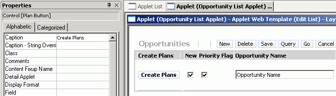

To start the workflow process in this example, you add a button to the Opportunity list. If the user clicks this button, then Siebel CRM starts the workflow process. For more information, see Starting a Workflow Process.
To how the workflow process is started
In Siebel Tools, in the Object Explorer, click Applet.
In the Applets list, query the Name property for Opportunity List Applet.
Right-click, and then click Edit Web Layout.
In the Controls/Columns window, set the Mode to 3: Edit List.
Siebel Tools sets the Mode to 1:Base, by default. You must set it to 3:Edit List. If the Controls/Columns window is not visible, then choose the View menu, Windows, and then the Controls Window menu item.
Move a Button control from the palette to the layout, and then set the properties for the control using values from the following table.
Property Value Caption-String Override
Create Plans
HTML Type
MiniButton
MethodInvoked
EventMethodCreateActivityPlan
Siebel Tools does not display the value that the table describes for the MethodInvoked property. You must manually enter the value for MethodInvoked.
A method that uses the following naming format does not require an applet or script on a business component to allow the event:
EventMethod a string value
If you do not use this naming format, and if you must use the event, then you must write a WebApplet_PreCanInvokeMethod script.
Preview the applet. Make sure the new Create Plan button displays as illustrated in the following figure.
Save your changes.

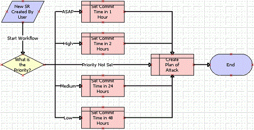

Click each connector in succession that emanates from the decision point. In the figure in Creating the Workflow Process, these connectors are labeled ASAP, High, Medium, and Low. As you click each connector, make sure the Type property in the Properties window is set to Condition.
Click the connector labeled Priority Not Set, and then define properties using values from the following table.
Property
Value
Type
Default
Right-click the ASAP connector, and then choose Edit Conditions.
In the Compose Condition Criteria dialog box, define the decision condition using values from the following table.
Property Value Compare To
Business Component
Operation
Object
Service Request
Field
Priority
Value
1-ASAP
You define a separate decision condition for each of the ASAP, High, Medium, and Low connectors. Each conditional statement corresponds to a Priority value. This workflow process adjusts the Commit Time in the subsequent Siebel operation step depending on the outcome of the evaluation it makes for each priority in the decision condition for the priority connector. For more information, see Creating a Decision Condition on a Branch Connector.
Right-click the High connector, and then choose Edit Conditions to access the Compose Condition Criteria dialog box.
Business Component
Operation
Object
Service Request
Field
Priority
Value
2-High
Right-click the Medium connector, and then choose Edit Conditions to access the Compose Condition Criteria dialog box.
Business Component
Operation
Object
Service Request
Field
Priority
Value
3-Medium
Right-click the Low connector, and then choose Edit Conditions to access the Compose Condition Criteria dialog box.
Business Component
Operation
Object
Service Request
Field
Priority
Value
4-Low
In this example you define several connectors, and then place them on the canvas consecutively. If your workflow process includes multiple connectors, and if each of the definitions for these connectors are similar to one another, then you can use an alternative technique. You can define a single branch connector, define the decision condition for it, and then copy and paste it for use elsewhere in the workflow process. You can then modify the condition for each connector, as necessary. In this example you only modify the Value. You can use the same cut and paste technique to define the Siebel operation steps in this example.

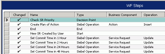

To define properties for the Siebel operation steps
If necessary, display the WF Step Branch object type in the Object Explorer.
For more information, see Displaying Object Types You Use to Develop a Workflow Process.
In the Workflow Processes list, query the Process Name property for the Manage New SR workflow process.
In the Object Explorer, expand the Workflow Process tree, and then click WF Step.
Right-click in the WF Steps list, and then choose Columns Displayed.
Set the Business Component property and the Operation property for each of the Siebel operation steps in the workflow process. The resulting properties must resemble the properties displayed in the following figure.

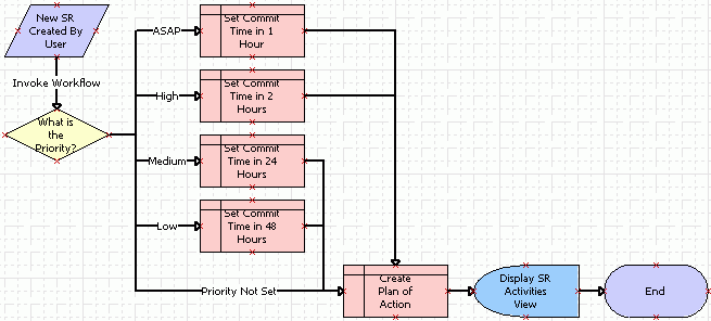

Right-click the workflow process named Manage New SR-Navigate User to SR Activity, and then choose Edit Workflow Process.
Move, and then place a User Interact step from the palette to the canvas, placing it between the Create Plan of Action step and the End step.
Add connectors between the Create Plan of Action step and the user interact step, and between the user interact step and the End step, as illustrated in the following figure:
Click the user interact step, and then use the Properties window to set properties using values from the following table.
Property
Value
Name
Display SR Activities View
User Interact View
Service Request Detail View
Confirm the value that you set for the User Interact View property:
In the Siebel client, navigate to the Service Requests screen, and then the All Service Requests view.
Click the Activities view tab.
Choose the Help menu, and then the About View menu item.
Siebel CRM displays the required view name.
Click the connector that connects the user interact step with the end step, and then use the Properties window to set properties using values from the following table.

Testing and Deploying the Workflow Process
This task is a step in Defining a Workflow Process That Creates a Service Request and Navigates the User.
In this topic you test and deploy the workflow process.
To test and deploy the workflow process
Validate, and then simulate the workflow process.
For more information, see Process of Testing a Workflow.
Deliver workspace.
For more information, see Process of Deploying a Workflow Process.
Verifying Functionality of the Workflow Process
In this topic you verify that the workflow process implements the required functionality.
To verify functionality of the workflow process
In the Siebel client, navigate to the Administration-Business Process screen, and then the Workflow Deployment view.
Make sure only the latest version is active.
Set the Monitoring Level to 4-Debug.
Navigate to Administration, then RunTime events. Select event aliases, click Menu, and then choose Reload Runtime Events.
Navigate to the Service Request list view.
Create a new service request, define a Priority level, and then step off the record.
Siebel CRM displays an hourglass, and then enters information in the Owner, Sub-Status, and Date Committed fields. It creates a new activity that is associated with the new service request, navigates the user to the Activities view of the Service Request screen, and then displays the new activity.
Make sure that a workflow process instance exists for New SR Created-Take User to Activity in the Workflow Process Log view.
