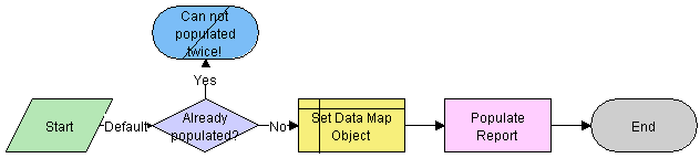

Click Populate Report.
This starts the LS Medical Product Issue Populate Report workflow, which copies data from the product issue according to the report type. For more information about the workflow, see LS Medical Product Issue Populate Report Workflow.

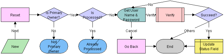

Generating Regulatory Report Numbers and Submitting Reports
When you generate a 3500A or MDV initial report:
The report number is generated and filled in
The Status field changes to Submitted
The fields in the regulatory report record become read-only (except for the Sub Status field)
Only the primary owner of the regulatory report can generate the report number and submit the report.
This task is a step in Process of Regulatory Reporting.
To generate and submit a regulatory report
Make sure the application is running on a server database.
You cannot generate a report number on the Siebel Mobile Web Client.
Navigate to Regulatory Reports screen, then the My Regulatory Reports view.
In the Regulatory Report List, drill down on a regulatory report with status of In Progress.
Click Generate.
This starts the LS Medical Product Issue RR Submit workflow, which authenticates the user, adds a number for the regulatory report, changes the status to Submitted, and makes all fields except Sub Status read-only.
For more information about the workflow, see LS Medical Product Issue RR Submit Workflow.
To submit the regulatory report to the FDA, click eMDR Queue.
This changes the Sub Status of the report to eMDR and places the report in the queue to be sent to the FDA at the end of the month. If you want to submit the report immediately, follow the instructions outlined in Transmitting Electronic Medical Device Reporting Immediately.
This workflow is initiated from the Populate button on the Regulatory Reports view of the Product Issues screen.
The workflow appears in the following figure.
Workflow Description
This workflow performs the following actions:
Checks if current record has already been populated. If it has, the workflow ends.
Sets the data map object according to the report type.
The data map objects are:
LS Medical PI Populate Report - 3500A
LS Medical PI Populate Report - 3500 Supplemental
LS Medical PI Populate Report - MDV Initial
LS Medical PI Populate Report - MDV Follow-up
Populates the report from the product issue according to the data map object.

LS Medical Product Issue RR Reopen Workflow
This workflow is initiated from the Reopen button on the Regulatory Reports screen.
Checks if the user is the primary owner. If not, the workflow ends.
Checks if the record has already been processed. If it has, the workflow ends.
Calls the LS Medical User Verification workflow. If the authentication does not pass, the workflow ends.
Sets the status of the report to Reopen.
