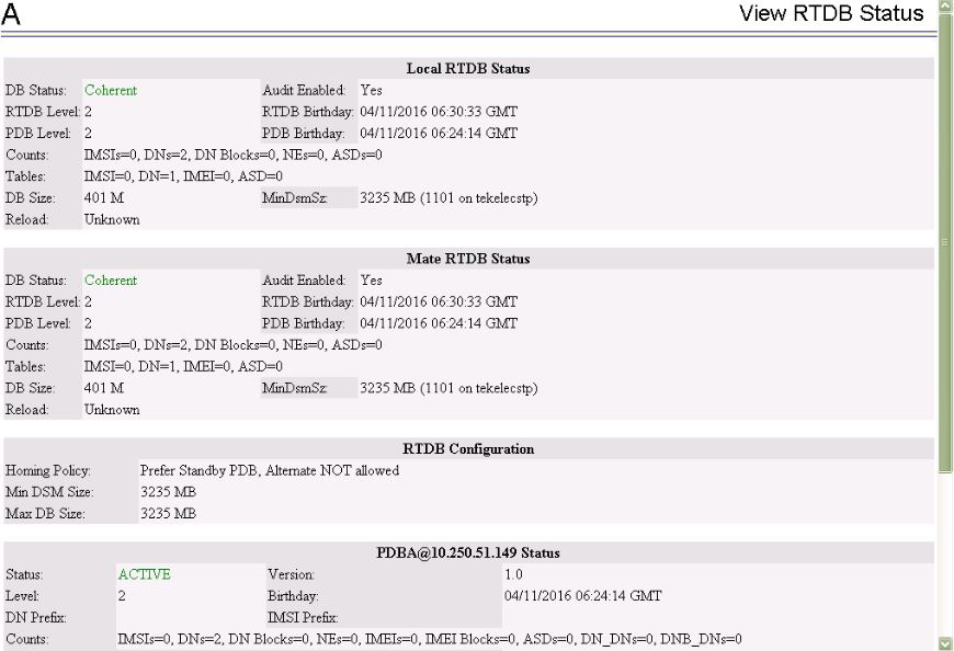

  4. Select RTDB>View RTDB Status and determine the homing policy for the PDBA.
    In the example shown in Figure 4-12, the Homing Policy shows that the Standby PDB is preferred for homing.
    Figure 4-12 Determining the Homing Policy
  5. At the EPAP indicated by the Homing Policy, repeat 3 and 5 to restart the PDBA.
