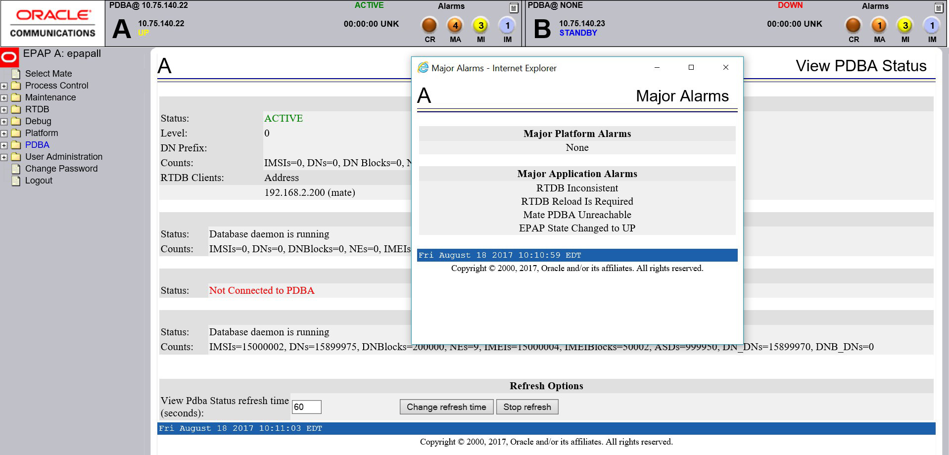

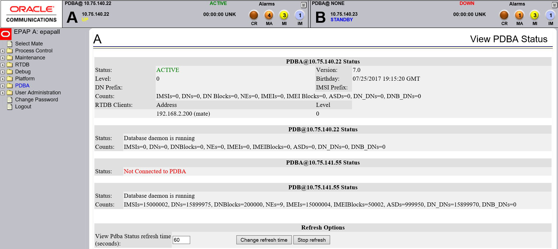

  2. Check the banner information above the menu for the PDBA status.
    1. If neither PDBA status is DOWN, go to 3.
    2. If status of one of the PDBAs is DOWN, continue with 4.
    Figure 4-8 shows an example in which the PDBA on EPAP B is DOWN.
    Figure 4-8 PDBA Down
  3. View Tool Tips to verify the alarm and to verify that you are logged into the EPAP whose PDBA is DOWN.

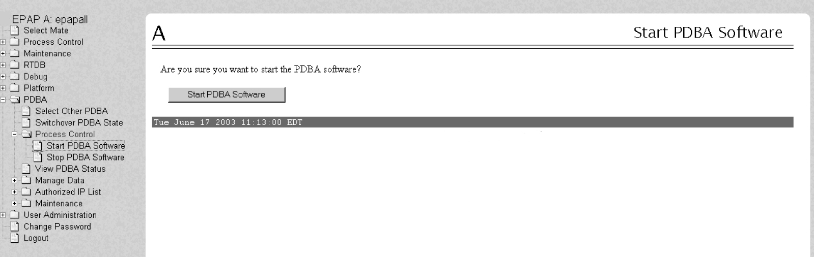

  4. Attempt to start the PDBA by selecting PDBA> Process Control > Start PDBA Software.
    The window shown in Figure 4-10 is displayed.
    Figure 4-10 Start PDBA

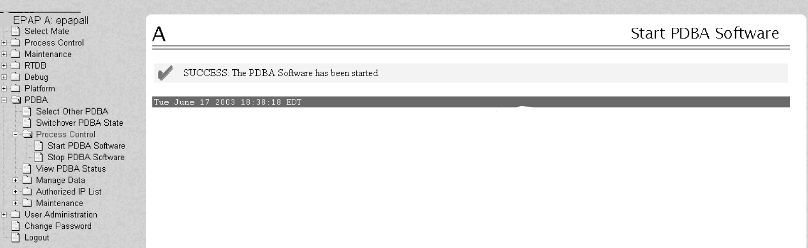

  5. Click the Start PDBA Software button.
  6. When the PDBA software has been started, the window shown in Figure 4-11 displays, and within moments the banner will show the PDBA status as ACTIVE or STANDBY.
    If the status does not change to ACTIVE or STANDBY, continue to 7.
    Figure 4-11 PDBA Started
