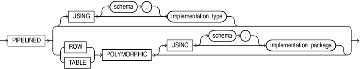

pipelined_clause ::=

PIPELINED [ ROW | TABLE ] POLYMORPHIC [ USING [schema.] implementation_package ]
