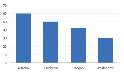

For example, this is the minimum PeopleCode to create a bar chart using the Chart class.
/* Declare and instantiate a chart object; */ Component Chart &cChart11; &cChart11 = GetChart(DOC_CHRT_WRK.DOC_CHRT_FLD_11); /* Set the chart data record and specify x-axis, y-axis, and series data; */ &cChart11.SetData(Record.DOC_CHRT_SLS_2); &cChart11.SetDataXAxis(DOC_CHRT_SLS_2.DOC_CHRT_RGN); &cChart11.SetDataYAxis(DOC_CHRT_SLS_2.DOC_CHRT_SALES);View the chart in the browser.

This is the bar chart generated by the example code and data. The default chart type for the Chart class is a bar chart. Since no colors are specified, the chart uses the default colors.
This example illustrates a simple bar chart:
