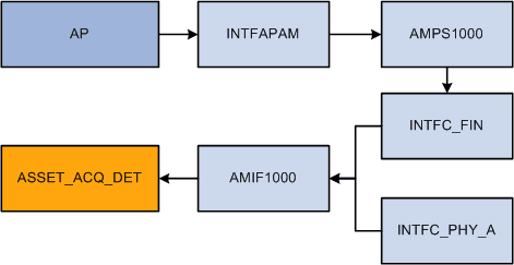

Recording GST in Payables and Passing GST on to Asset Management
To track the apportionment of GST that is relevant to an asset, four fields are passed to Asset Management from Payables using the Run Load Assets process (INTFAPAM):
Asset ID
Merchandise Amount
Non Recoverable VAT
Total VAT
Payables validates the information that you entered on the invoice before passing it to Asset Management.
Note: The invoice information must be validated in PeopleSoft Payables before it is passed to PeopleSoft Asset Management. Invoice information cannot be rejected once it has reached PeopleSoft Asset Management.
This diagram illustrates the interface process:
PeopleSoft Payables to PeopleSoft Asset Management GST process
