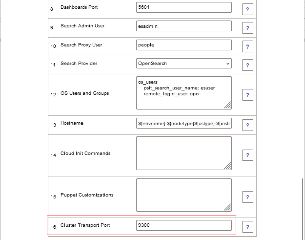

Opening the Cluster Transport Port
The node in a cluster communicates through a cluster transport port, which must be opened for the provisioned environment.
The default cluster transport port is 9300. When you provision an environment with a search cluster or add a node to a cluster, the port must be accessible. You enter the port number when creating an environment template.
To enable communication through the cluster transport port, access the details for the VCN used for the environment in the OCI console. Review the security rules for the VCN subnet where search instances are deployed. Verify that the search cluster transport port is accessible.
See the Cloud Manager tutorial Plan the Virtual Cloud Network for PeopleSoft Cloud Manager, on Oracle Help Center at https://docs.oracle.com/en/applications/peoplesoft/cloud-manager/index.html#InstallationTutorials.

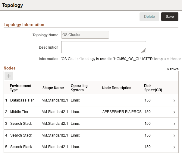

Creating Topology for Search Clusters
Create topology with a database node (Database on Compute or DB Systems), one or more mid-tier nodes, and as many search nodes as you want for the cluster. A minimum of three search nodes is recommended for fail-over and high availability. An odd number of search nodes is also recommended.
This example shows a sample topology with database on compute, mid-tier node, and three search nodes.
Topology Information page with three search nodes
Full-tier environments are not supported for search clusters.

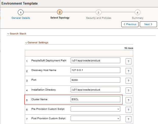

Creating an Environment Template for Search Clusters
Create an environment template based on the topology with multiple search nodes.
On the Select Topology page, in the Search Stack, General Settings sections, ensure that all of the nodes have the same values for Cluster Name (the default is ESCL) and Cluster Transport Port (the default is 9300).
This example illustrates the Environment Template - Select Topology page showing the Cluster Name field.
This example illustrates the Environment Template - Select Topology page showing the Cluster Transport Port field.
Complete the environment template creation.
See Creating a Template.

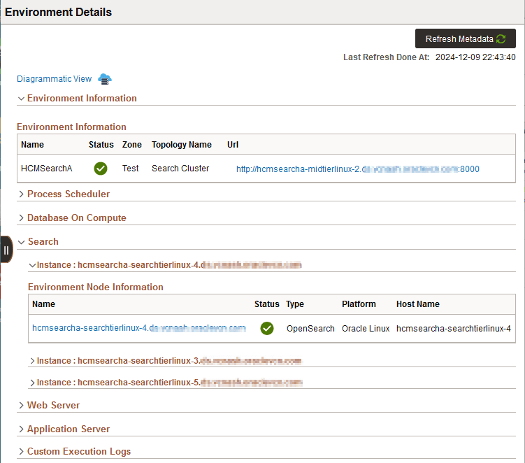

Click the Related Action button for the environment and select Details.
Expand the Search section on the Environment Details page to see the search nodes in the cluster.
This example illustrates the Environment Details page for an environment with a cluster comprised of three search nodes.
Click each instance name for details.

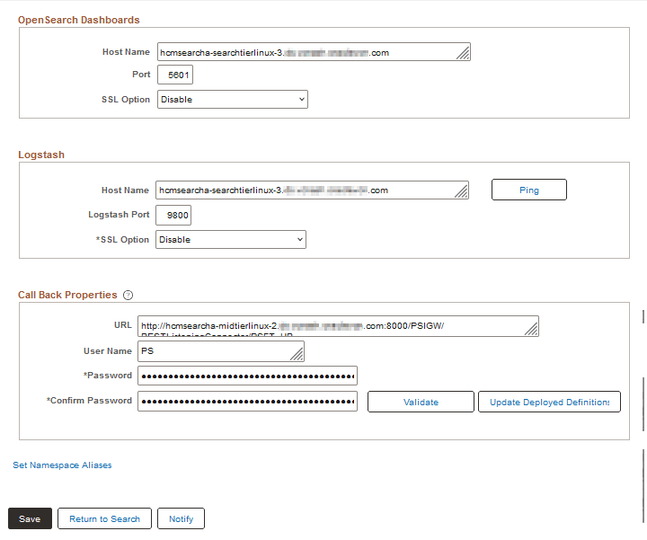

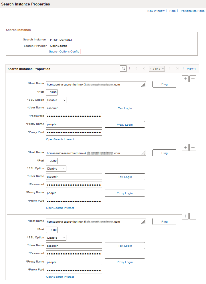

The PeopleSoft search instance configuration will be updated with metadata for all the nodes in the cluster. This ensures that the search instance configuration works even if a node is down. The Search Instance Properties grid lists the nodes in the cluster.
Note: The PeopleSoft search instance in this context refers to a single instance of the search engine in the PeopleSoft Search Framework.
This example illustrates the Search Instance Properties page with three search instances (1 of 2).
This example illustrates the Search Instance Properties page with three search instances (2 of 2)

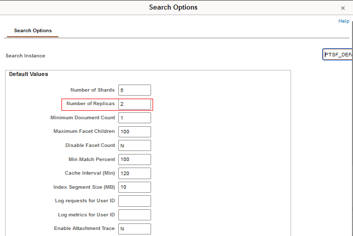

Select the link Search Options Config.
On the Search Options page, ensure that Number of Replicas is set to 1 (one) or greater.
This example illustrates the Search Options page with Number of Replicas set to 2.
This ensures that search indexes are replicated within the cluster, which protects against loss of data in case a search node fails.
See the product documentation PeopleTools: Search Technology, Managing General Search Options and Setting the Number of Replicas, on Oracle Help Center at https://docs.oracle.com/en/applications/peoplesoft/peopletools/index.html
Select .
Select the deployed search definitions, and click Update.
See the product documentation PeopleTools: Search Technology, Administering Search Definitions and Search Categories, on Oracle Help Center at https://docs.oracle.com/en/applications/peoplesoft/peopletools/index.html.

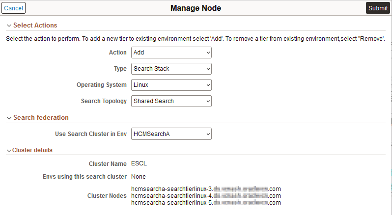

Use the Manage Node action from the second environment to configure it to share the search cluster on the first environment.
Configuring an Environment to Share a Search Cluster
Create topology for an environment with database tier and middle tier. Do not include a search node.
Create an environment template and provision the environment.
Click the Related Actions button for the environment and select Manage Node.
Select Add from the Action drop-down list.
Select Search Stack from the Type drop-down list.
Select Linux from the Operating System drop-down list.
Select Shared Search from the Search Topology drop-down list.
Note: This option is available only when there is at least one environment in Cloud Manager that has a search cluster.
From the Use Search Cluster in Env drop-down list, select the environment that owns the search cluster.
This example illustrates the Add Node page for an environment with a search cluster.
The Cluster details area displays:
Cluster name
Environments using the search cluster — Lists the environments that share the search cluster.
If no other environments share the search cluster, this displays None.
Cluster Nodes — Lists the FQDN for all search nodes in the cluster.
Click Submit.
Follow the progress on the Provision Task Status page.

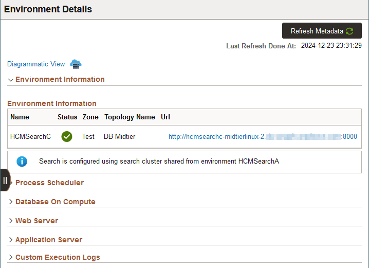

After the sharing process is complete, the sharing status is displayed on the Environment Details page.
This example illustrates the Environment Details page after sharing a search cluster.

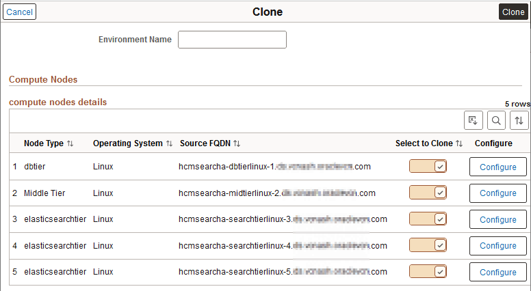

Clone an environment with a search cluster.
Import an environment with a search cluster.

The PeopleSoft search instance configuration is updated with the information about the removed node.
Sign in to PIA for the environment and update the number of replicas.
To set the number of replicas, see the section Provisioning an Environment with a Search Cluster.

When you clone an environment with a search cluster, a new search cluster is formed.
When you clone an environment with an associated search cluster, you must clone all of the search nodes in the cluster or none of them. You cannot select a subset of search nodes. On the Clone page, ensure that Select to Clone is selected for all the search nodes.
The data in the cloned search cluster will be an exact replica of that in the original search cluster. The name of the search cluster on the cloned environment will be the same as that of the source environment.
When you clone an environment that shares a search cluster (owned by another environment), the cloned environment does not inherit the sharing.
This example illustrates the Clone page with a search cluster.
See Cloning Environment.
