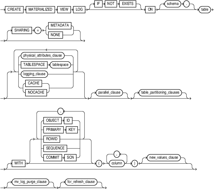

構文
logging_clause::=
parallel_clause::=
new_values_clause::=
mv_log_purge_clause::=
for_refresh_clause::=
