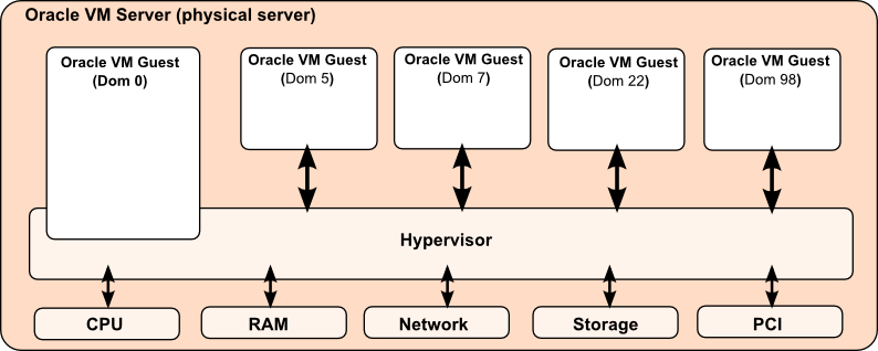

The hypervisor present on each Oracle VM Server is an extremely small-footprint virtual machine manager and scheduler. It is designed so that it is the only fully privileged entity in the system. It controls only the most basic resources of the system, including CPU and memory usage, privilege checks, and hardware interrupts.
On SPARC systems, the SPARC hypervisor is built into the SPARC firmware and is generally referred to as the Logical Domains Manager. If Oracle VM Server for SPARC has not been installed, the default operating system runs on top of the hypervisor transparently. When Oracle VM Server for SPARC is installed, the default operating system becomes the primary domain and tools are provided for the primary domain to manage how resources and hardware are allocated via the hypervisor to other domains.
As with the Xen hypervisor, each virtual machine is securely executed on a single computer and runs its own guest Oracle Solaris operating system. The SPARC hypervisor provides a broader range of virtualization features than the Xen hypervisor, due to the nature and design of SPARC hardware.
Oracle VM makes use of Xen technology, when running on x86 servers, taking advantage of the Xen hypervisor. The Xen hypervisor is a small, lightweight bare metal hypervisor for x86-compatible computers. The Xen hypervisor securely executes multiple virtual machines on one host computer. Each virtual machine runs in its own domain and has its own guest operating system with almost native performance. A primary management domain, called dom0, also runs as a guest on top of the hypervisor. See Section 2.2.2, “What are Domains?” for more information on domains. The Xen hypervisor was originally created by researchers at Cambridge University, and derived from work done on the Linux kernel.
The terms "domain", "guest" and "virtual machine" are often used interchangeably, but they have subtle differences. A domain is a configurable set of resources, including memory, virtual CPUs, network devices and disk devices, in which virtual machines run. A domain or virtual machine is granted virtual resources and can be started, stopped and restarted independently of other domains or the host server itself. A guest is a virtualized operating system running within a domain. Multiple guests can run on the same Oracle VM Server, each within its own domain.
Most of the responsibility of hardware detection in an Oracle VM Server environment is passed to the management domain, referred to as domain zero (or dom0). On x86-based servers, the dom0 kernel is actually a small-footprint Linux kernel with support for a broad array of devices and file systems. In Oracle VM Server, the dom0 is tasked with providing a view of the system hardware available to the hypervisor. It also allows you to interact directly with the hypervisor to control access to resources as well as performing various tasks such as creating, destroying and controlling guest operating systems, and presenting those guests with a set of common virtual hardware. Other domains never interact with dom0 directly. Their requirements are handled by the hypervisor itself. Dom0 only provides a means to administer the hypervisor.
On SPARC-based servers, the management domain, usually referred to as the primary service domain or control domain, is created when the Logical Domains Manager is installed. If installed on an existing server that is not already configured for logical domains, the current Operating System automatically gets promoted to primary domain status. The primary domain runs an Oracle Solaris kernel and is responsible for the creation and management of all other domains. It is also responsible for providing access to virtualized hardware resources.
