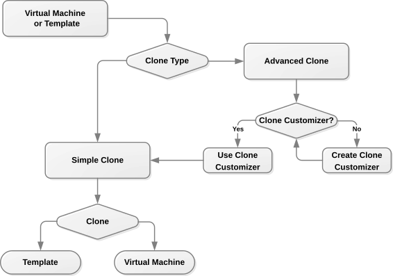

Figure Figure 7.1, “Cloning a virtual machine or template” shows the process of creating a clone of a virtual machine or template.
Figure 7.1 Cloning a virtual machine or template
This figure shows the process of creating a clone of a virtual machine or template.
