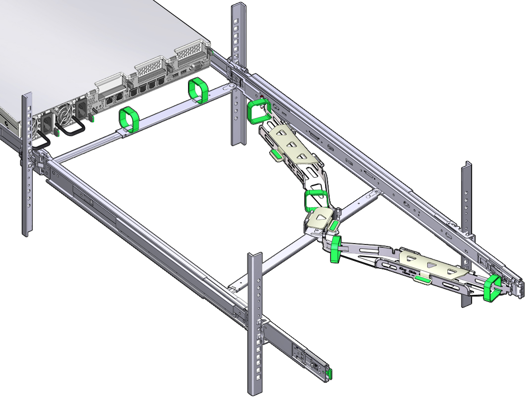

Unpack the CMA, which contains the following components.
1
Connector A
2
Front slide bar
3
Velcro straps (6)
4
Connector B
5
Connector C
6
Connector D
7
Slide-rail latching bracket (used with connector
D)
8
back slide bar
9
Server flat cable covers
10
Server round cable covers
Ensure that you install the
flat
cable covers for your server on the CMA.
Ensure that the six Velcro straps are threaded into the CMA.

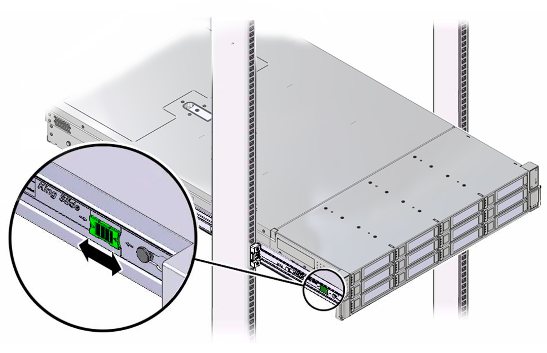

To make it easier to install the CMA, extend the server approximately 13
cm (5 inches) out of the front of the rack.

To install CMA connector A into the left slide-rail:
Insert CMA connector A into the front slot on the left slide-rail
until it locks into place with an audible click [frames 1 and
2].
The connector A tab (callout 1) goes into the slide-rail front
slot (callout 2).
Gently tug on the left side of the front slide bar to verify that
connector A is properly seated.
1
Connector A tab
2
Left slide-rail front slot
To install CMA connector B into the right slide-rail:
Insert CMA connector B into the front slot on the right slide-rail
until it locks into place with an audible click [frames 1 and 2].
The connector B tab (callout 1) goes into the slide-rail front
slot (callout 2).
Gently tug on the right side of the front slide bar to verify that
connector B is properly seated.
1
Connector B tab
2
Right slide-rail front slot
To install CMA connector C into the right slide-rail:
Align connector C with the slide-rail so that the locking spring
(callout 1) is positioned inside (server side) of the right
slide-rail [frame 1].
1
Connector C locking spring
Insert connector C into the right slide-rail until it locks into
place with an audible click [frames 2 and 3].
Gently tug on the right side of the CMA back slide bar to verify
that connector C is properly seated.
To prepare CMA connector D for installation, remove the tape that secures
the slide-rail latching bracket to connector D, and ensure that the latching
bracket is properly aligned with connector D [frames 1 and 2].
Note -
The CMA is shipped with the slide-rail latching bracket taped to
connector D. You must remove the tape before you install this connector.
To install CMA connector D into the left slide-rail:
While holding the slide-rail latching bracket in place, insert
connector D and its associated slide-rail latching bracket into the
left slide-rail until connector D locks into place with an audible
Note -
When inserting connector D into the slide-rail, the preferred
and easier method is to install connector D and the latching
bracket as one assembly into the slide-rail.
Gently tug on the left side of the CMA back slide bar to verify
that connector D is properly seated.
Note -
The slide-rail latching bracket has a green release tab. This
tab is used to release and remove the latching bracket so that
you can remove connector D.
Gently tug on the four CMA connection points to ensure that the CMA
connectors are fully seated before you allow the CMA to hang by its own
weight.
To verify that the slide-rails and the CMA are operating properly before
routing cables through the CMA:
Ensure that the rack anti-tilt bar is extended to prevent the rack
from tipping forward when the server is extended.
 | Caution -
To reduce the risk of personal injury, stabilize the rack
cabinet and extend the anti-tilt bar before extending the server
from the rack.
For instructions to stabilize the rack, see Stabilize the Rack.
Slowly pull the server out of the rack until the slide-rails reach
their stops.
Inspect the attached cables for any binding or kinks.
Verify that the CMA extends fully with the slide-rails.
To return the server to the rack:
Simultaneously pull and hold the two green release tabs (one on
each side of the server) toward the front of the server while you
push the server into the rack. As you push the server into the rack,
verify that the CMA retracts without binding.
To pull the green release tabs, place your finger in the center of
each tab, not on the end, and apply pressure as you pull the tab
toward the front of the server.
Continue pushing the server into the rack until the slide-rail
locks (on the front of the server) engage the slide-rail
assemblies.
You hear an audible click when the server is in the normal rack
position.

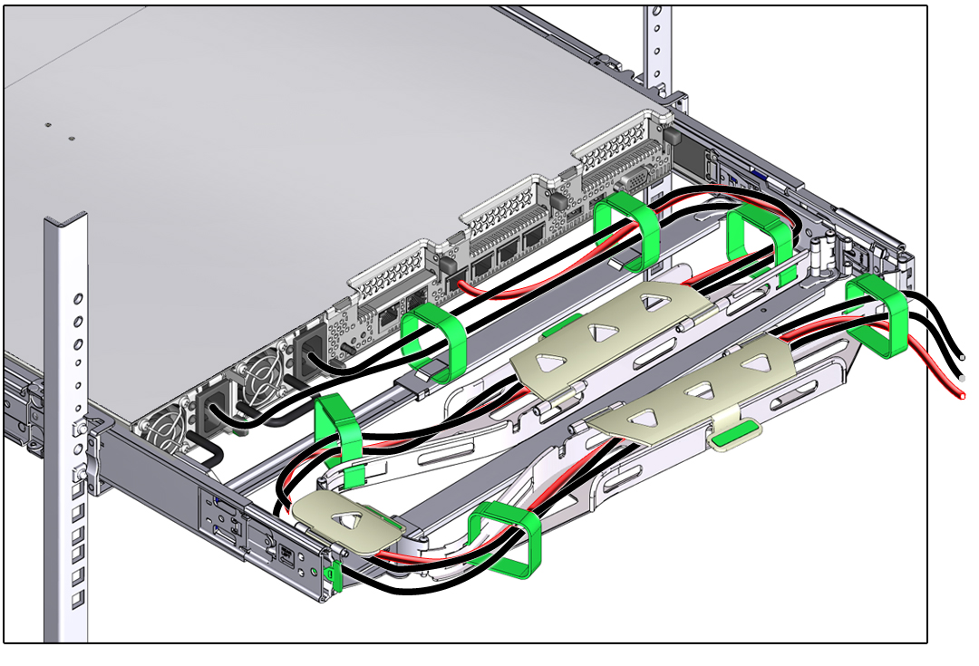

Connect cables to the server, as required.
Instructions for connecting the server cables are provided in Connecting Cables and Applying Power.
Open the CMA cable covers, route the server cables through the CMA cable
troughs (in the order specified below), close the cable covers, and secure
the cables with the six Velcro straps.
First through the front-most cable trough.
Then through the small cable trough.
Then through the back-most cable trough.
 | Caution -
When securing the cables with the Velcro straps located on the
front slide bar, ensure that the Velcro straps do not wrap
around the bottom of the slide bar. Otherwise, expansion and
contraction of the slide bar might be hindered when the server
is extended from the rack and returned to the rack.
Ensure that the secured cables do not extend above the top or below the
bottom of the server to which they are attached. Otherwise, the cables might
snag on other equipment installed in the rack when the server is extended
from the rack or returned to the rack.
If necessary, bundle the cables with additional Velcro straps to ensure
that they stay clear of other equipment. If you need to install additional
Velcro straps, wrap the straps around the cables only, not around any of the
CMA components. Otherwise, expansion and contraction of the CMA slide bars
might be hindered when the server is extended from the rack and returned to
the rack.
