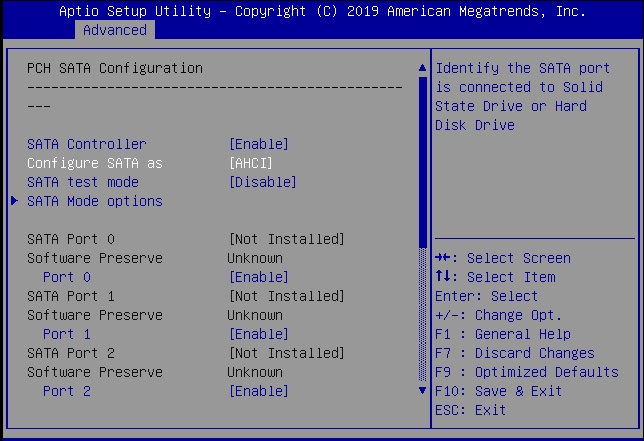

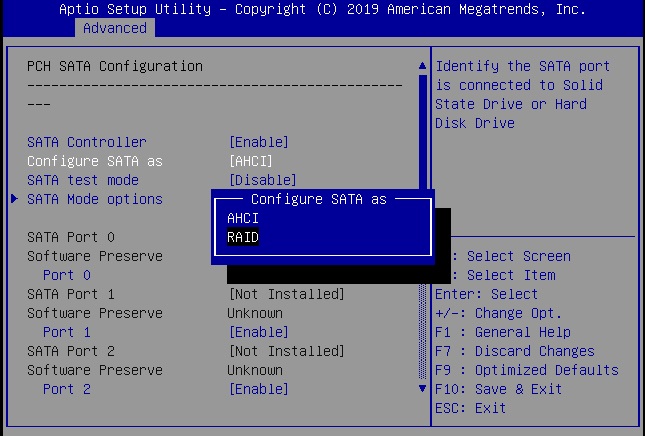

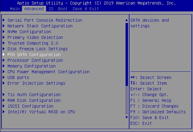

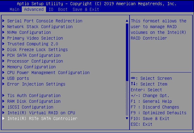

The power-on self-test (POST) sequence begins. The system boots to the BIOS Setup Utility.

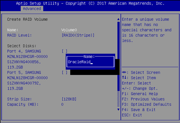

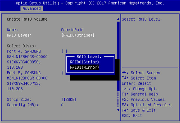

You can assign a name to the RAID volume.

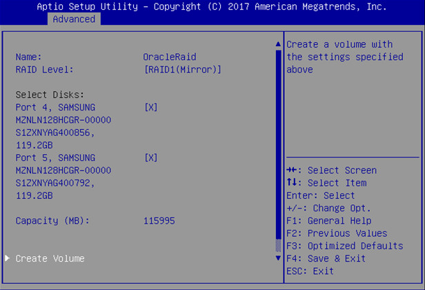

This completes the RAID configuration. You can now install an operating system on the volume that you created.
