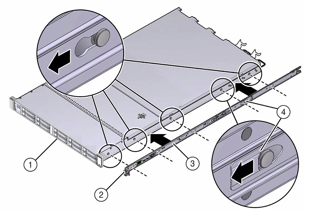

To install the mounting brackets on the sides of the server:
Position a mounting bracket against the chassis so that the slide-rail
lock is at the server front, and the five keyhole openings on the mounting
bracket are aligned with the five locating pins on the side of the
chassis.
1
Chassis front
2
Slide-rail lock
3
Mounting bracket
4
Mounting bracket clip
When the heads of the five chassis locating pins protrude through the five
keyhole openings in the mounting bracket, pull the mounting bracket toward
the front of the chassis until the mounting bracket clip locks into place
with an audible click.
Verify that the back locating pin is engaged with the mounting bracket
clip.
Repeat Step 1 through Step 3 to install the other mounting bracket on the
other side of the server.
