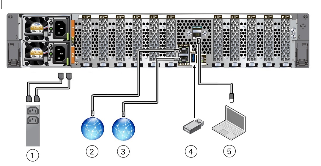

X8-2L Back Panel Connectors and Ports
The following figure shows the locations of cable connectors and ports on the back of
Oracle Server X8-2L and the cables and devices that you connect to them.
1
Power supply 0 input power
Power supply 1 input power
The server has two power supply connectors, one for each power
supply. Power supply 0 input power and Power supply 1 input power
both connect to a rack power distribution unit (PDU).
Do not attach power cables to the power supplies until you have
finished connecting the data cables to the server. The server goes
into Standby power mode, and the Oracle ILOM service processor
initializes when the AC power cables are connected to the power
source. System messages might be lost after 60 seconds if the server
is not connected to a terminal, PC, or workstation.
Note -
Oracle ILOM will signal a fault on any installed power supply
that is not connected to an AC power source, since it might
indicate a loss of redundancy.
2
Network management port (NET MGT)
The service processor NET MGT port is the optional connection to
the Oracle ILOM service processor. The service processor NET MGT
port uses an RJ-45 cable for a 10/100/1000BASE-T connection. See
NET MGT Port.
The NET MGT port is configured by default to use Dynamic Host
Configuration Protocol (DHCP). To set a static IP address, see
Modifying Network Settings.
3
Ethernet port (NET 0)
The Ethernet port enables you to connect the system to the
network. The Ethernet port uses an RJ-45 cable for a
10/100/1000BASE-T connection. See Ethernet Ports.
4
USB port
The USB port supports hot-plug insertion and removal. You can
connect and disconnect a USB cable or a peripheral device while the
server is running without affecting server operations. See USB Port.
5
Serial management port (SER MGT)
The service processor SER MGT port uses an RJ-45 cable and
terminal (or emulator) to provide access to the Oracle ILOM
command-line interface (CLI). Using Oracle ILOM, you can configure
it to connect to the system console. See SER MGT Ports.
Note -
This port does not support network connections.
