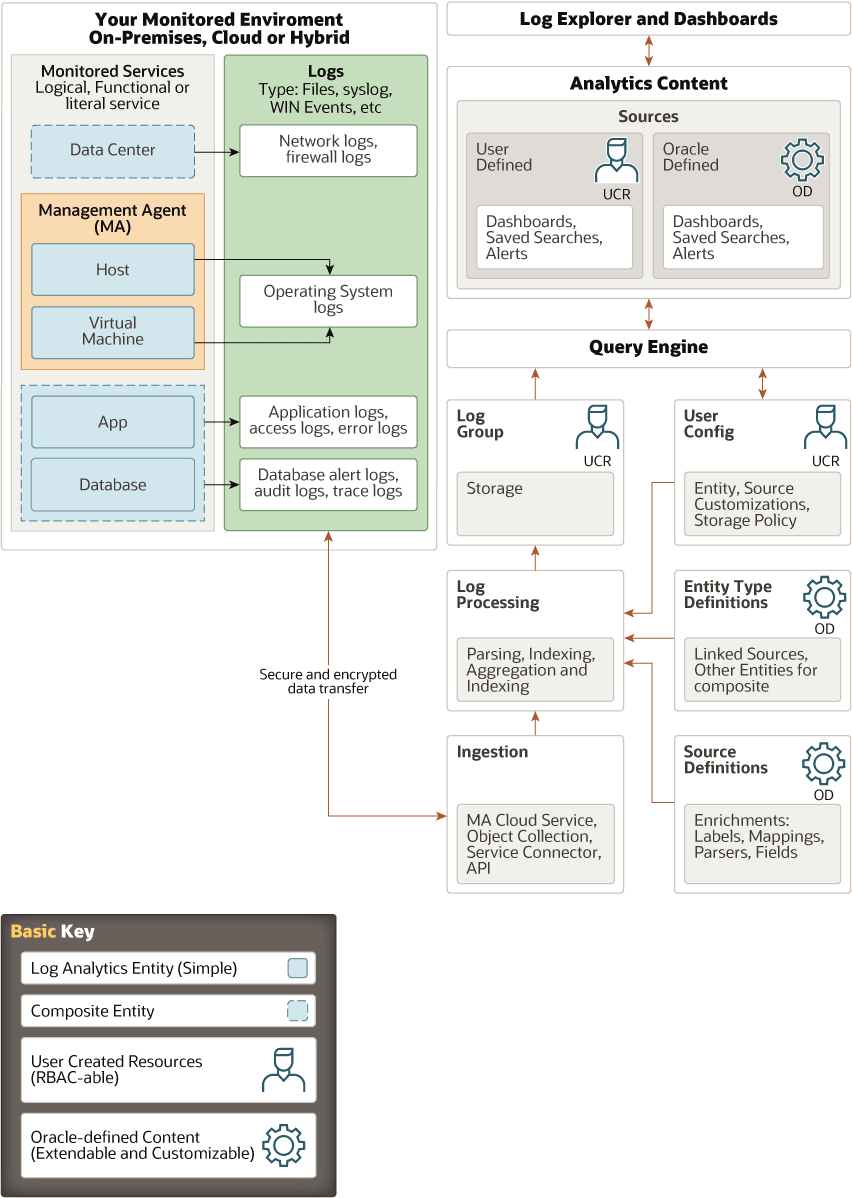

Architecture of Logging Analytics
Here's the high level architecture of Oracle Logging Analytics service:
![High level architecture of Logging Analytics High level architecture of Logging Analytics](img/work_flow.png)
