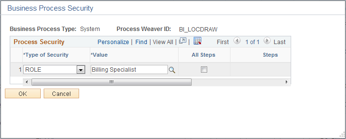

Business Process Security Page
Use the Business Process Security page (BPW_PRCDEFN_SEC) to define and modify security access at the process definition level. Only users who have access to the first step in the business process definition have permission to create a business process run control.
Navigation:
Set Up Financials/Supply Chain, and then Common Definitions, and then Business Process Weaver, and then Business Process Definition
Click the Security link on the Business Process Definition page.
This example illustrates the fields and controls on the Business Process Security page. You can find definitions for the fields and controls later on this page.
Field or Control Description
Type of Security
Select from these options:
  • Role: Identify access by role.
  • User: Identify access by user.
Value
Enter a role or user ID, depending on the selected type of security.
All Steps
Select this check box to indicate that the user or role has access to all of the business process steps in the process definition.
Steps and Select
Click the Select lookup icon to select from available steps in the process definition. The step descriptions appear in the Steps field.
