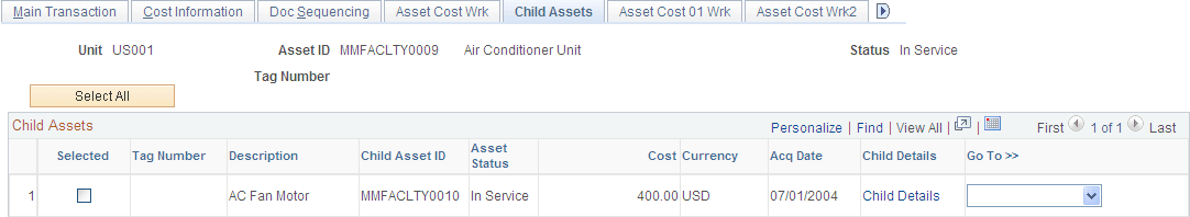

Child Assets Page
CHILD_ASSETS
Select child assets to include in the transfer or recategorization that you have initiated against the parent assets.

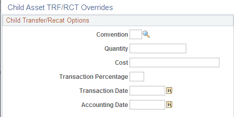

Child Asset TRF/RCT Overrides Page
AM_PARCHD_TRF_RCT
Specify transaction overrides for a specific child asset. You can specify specific convention, quantity, cost, transaction percentage, transaction date and accounting date for the child asset on this page.

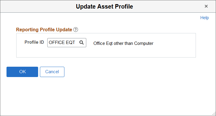

Update Asset Profile Page
ASSET_PROFILE_SEC
Enter a new asset reporting profile ID when you recategorize an asset.

  • Select some, none, or all child assets to include in the transaction that you are performing. The Child Assets page appears only when the asset you are transacting against is a parent asset and the transaction type is a transfer. A separate Application Engine process is provided for transferring parent-child assets between business units.
    Adjustments to parents do not automatically filter down to the child assets; therefore, the Child Asset page does not appear for adjustments. Instead, add another child asset. A reminder message will appear stating that child assets are associated with the parent asset that you are adjusting.

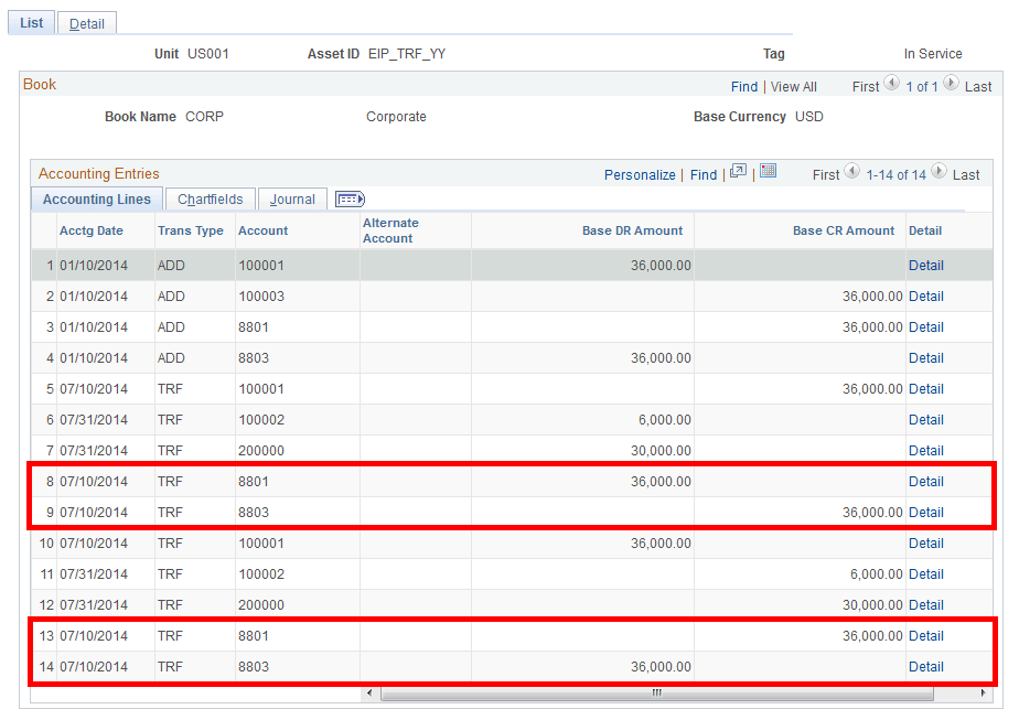

The following is an example of generated Federal fund transfer accounting entries as viewed from the Review Financial Entries page:
Example of generated Federal fund transfer accounting entries
Review Financial Entries page - Generated Fed Fund Trnsfr Acct Entries

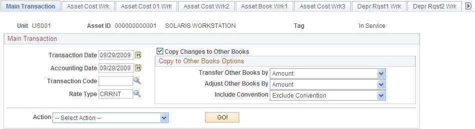

Main Transaction Page
Use the Main Transaction page (ASSET_COST_01) to identify the cost/adjust/transfer transaction that you want to perform.
Navigation:
Asset Management, and then Asset Transactions, and then Financial Transactions, and then Cost Adjust/Transfer Asset, and then Main Transaction
This example illustrates the fields and controls on the Main Transaction page. You can find definitions for the fields and controls later on this page.
Field or Control Description
Transaction Date and Accounting Date
Displays the current date or the dates that are specified as operator defaults. As a rule, transactions are entered in PeopleSoft Asset Management some time after they have occurred. Any difference between accounting and transaction dates will affect depreciation as well as posting.
See Adding and Maintaining Asset Information.
Transaction Code
(Optional) Select a code to help identify which accounting entry template to use for this transaction.
Rate Type
Enter the currency exchange rate type to use for this transaction.
Copy Changes to Other Books
Select to copy the changes that you make to other books.
Transfer Other Books by
Select to transfer the changes that you make to other books by Amount or Percent.
Adjust Other Books by
Select to adjust the other books by Amount or Percent.
Select Percent to transfer a percentage of the amount from subsequent books. For example, suppose you have an asset with two books, Corporate and Federal. The cost amount for Corporate is 5000.00 USD and is 4000.00 USD for Federal.
If you transfer 2500.00 USD from the Corporate book, select Copy Changes to Other Books, and then specify the Percent option. 2500.00 USD will be transferred from the Corporate book and 2000.00 USD will be transferred from the Federal book.
If you select Amount, a transfer of 2500.00 USD from both books will occur.
If you have a multicurrency business unit, the Amount option will be overridden by Percent when you transfer or recategorize an asset.
Note: If you do not select the Copy Changes to Other Books option, when the book that you are changing is associated with a ledger group that contains multiple ledgers, and the Keep Ledgers In Synccheck box is selected for the ledger group, changes will be copied to other books that associated with the same ledger.
Include Convention
The options are to Exclude or Include a depreciation convention. The depreciation convention automatically displays AM (actual month) for all transactions (except for Adjustments, which invokes the convention specifically defined for adjustments.) If you choose to have the convention included, the convention will be copied to all books. If you choose to have the convention excluded, the convention will not be copied to all books. You can override each book separately at the transaction level also.
Action
Select the financial transaction to be performed. Select an action and click the GO! button:

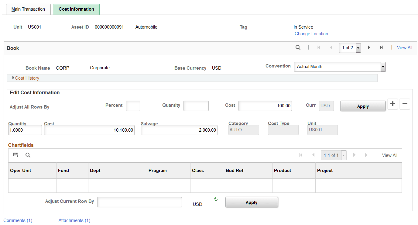

Cost Information Page
Use the Cost Information page (ASSET_COST_01A) to enter or adjust cost information that is required by the transaction that you initiated from the Main Transaction page.
Navigation:
Click the GO! button on the Main Transaction page.
This example illustrates the fields and controls on the Cost Information page. You can find definitions for the fields and controls later on this page.
The Cost Information page displays different fields and value options depending upon the action that you select before clicking the GO! button: addition, adjustment, recategorization, revaluation, or transfer activities.
If you want to perform multiple transactions, complete one transaction, and then save and reenter the page to begin the next transaction. Doing so preserves the audit trail for each transaction.
Transaction currency appears by default from the asset book base currency. Each line can reflect a different transaction currency, depending on the transaction. Balances are displayed in the base currency after the transaction currency is converted to the base currency.
Click to access the Update Asset Profile Page and synchronize the reporting asset profile with the new asset category when you recategorize an asset.
An update to the reporting asset profile ID alone does not change the asset book information or category. Profile updates after asset addition are for reporting purposes only.
This field is only visible when you select Recategorize from the Action field on the Main Transaction page.
See Asset Lifecycle Management Fundamentals: Updating Asset Reporting Profile After Asset Recategorization

Edit Cost Information
Add new cost rows in the Edit Cost Informationgroup box.
Cost, Percent, and Quantity
Enter as necessary, and enter additions and adjustments for any appropriate ChartFields.
Adjusting Total Cost or Quantity
You can adjust the total cost of an asset by either a percentage of its original cost or by a specific cost amount.
Adjust All Rows By
Enter the appropriate percentage or amount in the appropriate fields: Percent, Quantity, and Cost. The default is a positive adjustment. To make a negative adjustment, enter a negative percentage or amount. In a transaction, you can adjust the cost either by percent or cost, but not both.
You can adjust the total quantity of an asset by entering the Quantity adjustment. The default is a positive adjustment. If you want to make a negative adjustment, you must enter a negative quantity.
Apply
Click to prorate the adjustment and add it to each cost row in cases of multi-ChartField asset. If the asset has one ChartField combination, the cost is added to the total cost. The system automatically calculates and displays the adjusted total cost. If the cost that is entered is in a different currency than the base currency of your book, the cost is converted to the base currency before the cost rows are adjusted.
Note: Changes are applied only to the current book unless you select the Copy Changes to All Books check box on the Main Transaction page. If you select this option, your changes will be visible after you save the page and then restart it.
Note: Currency for Adjust by Percent is the same as the base currency of the book. However, Currency for Adjust by Cost can be any valid value.
Adjusting Cost or Quantity by Cost Row
Cost and Quantity
To adjust the cost or quantity for a particular cost row, enter the new field values directly into the cost row. You can adjust an asset's cost for individual cost rows by entering the new cost into the Cost field for each cost row that you'd like to change. To adjust the quantity for individual cost rows, enter the new quantity into the cost rows, not the number of units by which quantity will increase or decrease.
For example, if the quantity should be adjusted from 1 to 2, enter 2. This changes only the quantity, not the cost.
Note: To establish an audit trail, you should change cost information one field at a time. For example, if you need to change the department and adjust the cost, enter the new department and save your change, and then go back and adjust the cost.
Apply
Click to apply the adjustment to each cost row. The system automatically calculates and displays the adjusted total quantity.

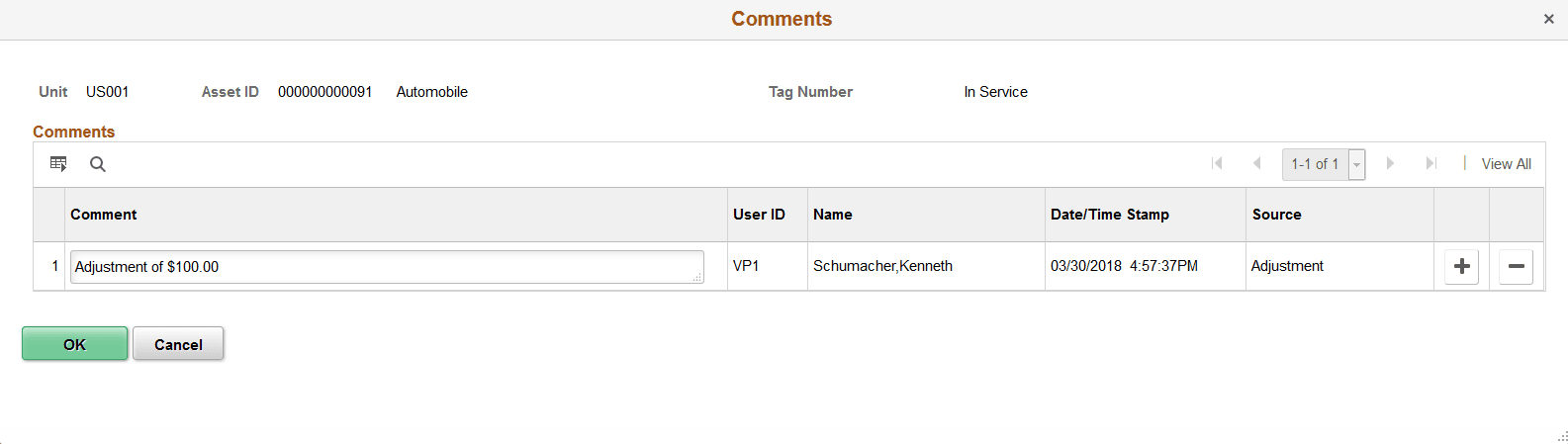

Adding and Viewing Comments
Click the Comments link to access the Cost Information - Comments page (AM_COMMENTS_SEC) and view or add relevant supporting comments to an asset transaction.
This example illustrates the fields and controls on the Cost Information - Comments page.
Comment
Enter comments for an asset.
User ID, Name and Date/Time Stamp
Displays the user ID, name, and date/time stamp related to the user who added the comment.
Source
Displays the transaction source for the asset, such as adjustment, transfer, and so forth.

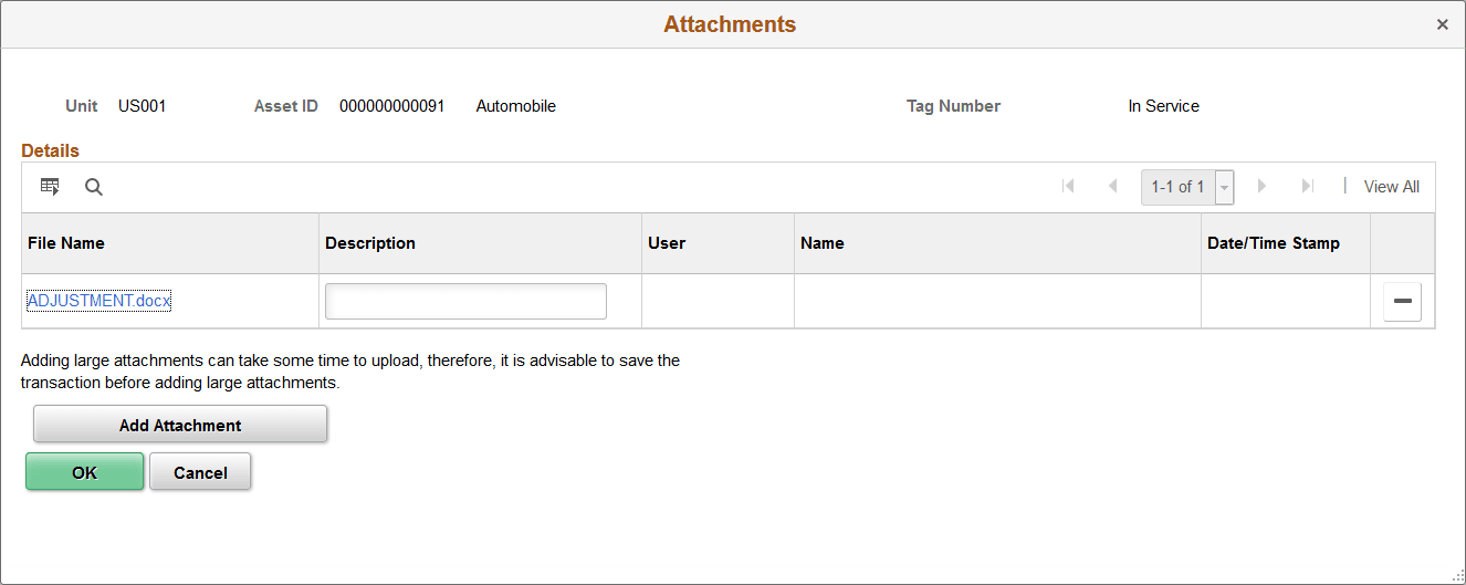

Adding and Viewing Attachments
Click the Attachments link to access the Cost Information - Attachments page (AM_ADD_ATTACH_SEC) and view or add relevant supporting documents to an asset transaction.
This example illustrates the fields and controls on the Cost Information - Attachments page.
Add Attachment
Click this button to attach files as supporting documentation for an asset. Supply a description of the file or files that you attach.
File Name
Displays the attached file. Click the file-link to access the file.
Description
Displays a description of the file attachment when one was provided by the user.
User, Name, and Date/Time Stamp
Displays the user ID, name, and date/time stamp related to the user who added the attachment.

Full Transfers – Edit Cost Information
A full transfer requires you to transfer all units or the total cost of the asset.
Oper Unit (operating unit), Dept (department), Program, Product, and Project (and any other delivered or customized Chartfield)
Enter the new values into the appropriate fields.
Partial Transfers – Edit Cost Information
Partial transfers are useful when you want to assign an asset's cost and depreciation to two or more sets of ChartFields. To partially transfer an asset, you need to perform a separate transfer for each set of ChartFields.
Oper Unit (operating unit), Dept (department), Project, or Product (and any other delivered or customized Chartfield)
For each transfer, select the appropriate ChartFields, and enter quantity and amount in the Edit Cost Information group box.
For example, suppose department 43000 has two automobiles, worth a total of 60,000 JPY. You plan to transfer one car from department 43000 to 12000, and the other from department 43000 to 14000. Because the cost of the assets will eventually be allocated to two separate sets of ChartFields, you'll need to perform two separate transfers. Each transfer will move 30,000 JPY out of department 43000 and into departments 12000 and 14000.
Retroactive Transfers
You may want to transfer assets retroactively if they were transferred during a prior accounting period, but are not yet entered in PeopleSoft Asset Management. To do this, enter the transaction and accounting dates on the Main Transaction page and enter the appropriate cost information in the Edit Cost Information group box. The system will create correcting entries that back out depreciation from the original department for the period between the transaction date and the accounting date. Prior period depreciation for that same period will be posted for the new department.
Recategorizing Assets – Edit Cost Information
You may want to recategorize assets either because you entered the incorrect category or cost type, or because you have created a new category or cost type and want to transfer existing assets to the new reclassification.
Category and Cost Type
Change the values as needed. Recategorizing an asset affects depreciation.

Child Assets Page
Use the Child Assets page (CHILD_ASSETS) to select child assets to include in the transfer or recategorization that you have initiated against the parent assets.
Navigation:
Asset Management, and then Asset Transactions, and then Financial Transactions, and then Cost Adjust/Transfer Asset, and then Child Assets
The Child Assets page appears for child assets when you select the Transfer or the Recategorize actions on the Main Transaction page.
This example illustrates the fields and controls on the Child Assets page. You can find definitions for the fields and controls later on this page.
Child Assets page
Parent assets that are created on the Parent Asset page (parent-only assets) do not have cost or basic information. They cannot be viewed in the Parent-Child Basic Information component, nor can they be viewed or transacted against in the Asset Cost/Adjust Transfers component; the Asset Retirements component; or the Parent-Child NBV component. If you want to use a parent asset as a reporting umbrella only and access these pages to manipulate child assets in mass, you should create a zero cost parent asset instead of a parent only asset. Also, to transact against parent and child assets at once, parent and child must share the same asset profile.
Select All
Click Select All to include all child assets with the parent in the transaction that you have initiated.
To include some child assets, select the Selected check box on the specific rows.
Include Parent Asset
Select to include the parent asset in this transaction.
Advanced Txn Details (advanced transaction details)
Click this link to access the Parent Asset Adv Txn options page. Specify transaction overrides for all child assets at once. For example, you would use this page to specify that only 50 percent of the cost of all child assets be transferred between departments, while the parent asset is fully transferred. Select to apply as full transaction, actual percentage, or transaction amount.
See Parent Asset Advanced Transaction Details Page.
Only child assets available for transfer based on the specified accounting date can be selected. The system compares the last accounting dates for the child assets as specified on the Book table with the accounting date of the current transaction to make this determination.
Use the Child Asset TRF/RCT Overrides page (AM_PARCHD_TRF_RCT) to specify transaction overrides for a specific child asset.
Navigation:
Click Child Details on the Asset Cost/Adjust Transfer Child Assets page.
This example illustrates the fields and controls on the Child Asset TRF/RCT Overrides page. You can find definitions for the fields and controls later on this page.
Convention
Select a depreciation convention.
Quantity or Cost
Enter the quantity or cost to use in this transaction for the child asset. For example, if you were transferring all costs for the parent from one department to another, but wanted to transfer only 500 USD for the child asset, you would enter 500 in Cost.
Transaction Percentage
You can specify a percentage of the child asset's cost to include by entering it in the Transaction Percentage field.
Enter a transaction date or an accounting date if you want it to differ from the dates that you entered for the parent's transaction.
Use the Update Asset Profile page (ASSET_PROFILE_SEC) to enter a new asset reporting profile ID when you recategorize an asset.
