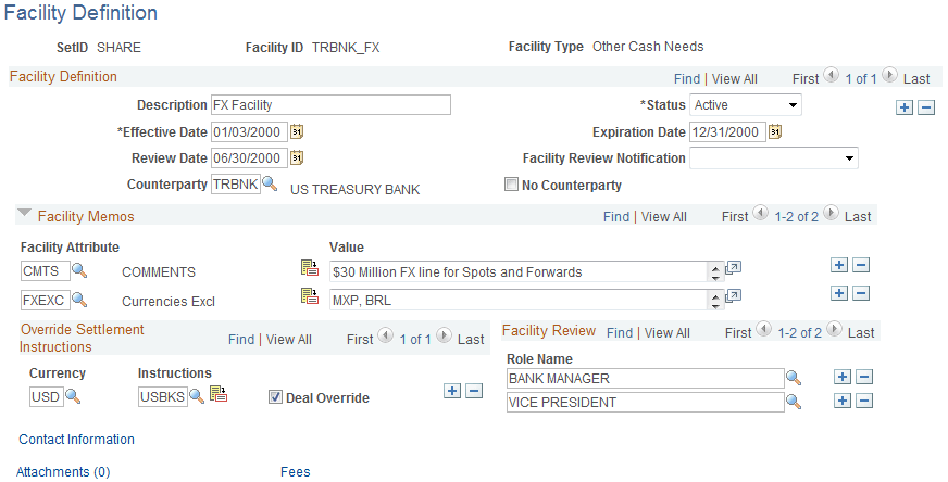

Facility Definition Page
Use the Facility Definition page (FCLTY_PNL1) to define a facility.
Navigation:
Cash Management, and then Facilities, and then Facility Definition
This example illustrates the fields and controls on the Facility Definition page. You can find definitions for the fields and controls later on this page.
Since facilities are generally associated with a particular counterparty, you may want to incorporate the counterparty code in the Facility ID field so that it's easy to distinguish between facilities.
Facility Definition
Field or Control Description
Counterparty
Select the associated counterparty. For facilities that do not have specific counterparties, such as commercial paper, select the No Counterparty check box, which disables the Counterparty field.
Review Date
Enter the date the facility will be up for review. This is the date that the role names specified in the Facility Review grid receive PeopleSoft Workflow notification.
Facility Review Notification
Choose the notification type for processing the facility review:
  • Notification Framework: Sends email and worklist notifications to the Role Names listed in the Facility Review grid, using Notification Framework.
  • Workflow: Sends notification to the Role Names that you add to the Facility Review grid, when you define and save the facility and when you run the Monitor Expiring Facilities process (TR_FCLTY_RVW).
Note: If you add a Role Name to the Facility Review grid, and save the facility definition without choosing a facility review notification type, the system defaults to Notification Framework.
Expiration Date
Enter the date the facility is scheduled to expire.
Fees
Click this link to record fees associated with the facility.
Facilities Contacts
Contact
Enter the ID number. The name, contact title, and phone number are automatically populated from the Financial Contacts page.
Contact Information
Click to view and edit the Financial Contacts page (TR_CONTACT_PNL).
Facilities Memos
Facility Attributes
The COMMENTS attribute automatically appears; enter information about the facility in the Value field.
Expand Long icon
Click the Expand Long icon to view the entire Value description.
Override Settlement Instructions
Indicate how funds should be settled for transactions using this facility.
Deal Override
Select to permit these instructions to be overridden at deal entry.
Instructions
Specify settlement instructions, which are defined on the External Accounts - Settlements Instructions page.
View Settlement Instruction icon
Click the View Settlement Instruction icon to view settlement instruction details on the Settlement Instructions page (STL_INSTR_SP). The Settlement Instructions page displays the international bank account number (IBAN) in addition to the local, domestic bank account number when the country has been set up to display the IBAN on the IBAN Formats page.
Facility Review
Role Name
Select the role name that receives PeopleSoft Workflow notification when the facility is up for review.
