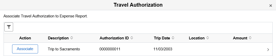

Travel Authorization Page (associate)
Use the Travel Authorization page (EX_ASSOC_TA_SCF) to associate an approved travel authorization to an existing expense report.
This example illustrates the fields and controls on the Travel Authorization Page (associate).
Travel Authorization (associate)
Field or Control Description
Associate or Detach
Select the Associate button to associate an existing and approved travel authorization to an expense report.
Select the Detach button to remove an associated travel authorization from the expense report. You can detach a travel authorization from an expense report at any time before submitting the report.
