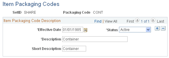

Item Packaging Codes Page
Use the Item Packaging Codes page (PACKAGING_CODE_INV) to establish standard codes for packaging.
Navigation:
Set Up Financials/Supply Chain, and then Product Related, and then Inventory, and then Item Packaging Codes
This example illustrates the fields and controls on the Item Packaging Codes page. You can find definitions for the fields and controls later on this page.
You can assign packaging codes to items during material stock request or express issue creation. The Packing component uses these codes to provide packing instructions for shipment.

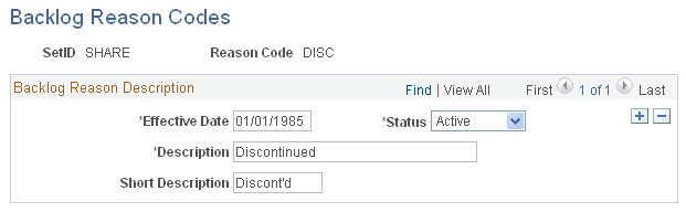

Backlog Reason Codes Page
Use the Backlog Reason Codes page (BACKLOG_RSN_INV) to establish codes representing reasons for delayed shipments.
Navigation:
Set Up Financials/Supply Chain, and then Product Related, and then Inventory, and then Backlog Reason Codes
This example illustrates the fields and controls on the Backlog Reason Codes page. You can find definitions for the fields and controls later on this page.
You can assign these codes to specific demand lines on the Shipping Backlogs page.

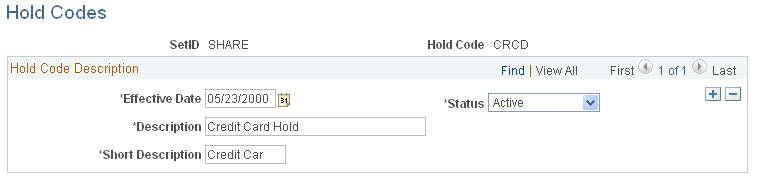

To create hold codes, use the Hold Codes component.
Use the Hold Codes page (HOLD_CD) to establish codes indicating why orders are on hold.
Navigation:
  • Set Up Financials/Supply Chain, and then Product Related, and then Inventory, and then Hold Codes IN
  • Set Up Financials/Supply Chain, and then Product Related, and then Order Management Foundation, and then Hold Codes OM
  • Set Up Financials/Supply Chain, and then Product Related, and then Receivables, and then Payments, and then AR Payment Hold Codes
This example illustrates the fields and controls on the Hold Codes page. You can find definitions for the fields and controls later on this page.
Hold Codes page
Use this page to define hold codes to be used during your business processes. Hold codes are used when:
  • Putting demand lines on hold on the Cancel/Hold Stock Request page.
  • Activating the Put on Hold option on the Inventory Definition - Business Unit Options: Shipping Options page.
  • Automatically applied by the system during Financial Sanctions Screening functions (FSS).
Using this page, you can define one or more hold codes to be used by the Financial Sanctions Screening function. For Inventory, only one hold code can be used automatically by the FSS process. Define the code here, and then add the default hold code to the Installation Options - Inventory page to enable the Screen for Denied Parties Process (SCM_FSS) to review material stock requests (MSRs) and automatically apply the hold code to any MSR that fails to pass screening. A hold code prevents an MSR from shipping. You can manually add or remove a hold code from an MSR using the Cancel/Hold Stock Requests page.
