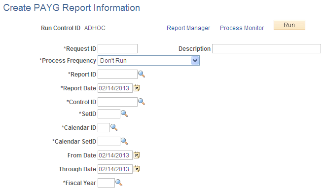

Create PAYG Report Information Page
WTHD_POST_BY_DATE
Post withholding data to the Withholding Report table.

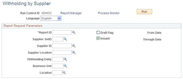

Withholding by Supplier Page
WTHD_RPT_RUN2
Run the PAYG Voluntary Agreement, PAYG Labour Hire, and PAYG No ABN Quoted reports.

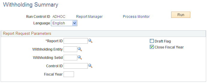

Withholding Summary Page
WTHD_RPT_RUN3
Run the PAYG Payment Summary Statement and PAYG No ABN Quoted Summary Statement reports.

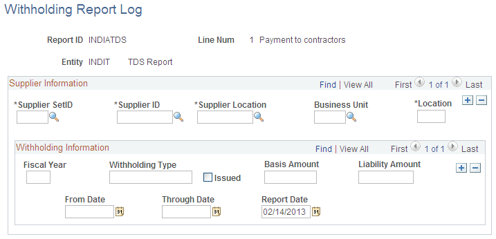

Withholding Report Log Page
WTHD_RPT_LOG_LC
Adjust or enter payment summary data manually.

Posting Withholding Report Data
The reports require aggregated data to be present in the Withholding Report table. Data is aggregated into the Withholding Report table through the Withholding Reporting process, which you can run from the Withhold Report Post page or from the Create PAYG Report Information page.
Whether you launch the Withholding Reporting process from the Withhold Report Post page or from the Create PAYG Report Information page depends on what dates you need to use to summarize withholding.
If your dates fall on the start and end of a period in a calendar, which would be the case when aggregating for year-end reporting, use the Withhold Report Post page. The from and through dates, which are hidden, are based on the start and end dates of the specified calendar period.
If you need to aggregate payments between arbitrary dates, which can be the case if you get a request for a payment summary from one of your suppliers during the fiscal year, then you can use the Create PAYG Report Information page to specify arbitrary from and through dates.
Remember that the ATO wants summary reports to exclude payments that have already been reported on previous summaries; therefore, you have to enter appropriate dates. Except for the handling of from and through dates, both methods give the same results as they pass the same parameters to the same process.
Running the PAYG Supplier Reports
PAYG reports for all three classes of PAYG suppliers are run by selecting Supplier, and then Withholdings, and then PAYG Withholding by Supplier.
At the minimum you need to specify the Report ID, the Supplier SetID and the Supplier ID on this page.
If the information you have provided uniquely identifies the data you want processed in the Withholding Report table, the system defaults the rest of the fields automatically. This would typically happen with suppliers for whom you have only set up one location and which you are only paying from one business unit.
In this case, it saves you from having to enter the Supplier Location, Business Unit and Location.
If the Draft Flag check box is deselected, the report is set to print directly into the boxes on the standard ATO form. If you select the Draft Flag, the report prints explanatory labels above each field, so that you can read the results more easily on plain paper. The system displays the from and through dates to remind you what dates the payments were summarized on.
The PAYG No ABN Quoted report, APY8043.SQR, actually prints one page per payment, rather than one report that sums up the amounts paid during the specified time. That means that you may print several pages or forms from APY8043.SQR if you have made several payments to the specified supplier during that time.

The Withholding Report Log page displays the relevant information for each of the respective types of payment summaries issued during the financial year. Payments summaries which you have issued to your Payees, and which should be included in the Payment Summary Statement, must have the Issued check box selected. For all payment summary printouts that are duplicated, deselect the Issued check box to exclude them from the Payment Summary Statement.
After you choose all the withholding report history on the Withholding Report Log page by selecting or deselecting the Issued check boxes, you can execute the PAYG Payment Summary Statement process from the Withholding Summary page. For form printing using impact printers, deselect the Draft Flag check box. For draft print mode, select the Draft Flag check box. To freeze the fiscal year so that no one can modify the data once you have reported it to the ATO, select the Close Fiscal Year check box.
Adjusting or Entering Payment Summary Data Manually
If you issued payment summaries by filling in the Voluntary Agreement and Labour Hire forms manually, you can enter that information directly in the Withholding Report Log page. This allows you to meet your reporting requirements for the PAYG Payment Summary Statement.
To add a supplier or payee, click the Add a new row button. Enter the information for the supplier in the Supplier Information group box. You can also enter any required payment summary data manually in the Withholding Information group box.
If you enter data manually, do the following:
  • Make sure that the Issued check box and amounts agree with the payment summaries you have issued to your suppliers.
  • Make sure the withholding type is correct for the supplier type. It should be either VOLAG, LABHR, or NOABN in capital letters. The system expects all suppliers to be of the same withholding type. The APY8044 process only selects the VOLAG and LABHR withholding types.
  • The entry in the Fiscal Year field determines whether it appears on the PAYG Payment Summary Statement for a given year. It is your responsibility to ensure that the fiscal year matches the from and through dates that you indicate and also the contents of your payment summaries. The system does not validate according to the Australian fiscal year calendar.
Alternatively, instead of filling in this page manually, you could run the APY8041, APY8042, or APY8043 (for No ABN Payment Summaries) reports for the same suppliers and reporting periods as you had previously filled in manually on the forms.
The system allows manual adjustments where necessary, as mentioned previously. The Payment Summary reporting processes would then update the historical data automatically and you could update the page as required.
Use the Create PAYG Report Information page (WTHD_POST_BY_DATE) to post withholding data to the Withholding Report table.
Navigation:
Suppliers, and then 1099/Global Withholding, and then Global Withholding Reports, and then Create PAYG Report Information
This example illustrates the fields and controls on the Create PAYG Report Information page. You can find definitions for the fields and controls later on this page.
Field or Control Description
Control ID
Select a business unit in the first field then select the control ID. These fields determine which business units and suppliers to include.
Calendar ID
Select the SetID of the calendar you want to use in the first field. In the second field, select the ID of the calendar you want to use.
From Date
Select the first date from which you want to generate data.
Through Date
Select the last date from which you want to generate data.
Fiscal Year
Select the fiscal year for which you want to generate data.
Use the Withholding by Supplier page (WTHD_RPT_RUN2) to run the PAYG Voluntary Agreement, PAYG Labour Hire, and PAYG No ABN Quoted reports.
Navigation:
Suppliers, and then 1099/Global Withholding, and then Global Withholding Reports, and then PAYG Withholding by Supplier, and then Withholding by Supplier
This example illustrates the fields and controls on the Withholding by Supplier page. You can find definitions for the fields and controls later on this page.
Issued
Select this check box to flag the payment to be included in the Payment Summary Statement process. Deselecting the Issued check box represents a duplicate print to be excluded from the process.
Use the Withholding Summary page (WTHD_RPT_RUN3) to run the PAYG Payment Summary Statement and PAYG No ABN Quoted Summary Statement reports.
Navigation:
Suppliers, and then 1099/Global Withholding, and then Global Withholding Reports, and then PAYG Withholding Summary, and then Withholding Summary
This example illustrates the fields and controls on the Withholding Summary page. You can find definitions for the fields and controls later on this page.
Withholding SetID
Select the SetID associated with the withholding entity for which you want to run the summary reports,
Control ID
Select the control ID. This field determines which business units and suppliers to include.
Fiscal Year
Enter the fiscal year that you want to display on the report.
Close Fiscal Year
Select this check box to freeze the fiscal year so that no one can modify the data once you have reported it to the ATO.
Use the Withholding Report Log page (WTHD_RPT_LOG_LC) to adjust or enter payment summary data manually.
Navigation:
Suppliers, and then 1099/Global Withholding, and then Global Withholding Reports, and then Update PAYG Withholding Report, and then Withholding Report Log
This example illustrates the fields and controls on the Withholding Report Log page. You can find definitions for the fields and controls later on this page.
Fiscal Year
Enter the fiscal year for which you are making entries or adjustments. The entry in this field determines whether it appears on the PAYG Payment Summary Statement for a given year. It is your responsibility to ensure that the fiscal year matches the from and through dates that you indicate and also the contents of your Payment Summaries. The system does not validate according to the Australian fiscal year calendar.
Withholding Type
Enter the type of withholding for which you are making an entry or an adjustment. Make sure the withholding type is correct for the supplier type. It should be either VOLAG, LABHR, or NOABN in capital letters. The system expects all suppliers to be of the same withholding type. The APY8044 process only selects the VOLAG and LABHR withholding types.
Issued
Select this check box to indicate that you have issued a payment summaries to the supplier.
Basis Amount
Enter the amount upon which the withholding was calculated. Make sure the amounts you enter on this page agree with the payment summaries you issued.
Liability Amount
Enter the amount of the withholding liability.
