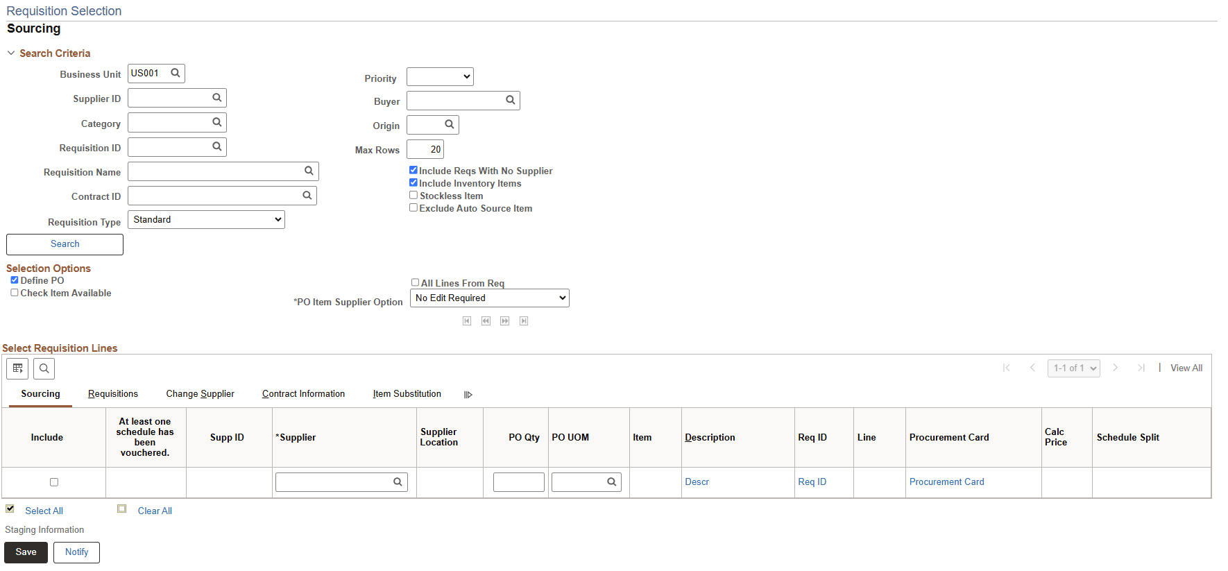

Requisition Selection - Sourcing Page
Use the Requisition Selection - Sourcing page (PO_REQ_SOURCE) to enter search criteria and source requisitions to purchase orders or inventory demand.
Navigation:
Purchasing, and then Purchase Orders, and then Stage/Source Requests, and then Requisition Selection, and then Requisition Selection - Sourcing
This example illustrates the fields and controls on the Requisition Selection - Sourcing page. You can find definitions for the fields and controls later on this page.
Search Criteria
Field or Control Description
Priority
Select a Priority: Rush, High, Medium, or Low. Based on the selected priority, search result displays the requisition lines.
Buyer
Select a buyer on which to base the search. The buyer is the person responsible for the requisition.
Supplier ID
Select a supplier.
Origin
Select the origin for the requisition. Origin codes are established on the Origin Codes page and help identify the origins of transactions.
Category
Select a category on which to base a requisition search. Requisitions that meet other search criteria and that are in the category you select appear in the search results.
Max Rows(maximum rows)
Enter the maximum number of rows that you want to display in the Select Requisition Lines grid box. These are the returned rows that match the criteria you enter.
Requisition ID
Select a requisition on which to base the search.
Include Reqs With No Supplier (include requisitions with no supplier)
Select to review requisitions with or without a suggested supplier.
Requisition Name
Select the name of the requisition. The name helps you identify the requisition as it flows through the system. If you are using PeopleSoft eProcurement, this value is carried from the eProcurement requisition to the Purchasing requisition when the requisition is created in eProcurement.
Include Inventory Items
Select to include requisition lines that would normally be sourced from PeopleSoft Inventory.
Contract ID
Select a contract ID. Only requisitions that specify the contract ID are returned.
Requisition Type
Only used with ePro requisitions. If enabled, select a Requisition Type (Standard, Bill Only, and Bill and Replace) to view the list of requisitions of the selected type.
To enable the requisition type, see PeopleSoft eProcurement: Setting Up Installation Options for Fluid eProcurement.
Stockless Item
Select to retrieve requisition lines for stockless items.
Exclude Auto Source Item (exclude automatic source item)
Select to exclude items defined as automatic sourcing items. Items are flagged for AutoSourcing on the Purchasing Attributes - Purchasing Controls page by selecting the Auto Select check box under the Misc. Controls and Options section of that page.
Search
Click to search for the requisitions that match the criteria you entered. The system populates the Select Requisition Lines grid with requisitions that match the criteria you enter. To perform another search, change the criteria and click the Search button again.

Split Line
This button becomes available after you change the quantity on a line that you want partially sourced. Click to insert a new line with the unsourced requisition quantity. You can source the remaining requisition quantity to different suppliers.
Contract Information
Use the Contract Information tab to select contracts to include in requisition sourcing.
Contract SetID
Displays the SetID to which the contract belongs.
Contract Version
Displays the contract version number. Procurement contract versions refer to the revision of the procurement contract transaction. Contract versions enable contract administrators to create and maintain multiple versions of a contract in the procurement system. To use contract versions, you must select the Use Version Control check box on the Contract and Vendor Rebate Controls page.
Contract Line Nbr(contract line number)
Displays the contract line number to which this line item belongs. Contract line numbers represent each item that is on a contract.
Category Line Number
Displays the contract category line number. Categories enable you to specify groups of items on a contract, rather than having to enter the items one at a time.
Group ID
Displays the line group ID associated with the contract line number.
Use Contract if Available
Select to apply negotiated prices for purchases and transactions against the contract. The system searches for purchase order, general, and release-to-single-PO-only contracts. Batch processing uses a different set of rules and does not automatically apply contract prices to requisitions.
See .Establishing PeopleSoft Purchasing Business Units
Item Substitution
Select the Item Substitution Tab
Item ID
This field is available for entry when the requisition line contains an ad hoc item (description only). This enables the buyer to enter an item ID, when appropriate, based on the ad hoc item description entered by the requester
Item Description
Displays the type of item
Original Substituted Item
Displays the original Item ID on a procurement transaction that is being substituted. Once an Original Substituted Item is designated for a procurement transaction, it is carried all the way through to the Receipt and cannot be changed. (This is also referred to as only ‘Original Item’ in some cases where the Item may or may not have been substituted.)
Auto item Substitution
Select to uncheck the ‘Auto Item Substitution’ box on a Requisition Line when you wish to retain the current Item ID and do not want it automatically substituted during sourcing. Additionally, you will be able to reject a Substitute Item found by Auto Item Substitution on the online Requisition.
For information on the Item Search icon See Manual Substitution Understanding Item Substitution in Procurement
Requisition Selection - Procurement Card Information Page
Use the Requisition Selection - Procurement Card Information page (CC_USE_HDR_DTL_1) to maintain procurement card information such as, selecting a procurement card as payment method if one is not already assigned, viewing the existing procurement card information, and overriding the existing procurement card.
Navigation:
Click the Procurement Card link on the Requisition Selection - Sourcing page.
Procurement Card used for payment
Card Number, Card Type, and Expiration Date
Displays the procurement card information associated with the current procurement card on the requisition.
Note: If a procurement card has not been previously assigned to the requisition then no procurement card information displays.
Override Procurement Card
Card Number
Select the card number to override the current procurement card number on the requisition or select a procurement card that you want to assign to the requisition if a procurement card was not previously assigned.
Only the valid procurement cards for the user who is making the requisition selection appear as valid procurement cards in the drop down list. This user must also have the access rights to use a procurement card on a requisition.
Card Type and Expiration Date
After you select an override procurement card these fields display the information associated with that procurement card.
Don't use Procurement Card
Select this check box if you do not want to use a procurement card as a payment method for this requisition that is being sourced to a purchase order. If you select this check box no procurement card will be associated with the purchase order.
Override Selected Requisition Supplier Page
Use the Override Selected Requisition Supplier page (PO_REQ_SUPPLIER) to update the supplier ID for all selected requisition lines on the Requisition Selection page.
Navigation:
Click the Change Supplier link on the Requisition Selection - Sourcing page.
Select a supplier to use by selecting the Change Supplier check box for the selected requisition lines on the Change Supplier tab of the Requisition Selection - Sourcing page.
Supplier, Supplier ID, and Location
Select the supplier and location you want to override the current supplier with.
OK
When you click this button, the system updates the selected requisition lines with the supplier ID and location entered here and validates the item-supplier relationship. Once saved, the selected supplier is then staged into the purchase order staging tables.
Requisition Selection - Staging Information Page
Use the Requisition Selection - Staging Information page (PO_REQ_CREATE) to view or modify a requisition before sourcing.
Navigation:
Click the Staging Information link on the Requisition Selection - Sourcing page.
Header
Header information is available for modification only if you selected Define PO on the Requisition Selection - Sourcing page. This page is only accessible if Define PO was selected on the Requisition Selection - Sourcing page. You will not be able to access this page if the line has been sourced to a blanket purchase order.
PO Date
Identifies the date to be used on the purchase order. This value can be changed if the system is assigned the purchase order date. If you are adding to an existing purchase order, the purchase order date appears by default from that purchase order.
User Assign ID
Select to source the requisition lines to the purchase order ID that you enter in the PO ID field. The purchase order must be an existing or reserved purchase order for the same supplier. If selecting an existing purchase order, only those in Initial, Pending Approval, or Approved status that have never been dispatched are available for selection.
Use Procurement Card
Click this link to access the Requisition Selection - Procurement Card Information page. Use this page to maintain the procurement card information for the requisition being staged to become a purchase order.
The procurement cards that appear for selection on this page are related to the buyer who also has the rights to use a procurement card on a purchase order. Plus, any supplier cards appear as well for the buyer and supplier and location if the supplier accepts procurement cards as a payment method.
Procurement cards will be visible here if they came over from the requisition or set as a default from the supplier. The buyer has the ability to change this card information to a card that they are authorized to use.
Line/Schedule
The line and schedule information appears by default from the requisition. If you selected Define PO, this information appears on the purchase order. If you did not select Define PO, the information listed here is passed to the appropriate sourcing process: PO Calculations or Build Inventory Demand.
Line and Sched (schedule)
If you selected Define PO, this is the purchase order line and schedule number. If you did not select Define PO, this is the line and schedule number from the requisition.
Item ID
This field is available for entry when the requisition line contains an ad hoc item (description only). This enables the buyer to enter an item ID, when appropriate, based on the ad hoc item description entered by the requester.
When the requisition line contains an item ID, this field is unavailable for entry. The buyer may use the Substitute Items functionality to enter a substitute item.
Price
The unit price for this requisition line appears by default from the requisition and is used on the purchase order if the Define PO check box is selected. If the Calculate Pricecheck box is selected on the requisition, the PO Calculations process recalculates the price.
Note: If you change the Price value for an ad hoc item and the new price exceeds tolerances defined for the requisition on the Maintain Requisitions - Requisition page under the Sourcing Controls tab, the ad hoc row is not rejected. Instead, the system recognizes that the price exceeds the defined tolerances, issues a warning, and gives you the option to accept the newly entered price or reset it to the price defined on the original requisition.
Freight Terms
This field identifies the freight terms code associated with the purchase order's schedules.
Amount
Total line amount in the displayed currency.
Distribute by
The distribution method by which you allocate the expense account distribution appears by default from the requisition. Values include Amount or Quantity.
If you select Quantity, the sum of all distribution quantities must equal the schedule quantity. Inventory items must be distributed using the quantity distribution method.
If you select Amount, the sum of all distribution amounts must equal the schedule amount (merchandise amount).
Both options enable you to distribute by percent.
Distributions
The distribution information appears by default from the requisition. If you selectedDefine PO, this information appears on the purchase order. If you did not select Define PO, the system passes this information to the appropriate sourcing processes.
PO Qty (purchase order quantity)
Identifies the quantity on the distribution. You can change the default distribution quantity. If the distribution method is Amount, the purchase order quantity is not available for entry.
Amount
Identifies the distribution amount. You can change the default distribution amount here. If the distribution method is Quantity, the amount is not available for entry.
Percent
Identifies the distribution percent. You can enter the distribution percent if the distribution method was either Quantity or Amount. If you change the amount or quantity, the percent is adjusted. If you change the percent, the amount or quantity is adjusted. In either case, the total must equal 100 percent.
Location
Represents the internal destination of the distribution, which can differ from the ship to location for the schedule. For example, the ship to location for the schedule might be corporate headquarters, and the distribution location might be a particular floor's supply room.
Click the Save button to copy this information into the PeopleSoft Purchasing stage tables, where it can be picked up by the PO Calculations process and then by the Create Purchase Orders process.
PO Item Staging Page
Use the PO Item Staging page (PO_STG_RECV_INSPEC) to view or change information about the receiving process for an item selected on the Requisition Selection - Staging page.
Navigation:
Click the Receiving/Inspection Information link on the Requisition Selection - Staging Information page.
Receiving Required
Select the receiving requirement for the item. Values are:
  • Do Not Receive: If selected, accounts payable matching and receipt accrual are not applicable.
  • Receiving is Optional: If selected, accounts payable will not match receipt lines and the system will not accrue the receipt.
  • Receiving is Required: If selected, accounts payable will match receipt lines and the system will accrue the receipt.
Inspect
Select this check box if inspection is required, and specify any inspection instructions for this item using the inspection routing ID.
PO Header Staging Page
Use the PO Header Staging page (PO_HDR_STG_DTLS) to view or change information about the requisition header selected on the Requisition Selection - Staging Information page.
Navigation:
Click the Header Details link on the Requisition Selection - Staging page.
Tax Exempt Flag
Select this check box if sales tax does not apply to this transaction.
Matching Options
Match Action
Indicate whether you want PeopleSoft Payables to perform matching before payment of the voucher.
Match Rule
Select a match rule from the available options. Match rules are defined on the Match Rules page and activated on the Match Rule Control page.
Payment Terms
Payment Terms Basis Date Type
Specify the date that should be used to calculate the voucher payment terms in PeopleSoft Payables.
Process Control Option
Dispatch
Select this check box to indicate that the purchase order should be dispatched upon creation.
Method
Select a dispatch method. Values are Print, Fax, Email, EDX, or Phone.
