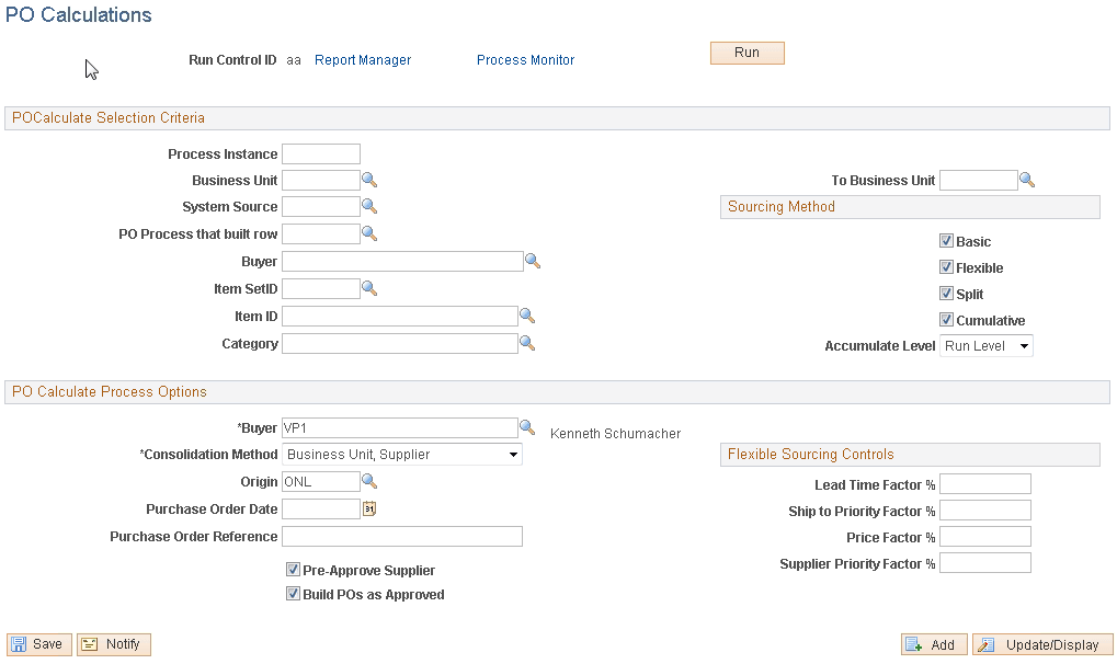

Page Used to Run the PO Calculations Process
PO Calculations Page
RUN_PO_POCALC1
Enter the selection criteria for the PO Calculations process.
Enter the run control criteria for the PO Calculations process and to run the process.

The PO Calculations Application Engine process (PO_POCALC) performs most of the processing necessary to create a purchase order. After running the PO Calculations process, you can review the results of the process and make changes using the Sourcing Workbench - Sourcing page before the purchase order is created. After you run the PO Calculations process, run the Create Purchase Orders process to create the purchase order.
If you select the Pre-Approve Supplier check box on the PO Calculations - Run Controls page, the system automatically approves the Supplier recommended by the PO Calculations process, so that you can run the PO Calculations process and the Create Purchase Order process without interruption. If you do not select the Pre-Approve Supplier check box, you must approve the Supplier manually in the Sourcing Workbench.
Use the PO Calculations page (RUN_PO_POCALC1) to enter the selection criteria for the PO Calculations process.

Purchasing, and then Purchase Orders, and then Stage/Source Requests, and then PO Calculations
This example illustrates the fields and controls on the PO Calculations page. You can find definitions for the fields and controls later on this page.
PO Calculate Selection Criteria
Selecting field values in this group box limits the selection of staged rows to those that meet the criteria selected. These fields are optional.
Sourcing Method
All sourcing methods are selected by default. The selected methods are included when you run the PO Calculations process. If you do not want to include a particular sourcing method, deselect the check box.
If you do not select any of the sourcing methods, only staged rows with a Supplier provided and the Override Suggested Supplier check box deselected are included when you run the PO Calculations process.
Field or Control Description
Accumulate Level
This is not a selection criteria for the process, but rather is used in conjunction with the cumulative sourcing method. Select a value to determine how to accumulate the percentages for cumulative split sourcing.
Select Schedule level if you want each schedule to be examined individually when finding a Supplier. With this accumulate level, the schedules are assigned to the same Supplier until that Supplier's predefined percentage is met, then they are assigned to the next Supplier until the second Supplier's predefined percentage is met, and so forth through all the available suppliers. Then it cycles back to the first Supplier. Each schedule could have a different Supplier.
Select Run if you want all schedules for that category being processed during the run to be grouped together when finding a Supplier. With the run accumulate level, all schedules for the category will be sourced from the same Supplier.
Note: The schedule accumulate level offers greater and more accurate control, but the run accumulate level offers better performance.
PO Calculate Process Options
Buyer
(Required) Select the buyer to be used on the purchase order header in the event that the PO Calculations process cannot determine the buyer.
The buyer name is carried at the line level on the requisition, so a requisition can have multiple buyers. When the PO Calculations process creates the purchase order header, it must assign a buyer name.
  • If all the staged lines that belong on one purchase order have the same buyer name, the PO Calculations process uses that name on the header.
  • If the staged lines that belong on the purchase order have different buyer names, or the process that created the staged entry did not specify a buyer name (you can force a buyer name in online requisition selection), the system uses the Supplier buyer name.
  • If the Supplier buyer name is blank, the system enters the buyer name on the purchase order header.
Consolidation Method
Determines whether purchase orders are consolidated by business unit, Supplier, and buyer or by business unit and Supplier only. The consolidation method applies only to staged rows identified for consolidation.
For example, suppose that you choose to consolidate by business unit and Supplier, then all rows with the same Supplier and business unit are grouped onto one purchase order.
Alternately, if you add buyer to the consolidation criteria, all rows that have the same buyer, Supplier, and business unit are grouped on a purchase order.
Origin
(Optional) Select an origin to be used on the purchase orders.
Purchase Order Date
Enter a date to be used on the purchase orders, for purchase orders that do not already have a date assigned. If you leave this field blank, the PO Calculations process uses the current system date.
Purchase Order Reference
(Optional) Enter a purchase order reference to be used on the purchase orders. This is a free-form field.
Select this check box to approve the Supplier that the PO Calculations process selects.
If selected, the system automatically approves the Supplier recommended by the PO Calculations process, so that you can run the PO Calculations process and the Create Purchase Order process without interruption. If you do not select the Pre-Approve Supplier check box, you must approve the Supplier manually using the Sourcing Workbench.
If you change a Supplier using the Sourcing Workbench, you must run the PO Calculations process again for the staged row to be recalculated.
Build POs as Approved (build purchase orders as approved)
Select this check box to have purchase orders created with an Approved status when you run the Create Purchase Orders process. If selected, the process examines auto approval criteria set at the business unit level. If the auto approval criteria are met, the status is set to Approved. If the auto approval criteria are not met, the status is set to Pending Approval, and the purchase order enters the workflow approval business process. If you do not select this check box, the purchase order is created with a status of Open.
Flexible Sourcing Controls
Lead Time Factor %, Ship to Priority Factor %, Price Factor %, and Supplier Priority Factor %
Used for flexible sourcing. To override the category and item settings, enter the percentage weight that you want the PO Calculations process to give the lead time, ship to, price, and Supplier factors when the application process is evaluating suppliers for flexible sourcing. The sum of all four factor fields must add up to 100 percent.
