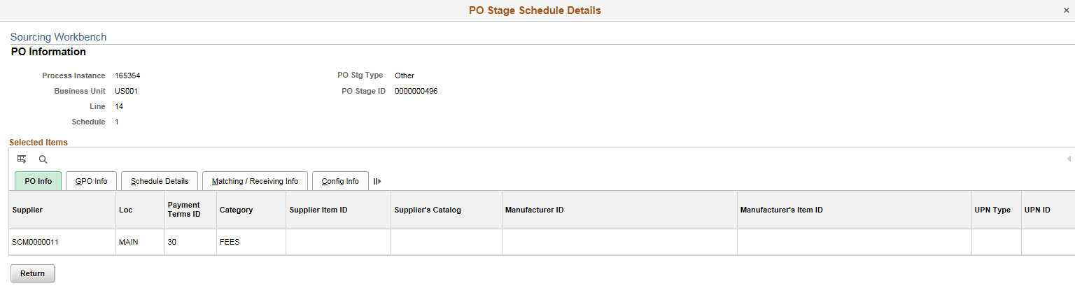

Sourcing Workbench - PO Information (purchase order information) Page
PO_STG_SCHED_DTLS
View details about the purchase order that is going to be created.

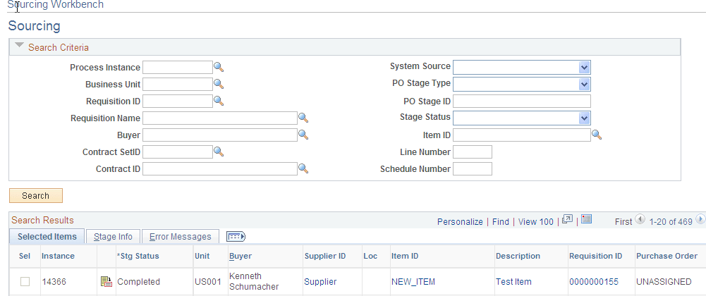

Sourcing Workbench - Sourcing Page
Use the Sourcing Workbench - Sourcing page (PO_SRC_ANALYSIS) to select sourcing criteria and view the rows of data on the PO_ITM_STG table.
Use pages to change the recommended supplier, quantities sourced to each supplier, or correct errors. Along with narrowing the search to specific criteria such as process instances, requisition IDs, purchase order ID, stages, and statuses, you can also search for specific contract SetIDs and contract IDs.
Navigation:
Purchasing, and then Purchase Orders, and then Stage/Source Requests, and then Sourcing Workbench, and then Sourcing Workbench - Sourcing
This example illustrates the fields and controls on the Sourcing Workbench — Sourcing. You can find definitions for the fields and controls later on this page.
Use this page to define the criteria that you want to use to view or update a purchase order line and its sourcing details. After defining search criteria, click the Search button to view the search results based on the criteria. The system provides the search results in the lower porting of the page and you can click on links to view vendors, items, requisition, and purchase order details. You can also select the Stage Info tab to view additional details about the staged line, including for example, the contract SetID, contract ID, and contract line if the row is associated with a contract. Finally, you select the Message tab to view messages for a row of data when its stage status is Error.

After defining selection criteria, click the Search button and the system returns the item data rows that match the criteria.
Sourcing Workbench Search Results
The system displays the search results on the Selected Item, Staged Rows, and Message tabs. Using the tabs you can link to a variety of information about the staged item. Select the Sel (select) check box to mark a specific row of data for processing. You can only select the field if the row of data is available for updating.
Along with linking to staged row details, you can use this page to purge and recycle multiple rows in a staged status. You can only perform the recycle and purge actions against those rows of data that have not been greyed out. When the staged status for a row is in a status that cannot be recycled or purged, the system provides error messages when you attempt to set the row for purging or recycling.
After making your selections and clicking the Purge or Recycle button, click Save. The system applies the changes. When you select rows, but the system does not apply an action to the rows, the system deselects the rows after you perform the action.
The system does not issue error messages for actions taken on multiple rows. Messages are only issued for single row changes.

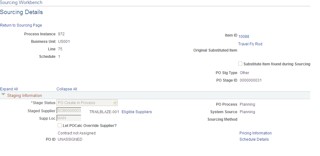

Sourcing Workbench - Sourcing Details Page
Use the Sourcing Workbench - Sourcing Details page (PO_SRC_ANLSYS_DTL) to view further details about a staged row and how to change the supplier and stage status.
Navigation:
Click the Sourcing Details button on the Sourcing Workbench - Sourcing page.
This example illustrates the fields and controls on the Sourcing Workbench - Sourcing Details page (1 of 2). You can find definitions for the fields and controls later on this page.

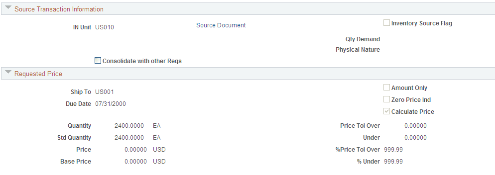

This example illustrates the fields and controls on the Sourcing Workbench - Sourcing Details page (2 of 2). You can find definitions for the fields and controls later on this page.

Staging Information
Field or Control Description
Stage Status
Select a stage status. You can change the stage status from Error to Recycle or to Reset/Purge after you have corrected the error on this row, so that the PO Calculations process can reprocess the staged row.
To recycle and purge multiple staged rows of a purchase order, click the Return to Sourcing Page link.
If the PO Calculations process fails, change the status from POCALC to Recycle as long as the process is no longer running.

Staged Supplier
Select a different supplier. This field is available for entry when the stage status is Staged, Pending (pending approval), Error, or Recycle. An item supplier relationship must exist if the Accept Any Supplier option is N (no) at the business unit or item level.
If you are using the Flexible sourcing method and have run the PO Calculations process, all eligible suppliers appear on the Eligible Suppliers page. Choose a supplier on the Eligible Suppliers page by selecting the Use This Supplier option.
To make an informed decision about the supplier selection, use the Flexible Sourcing page to view all factors involved in the selection of the recommended supplier by the PO Calculations process.
If you change the supplier for a schedule, there are other schedules on the same purchase order line, and the line is priced at the line quantity, the system issues a warning that all schedules must be priced again. If you choose to reprice the schedules, the stage status on each one changes to Recycle.
When you change the supplier, the Let POCalc Override Supplier check box is clear, to ensure that the PO Calculations process does not choose a different supplier.
Supplier Loc (supplier location)
You can enter a different supplier location under the same circumstances that you can change the supplier for this staged row.
Select to allow the PO Calculations process to override the supplier for this line. To use the supplier that you select for this line, ensure that this check box is clear.
Contract ID
Displays the contract number associated with this process instance. Click the link to view details about the contract, including its SetID, contract ID, and contract line.
Pricing Information
Click this link to access the Sourcing Workbench - Pricing Information page. The page provides details about the pricing of the item from the requisition.
See Sourcing Workbench - Pricing Information Page.
PO ID (purchase order ID)
Displays the purchase order to which this line was sourced. If the line is split sourced and multiple purchase orders are created, the Multiple link appears.
Supplier Details
Click to access the Supplier Information page where you can search for and maintain supplier details.
Eligible Suppliers
Click this link to access a secondary page with details about the supplier for this item. Included in the details are the supplier ID, whether or not its a recommended supplier, the requisition quantity and the sourcing method.
See Eligible Suppliers Page.
Schedule Details
Click this link to access the Sourcing Workbench - PO Information page where you can view details about the purchase order that is going to be created.
See Sourcing Workbench - PO Information (purchase order information) Page.

Source Transaction Information
IN Unit (inventory unit)
Appears if this transaction is created through the PO Stage Load process. This is the PeopleSoft Inventory business unit from planning or manufacturing.
Source Document
Click this link to access the transaction from which this line originated. If this line is sourced from a requisition, selecting the link accesses the requisition.
Inventory Source Flag
If this row is to be sourced from PeopleSoft Inventory rather than onto a purchase order, this check box is selected.
Qty Demand (quantity demand)
Quantity sourced from inventory demand through the Build Inventory Demand process. This quantity is always in the item's standard unit of measure.
Physical Nature
Displays whether the type of item is a goods or service item.
Consolidate with other Reqs (consolidate with other requisitions)
Appears selected if the row originated from a requisition configured to allow the row to be consolidated onto the same purchase order with other rows meeting select criteria, such as having the same item or supplier. The consolidation takes place during the PO Calculations process.
Source information does not appear if the system source is Maintenance Management (WM).
Procurement Card For Payment
This group box will only appear if you are using a procurement card as a payment method for the purchase order.
Card Number, Card Type, and Expiration Date
Displays the procurement card information that will be used for payment on the purchase order.
Requested Price
Amount Only
Indicates that the source requisition has a requisition line specified as amount only. If this check box is selected, the Consolidate with other Reqs and the Inventory Source Flag check boxes are not available for entry.
Zero Price Ind (zero price indicator)
Indicates that the line item is zero-priced.
Calculate Price
Indicates that the PO Calculations process recalculates the sourced purchase order price based on the supplier selected. If this check box is deselected, the requisition price is the purchase order price.
Message
A plain text warning or error message appears if the stage status is either Error or Warning.
Use the Sourcing Workbench - PO Information (purchase order information) page (PO_STG_SCHED_DTLS) to view details about the purchase order that is going to be created.
Navigation:
Click the PO Schedule Information link on the Sourcing Workbench - Sourcing Details page.
This example illustrates the fields and controls on the Sourcing Workbench - PO Information page. You can find definitions for the fields and controls later on this page.
PO Stage Schedule Details page
