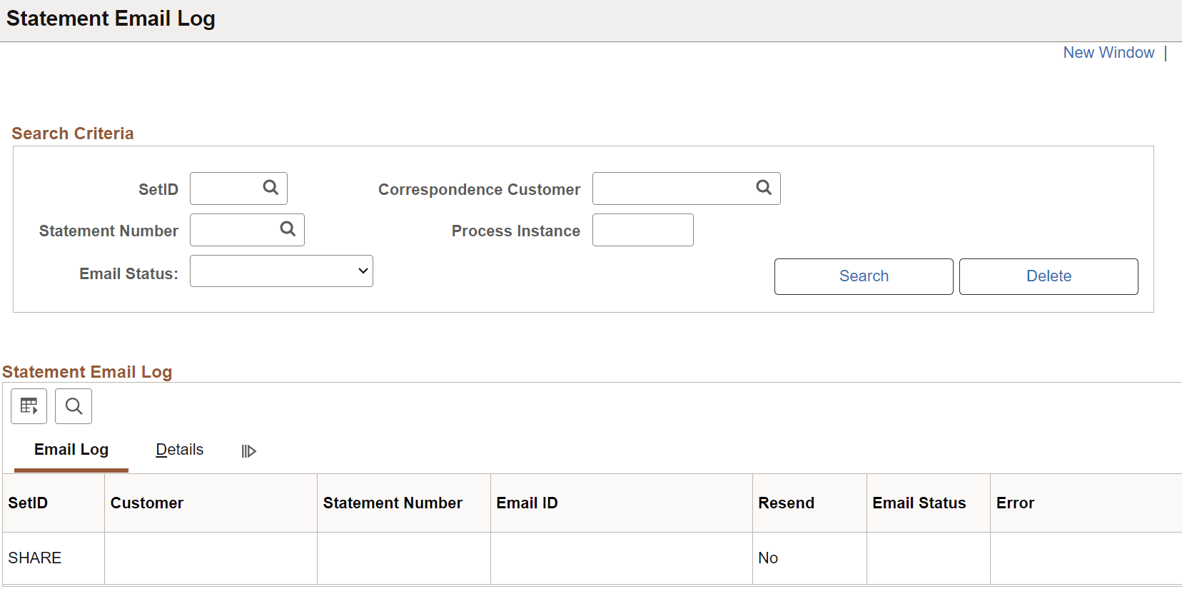

Statement Email Log Page
STMT_EMAIL_LOG
Review the Statement email log.

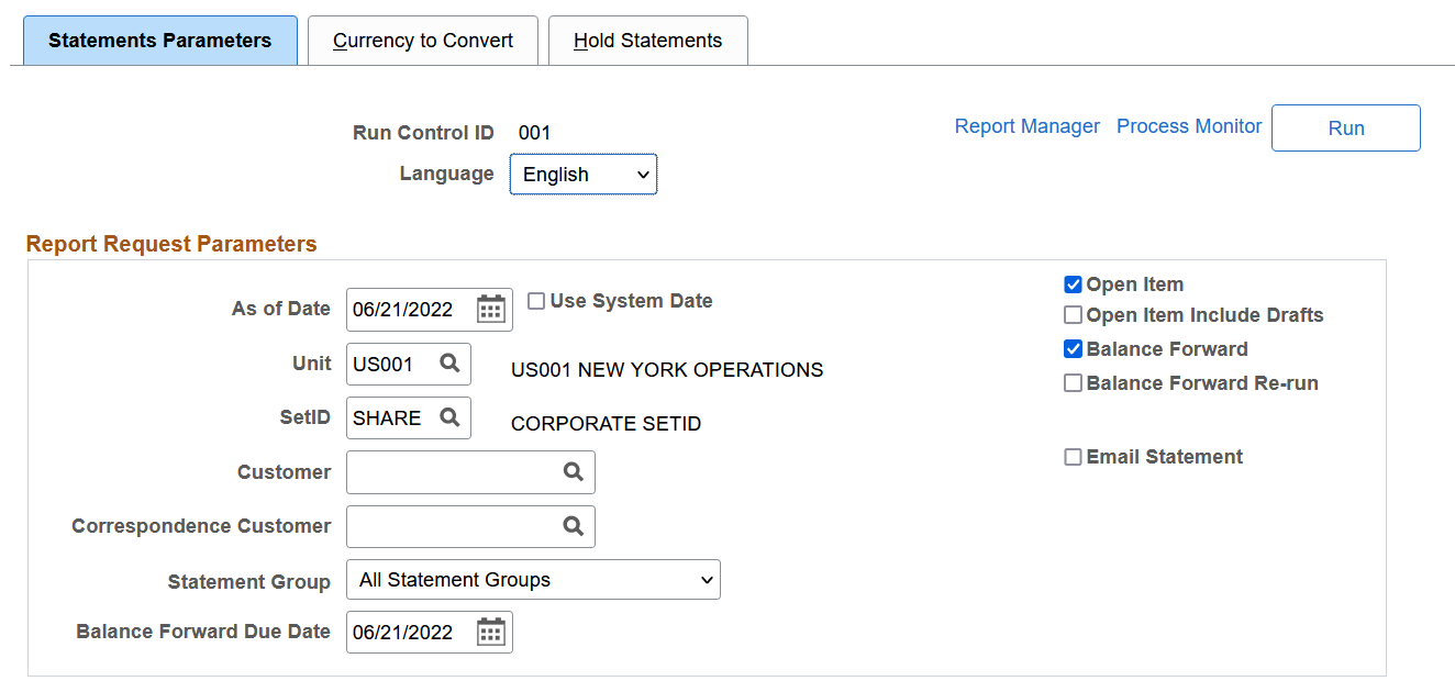

Statements Parameters Page
Use the Statements Parameters page (RUN_AR32001) to run the Statements - Preprocessor (ARSTMT) multiprocess job or the Statements-Parallel/Prnt multiprocess job (STATEMNT).
Navigation:
Accounts Receivable, and then Customer Interactions, and then Statements, and then Create Customer Statements, and then Statement Parameters
This example illustrates the fields and controls on the Statements Parameters page. You can find definitions for the fields and controls later on this page.
Field or Control Description
Language
Select the language to use to print the statements if running the STATEMNT multiprocess job. Do not select a language if you run the ARSTMT multiprocess job.
As of Date and Use System Date
Enter a date that specifies the last date that the statement includes data. The current date is the default. When you select the Use System Date check box, you cannot change the As of Date, and processing always uses the system date for the as of date.
If you use an earlier date in the As of Date field, the process reconstructs customer balances so that statements show open items as of the date that is provided. For example, if statements are run on January 5 and you select an as of date of 1/1/00, the results are the same as if the statements are run on January 1 and the current default date is accepted.
For balance forward statements, the as of date also determines the ending date for the current statement period. The current balance forward statement period begins with the statement date from the previous balance forward statement.
Open Item and Balance Forward
Deselect one of these check boxes if you do not want to run both statement types in the same statement run. This setting is useful when you select a business unit that has some customers who receive open item statements and others who receive balance forward statements, and you do not want to process all of them at the same time.
Open Item Include Drafts
Select to include draft items in an open item statement.
Balance Forward Re-Run
Select to rerun a balance forward statement. The system determines which previous balance forward statement to use for the opening balance based on the as of date. It uses the most recent balance forward statement prior to the as of date. When you rerun a statement, use the same as of date that you use when you run the original statement. The process deactivates the original statement and creates a new one.
If you rerun a balance forward statement and you ran other, later balance forward statements with a different as of date, you must also rerun those statements to ensure that all balances remain correct from one statement to the next.
Note: If the statement type is Bal Fwd, only items that have not appeared on a previous balance forward statement are eligible for exclusion.
Email Statement
Select this option to have individual customer statements emailed to all correspondence customers that have the preferred communication method of Email Only or Email and Print, defined on the PeopleSoft Order to Cash Common Information: Contact Information - Maintain Contacts Page.
Filenames are automatically provided for the PDF statements using this method: Correspondence Customer SetID + Correspondence Customer ID. For example, SHARE1000.pdf.
For each email processed, one statement email log information is created. For more information, see Statement Email Log Page.
Note: The email is sent to the correspondence customer’s primary contact. A valid email address must be defined for primary contact on the PeopleSoft Order to Cash Common Information: Contact Information - Maintain Contacts Page. In addition, select the Primary Bill To option for primary contact using the PeopleSoft Order to Cash Common Information: Contact Information – Contact Customers Page. This option only applies to these reports: ARX32000 (Customer Balance Statement), ARX32001 (Balance Forward Statement), and ARX32002 (Customer Balance with Draft).
(NLD) Print Acceptgiro
Deselect this check box if you do not want to print statements with an acceptgiro attachment. This field appears only if you enabled acceptgiro processing for the selected business unit on the Bank/Payments page and the check box is selected by default.
Unit
Enter a business unit to create statements for all customers with transactions in a specific business unit. If you leave this field blank, a default business unit automatically appears in the field.
SetID
Select a SetID or accept the default SetID. If you leave this field blank, a default SetID automatically appears in the field.
Customer
Enter only a customer ID to create statements for the specified customer. If you select a customer who is part of a correspondence group, the system addresses the statement to the correspondence customer but includes only the specified customer's information.
Note: If you select a single customer, the system generates a statement for that customer even if the customer is on hold.
Enter only the customer ID for a correspondence customer to create statements for all customers in the correspondence group.
Note: If you add or remove a customer from a correspondence customer group between statement periods, rerun the statements for the correspondence customer by using the same as of date as the previous statement. This setting ensures that the balance forward amount for the next statement run will reflect the correct amount.
Statement Group
Enter a statement group to create statements for all groups or only for customers who belong to a selected statement group. Assign customers to a statement group on the Correspondence Options page.
Balance Forward Due Date
Enter the due date to print on the statements if you are running balance forward statements.
Enter the percent wildcard in the Customer fields if you want to include customer IDs that begin or end with the same characters or numbers. For example, entering 100% includes all customer IDs that start with 100, such as 1001 and 1002.
Provide more than one parameter to tailor statements even further. The following table describes the results of combining different parameters. It assumes that a parameter in the left column is combined with one or more parameters to the right of that parameter:
Parameter SetID Business Unit Customer ID
Business Unit
One statement for each correspondence customer in the business unit.
NA (not applicable)
NA
Customer ID
A single statement for the customer. If the customer is part of a correspondence customer group, the process addresses the statement to the correspondence customer but includes only items that are for the specified customer.
A single statement for the customer, containing only items in the business unit. If the customer is part of a correspondence customer group, the process addresses the statement to the correspondence customer but includes only items for the specified customer.
NA
A single statement for the correspondence customer, containing items for all customers in the correspondence group.
A single statement for the correspondence customer, containing items in the business unit for all customers in the correspondence group.
A single statement that is addressed to the correspondence customer, containing only items for the specified customer.

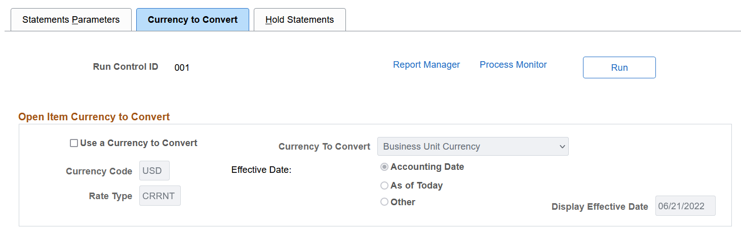

Currency to Convert Page
Use the Currency to Convert page (RUN_AR32001_CUR) to select the type of currency to appear on Open Item statements, and select the effective date.
Navigation:
Accounts Receivable, and then Customer Interactions, and then Statements, and then Create Customer Statements, and then Currency to Convert
This example illustrates the fields and controls on the Currency to Convert page. You can find definitions for the fields and controls later on this page.
The default values for the fields depend on the values that you enter on the Receivables Options - Currency Display Options page for the business unit. Override the values if you want to use a different display currency on the statements.
Use a Currency to Convert
Select to print statements by using the default display currency that you specify in the Currency to Convert field.
Currency to Convert
Select the type of currency for the statements:
Business Unit Currency: Select to use the default currency that is defined for the business unit.
Customer Default Currency: Select to use the preferred currency that is defined for the customer on the General Info page.
Other: Select to use the currency that you enter in the Currency Code field. Then, enter the exchange rate type and specify whether to use today's date, the accounting date, or another date that you specify as the effective date.

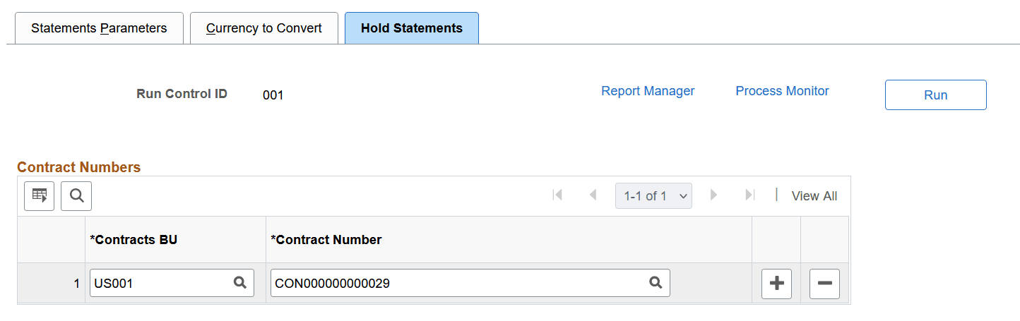

Hold Statements Page
Use the Hold Statements page (RUN_AR32001_CNTR) to exclude invoices from the statement document based on correspondence customers associated with a contract.
This page is only visible if you have installed PeopleSoft Contracts.
Navigation:
Accounts Receivable, and then Customer Interactions, and then Statements, and then Create Customer Statements, and then Hold Statements
This example illustrates the fields and controls on the Hold Statements page. You can find definitions for the fields and controls later on this page.
Contracts BU (Contracts Business Unit)
Enter the business unit associated with the contract.
Contract Number
Enter the contract number. When you select the Run button, any invoices associated with the correspondence customer of the contract are excluded from the Statement document.
Note: The contract you enter must be an active contract.

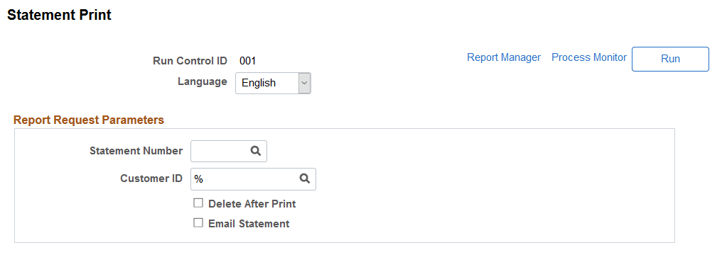

Statement Print Page
Use the Statement Print page (RUN_AR32000) to print statements.
Navigation:
Accounts Receivable, and then Customer Interactions, and then Statements, and then Print Statements, and then Statement Print
This example illustrates the fields and controls on the Statement Print page.
Language
Select the language for the statements.
Statement Number
Displays the most recent number for the run control ID that is not printed. Select a different number to print a different request.
Note: Each time that you run the Statements multiprocess job (ARSTMT), each AR_STMT# child process generates a statement number and applies it to all statements that the run for that child process generates. For example, the AR_STMT1 child process retrieves data for 37 statements and assigns statement number 64. When you print statement number 64, you get 37 statements. You do not have to run the report 37 times.
Email Statement
For each email processed, a statement email log information is created. For more information, see Statement Email Log Page.
On the Process Scheduler Request page, select one of these statement print processes:
Process Description
Customer Statement Print (ARX32000)
Customer Stmt Print w/Agiro (ARX32A00)
Prints open item statement without draft items. The Open Item statement provides a list of all open items for a customer based on the as of date that is specified when the statement is run.
Select Customer Stmt Print w/Agiro only if you want to include the acceptgiro attachment on the statement.
Balance Forward Statement Print (ARX32001)
Balance Forward Stmt P w/Agiro (ARX32A01)
Prints balance forward statements. The Balance Forward statement provides a list of all the items and payments in the current statement period. It also provides a balance forward amount from the previous statement period and the ending balance for the current statement period.
Select Balance Forward Stmt P w/Agiro only if you want to include the acceptgiro attachment on the statement.
Draft Customer Statement Print (ARX32002)
Prints open item statements that include draft items, if Include Drafts is selected on the Statement Parameters page.
PS/AR Statements Print (ARSTPRT)
Prints both statement types: Open Item statement (ARX32000 and ARX32A00) and Balance Forward statement (ARX32001 and ARX32A01).
Note: ARX32001 and ARX32A01 print only if you enabled acceptgiro processing for the business unit.
WARNING:
If you print one statement type only, you must print the other statement type before you run the Statements process again.
Use the Statement Email Log page (STMT_EMAIL_LOG) to review the Statement email log. You can delete the Statement email log entries using the Delete button. The email log entries will be deleted based on the search criteria.
Navigation:
Accounts Receivable, and then Customer Interactions, and then Statements, and then Statement Email Log
This example illustrates the fields and controls on the Statement Email Log page
