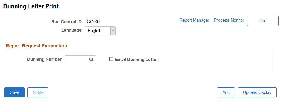

Dunning Letter Print Page
RUN_AR33001
Run reports that merge data from temporary tables with a predefined layout to generate dunning letters.

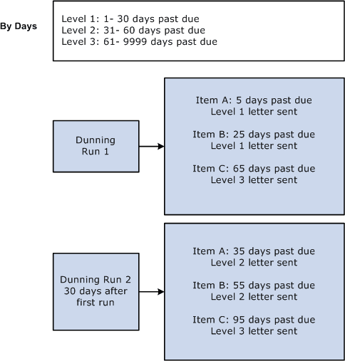

The following diagram illustrates what the Dunning process includes in letters if the dunning method is Dunning by Days. Dunning Run 1 may include Item A, which is five days past due and a level 1 letter was sent; Item B, which is twenty-five days past due and a level 1 letter sent; Item C, which is sixty-five days past due and a level 3 dunning letter sent. Dunning Run 1 is run thirty days after the first run and includes Item A, which is thirty-five days past due and a level 2 letter was sent; Item B is fifty-five days past due and a level 2 letter sent; Item C, which is ninety-five days past due and a level 3 letter sent.
The three levels by days include:
  • One to thirty days past due.
  • Thirty-one to sixty days past due.
  • Sixty-one to nine thousand, nine hundred days past due.
Dunning Run 1 includes these items:
  • Item A, which is five days past due and a level 1 letter was sent.
  • Item B, which is twenty-five days past due and a level 1 letter sent.
  • Item C, which is sixty-five days past due and a level 3 dunning letter sent.
Dunning Run 2 thirty days after the first run includes these items:
  • Item A, which is thirty-five days past due and a level 2 letter was sent.
  • Item B, which is fifty-five days past due and a level 2 letter was sent.
  • Item C, which was ninety-five days past due and a level 3 letter was sent.
This diagram illustrates what the Dunning process includes in letters if the dunning method is Dunning by Days.

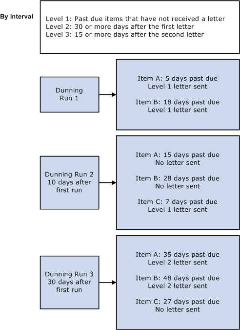

When you use dunning by interval, the level of the letter sent corresponds to the time intervals that you have defined between letters. Therefore, items that receive a level 1 letter could have different ages, but subsequent letters would be determined by the time interval between letter levels. For a customer with multiple past-due items, the oldest item is used to determine the start of the interval cycle.
The following diagram illustrates what the Dunning process includes in letters if the dunning method is Dunning by Interval. The levels by interval include:
  • Level 1: Past-due items that have not received a letter.
  • Level 2: Thirty or more days after the first letter.
  • Level 3: Fifteen or more days after the second letter.
Items included in Dunning Run 1 are:
  • Item A: five days past due, level 1 letter sent.
  • Item B: eighteen days past due, level 1 letter sent.
Items included in Dunning Run 2, which was sent ten days after the first run, are:
  • Item A: fourteen days past due, no letter sent.
  • Item B: twenty-eight past due, no letter sent.
  • Item C: seven days past due, level 1 letter sent.
Items included in Dunning Run 3, which was sent thirty days after the first run, are:
  • Item A: thirty-five days past due, level 2 letter sent.
  • Item B: forty days past due, level 2 letter sent.
  • Item C: twenty-five days past due, no letter sent.
This diagram illustrates what the Dunning process includes in letters if the dunning method is Dunning by Interval.
Items included for Dunning by interval for Dunning Runs 1, 2, and 3

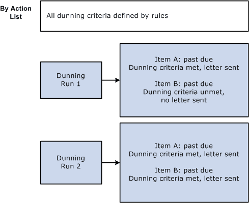

Dunning by action list is entirely based on rules you determine when you set up the system.
The following diagram illustrates what the Dunning process includes in letters if the dunning method is Dunning by Action List. The action list includes all dunning criteria defined by rules. Dunning Run 1 includes:
  • Item A, which is past due, the dunning criteria was met, and a letter was sent.
  • Item B, which is past due, the dunning criteria was met, and no letter was sent.
Dunning Run 2 includes:
  • Item B, which is past due, the dunning criteria was met, and a letter was sent.
This diagram illustrates what the Dunning process includes in letters if the dunning method is Dunning by Action List.
Items on the Dunning action list that are included during Dunning Runs 1 and 2

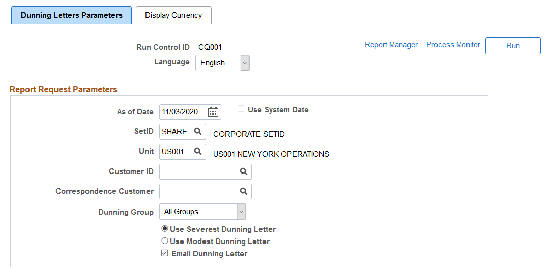

Dunning Letters Parameters Page
Use the Dunning Letters Parameters page (RUN_AR33000) to specify the extract parameters and run the AR Dunning process or the Dunning Letters multi-process job.
Navigation:
Accounts Receivable, and then Customer Interactions, and then Dunning Letters, and then Extract Dunning Letter Info, and then Dunning Letters Parameters
This example illustrates the fields and controls on the Dunning Letters Parameters page. You can find definitions for the fields and controls later on this page.
Field or Control Description
As of Date and Use System Date
Enter a date that determines the last date for the dunning letter data. The current date is the default.
When you select the Use System Date check box, you cannot edit the As of Date field. In this case, processing will always use the current (system) date as the last date for the dunning letter data.
SetID
Use the default SetID or select a SetID. If you use only a SetID and do not enter a specific business unit, the process creates dunning letters for correspondence customers with transactions in every business unit that references the SetID.
Unit
Enter a business unit to create dunning letters only for customers with transactions in the selected business unit.
(NLD) Print Acceptgiro
Deselect this check box if you do not want to print dunning letters with an acceptgiro attachment. This field appears only if you enabled acceptgiro processing for the selected business unit on the Bank/Payments page, and the check box is selected by default.
Customer ID
Enter only a customer ID to extract dunning data for the specified customer. If you specify a customer who is part of a correspondence group, the process addresses the letter to the correspondence customer but includes only the specified customer's items.
Correspondence Customer
Enter only a correspondence customer ID to extract dunning data for all the customers in the correspondence group.
Dunning Group
Select All Groups or the name of a specific group. You assign customers to a dunning group on the Correspondence Options page.
Use Severest Dunning Letter
Select to print the text from the letter code that is associated with the highest dunning level and to print all past-due items for the customer.
Use Modest Dunning Letter
Select to print the text from the letter code that is associated with the lowest dunning level and to print all past-due items for the customer.
Email Dunning Letter
Select this option to have individual customer dunning letters emailed to all correspondence customers whose primary contact has a preferred communication method set to Email Only or Email and Print, as defined on the PeopleSoft Order to Cash Common Information: Contact Information - Maintain Contacts Page.
Note: The email is sent to the correspondence customer’s primary contact. A valid email address must be defined for primary contact on the PeopleSoft Order to Cash Common Information: Contact Information - Maintain Contacts Page. In addition, select the Primary Bill To option for primary contact using the PeopleSoft Order to Cash Common Information: Contact Information – Contact Customers Page. This option only applies to these reports: ARX33000 (Dunning Letters - All Levels), ARX33001 (Level One Dunning Letter), ARX33002 (Level Two Dunning Letter), and ARX33003 (Level Three Dunning Letter).
This table describes the results of combining different parameters. It assumes that a parameter in the left column is combined with one or more parameters to the right:
Use the Dunning Letter Print page (RUN_AR33001) to run reports that merge data from temporary tables with a predefined layout to generate dunning letters.
Navigation:
Accounts Receivable, and then Customer Interactions, and then Dunning Letters, and then Print Letter, and then Dunning Letter Print
Dunning Number
Select the dunning number that the system assigned for the AR Dunning process run instance for the letters that you want to print.
Each time that the AR Dunning process runs, it generates a unique dunning number that serves as a batch ID. The dunning number for the process is applied to all the dunning letters that the process generates. If a process retrieves data for 37 dunning letters, it assigns each dunning letter the same run control ID that is assigned to the AR Dunning process. Using the run control ID in the report parameters enables you to generate multiple dunning letters by using one report. Therefore, if you have 37 letters, you do not have to run the report 37 times.
On the Process Scheduler page, select one or more of the following dunning reports. Each report corresponds to a dunning level and letter code. If you select only the level 3 dunning letter, reports processing prints letters only for customers who have past-due items in dunning level 3.
