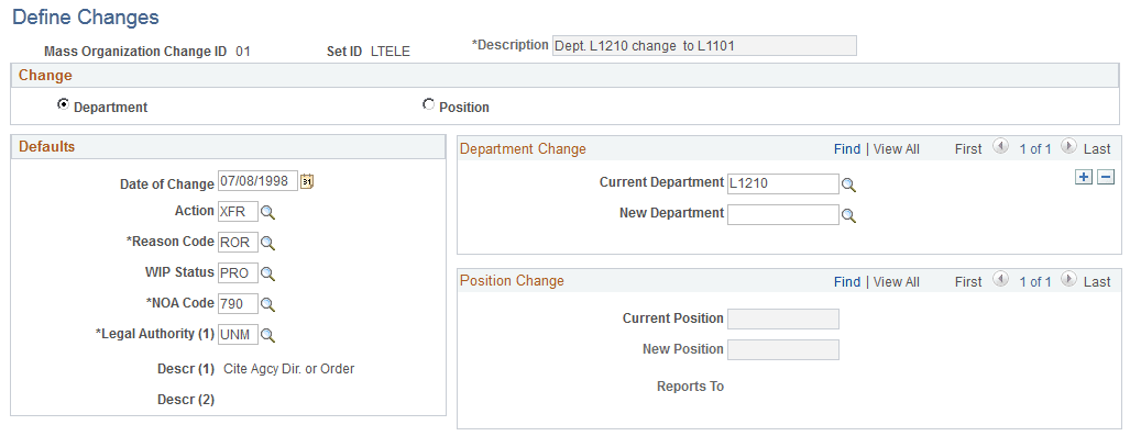

Define Changes Page
Use the Define Changes page (GVT_MOC_DATA) to define mass changes.
Navigation:
Workforce Administration, and then Collective Processes, and then Mass Organization Changes USF, and then Define Mass Org Changes , and then Define Mass Org Changes
This example illustrates the fields and controls on the Define Changes page. You can find definitions for the fields and controls later on this page.
Define Changes page
Change
Indicate if the change is a department or position change. When you select Department, the system makes the fields in the Position Change group box unavailable. When you select Position, the system makes the fields in the Department Change group box unavailable.
Defaults
The system inserts the values you enter here into the new job data rows it creates for the employees affected by this mass organization change.
Field or Control Description
Date of Change
Enter the date the change takes effect. The system uses this date as the effective date on the new Job Data row.
Action and Reason Code
Select the action and reason for the change.
Note: Remember that some actions will set payroll or HR status and/or update employee dates. Review the processing or defaulting that action triggers in the system on the Actions component (ACTION_TBL).
See PeopleSoft Human Resources Administer Workforce: Actions Page.
NOA Code (nature of action code), WIP Status (work-in-progress status), and Legal Authority (1)
Select the NOA code, WIP status, and legal authority (the WIP Status and Legal Authority (1) fields are required).
See Nature of Actions USF Page.
See Setting Up WIP Status.
See Legal Authority Page.
Department Change
You can add more than one row to accommodate changes to a number of departments. If you are merging two departments into one, for example, enter two rows and select one old department in one row and the other old department in the other and select the new department they are merging into in the New Department field in each row.
Old Department
Enter the name of the department that is being changed.
New Department
Enter the new department name.
Position Change
You can add more than one row to accommodate changes to a number of positions.
Old Position
Enter the old position name.
New Position
Enter the new position name.
Reports To
Enter the position that the new position reports to.
