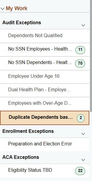

Understanding the My Work Group Box
The My Work group box provides Benefits work item links for exceptions in these group sections:
  • Audit Exceptions
  • Enrollment Exceptions
  • ACA Exceptions
PeopleSoft provides these sample exceptions which you can use, modify or clone to suit your organization's business needs.
This example illustrates the fields and controls on the My Work Group Box.
My Work Group Box
Work item links are grayed out if no data is available for display.
Audit Exceptions

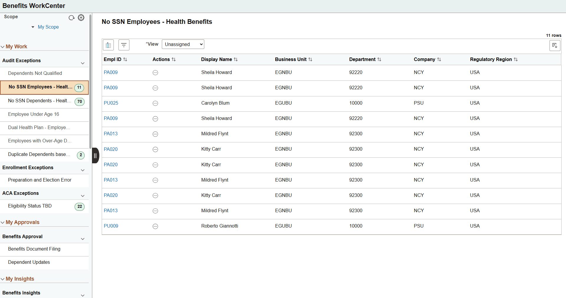

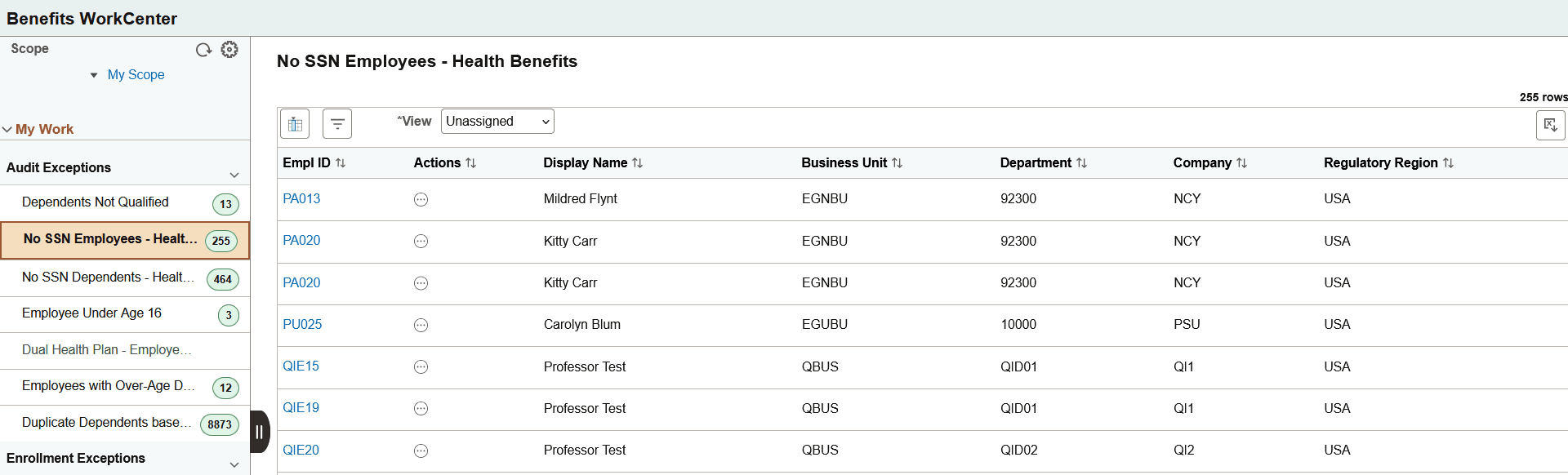

No SSN Employees–Health Benefits Page
Use the No SSN Employees–Health Benefits page to get a report of health benefits of the U.S. employees with missing National IDs.
This example illustrates the fields and controls on the No SSN Employees–Health Benefits Page.
No SSN Employees_Health Benefits Page
Field or Control Description
Empl ID
Select the Empl ID link to access the Modify a Person page, to change the Social Security Number (SSN).
Actions
Select Actions to access the related Actions menu, to modify personal information and benefits summary.
Work Management is enabled by default for No SSN Employees–Health Benefits page. For more information on Work Management, see Using Work Management in Benefits WorkCenter and Enterprise Components: Understanding the Work Management Framework.

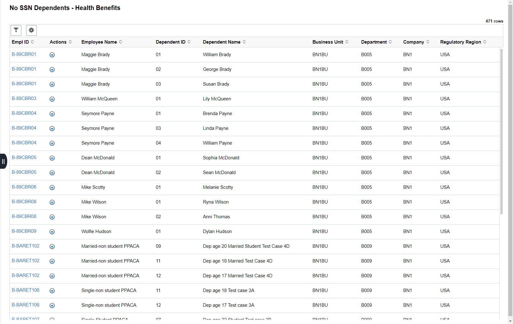

No SSN Dependents–Health Benefits Page
Use the No SSN Dependents–Health Benefits page to get a report of the U.S. health benefits dependents with missing National IDs.
This example illustrates the fields and controls on the No SSN Dependents–Health Benefits Page.
No SSN Dependents - Health Benefits

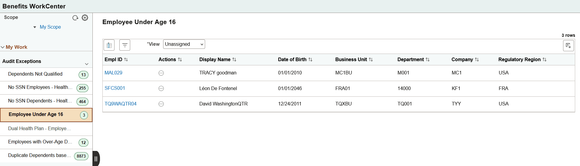

Employee Under Age 16 Page
Use the Employee Under Age 16 page to get a report of employees, like interns, under the age of 16, or to pull up incorrect records where date of births were entered wrong.
This example illustrates the fields and controls on the Employee Under Age 16 Page.
Employees Under Age 16 Page
Work Management is enabled by default for Employee Under Age 16 page. For more information on Work Management, see Using Work Management in Benefits WorkCenter and Enterprise Components: Understanding the Work Management Framework.

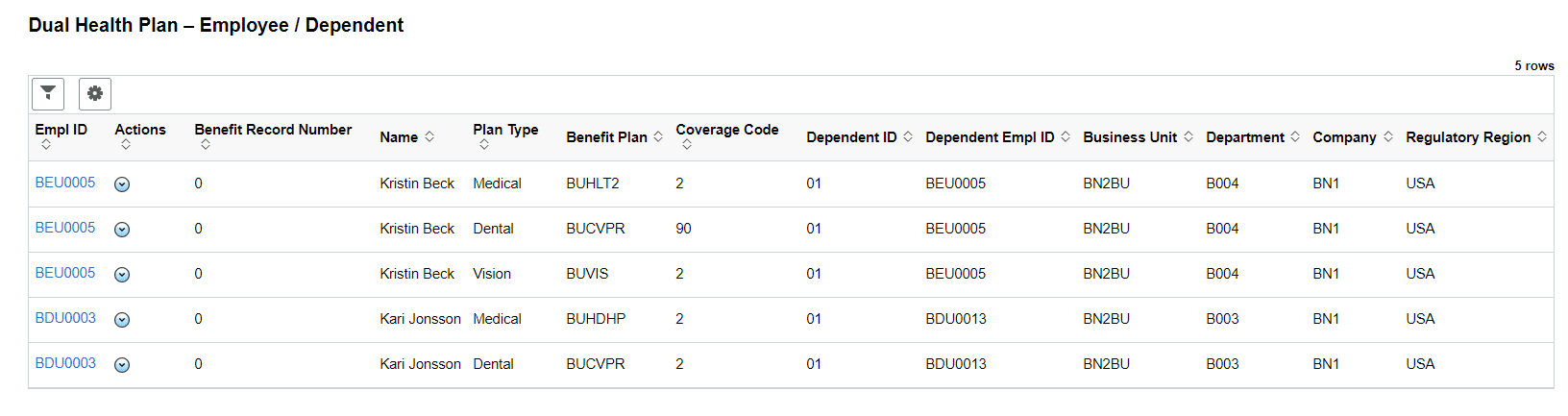

Dual Health Plan–Employee/Dependent Page
Use the Dual Health Plan–Employee/Dependent page to fetch a report to find out if the employee and spouse or dependent work in the same company and if both are enrolled in health plans.
This example illustrates the fields and controls on the Dual Health Plan–Employee/Dependent Page.
Dual Health Plan - Employee Dependent

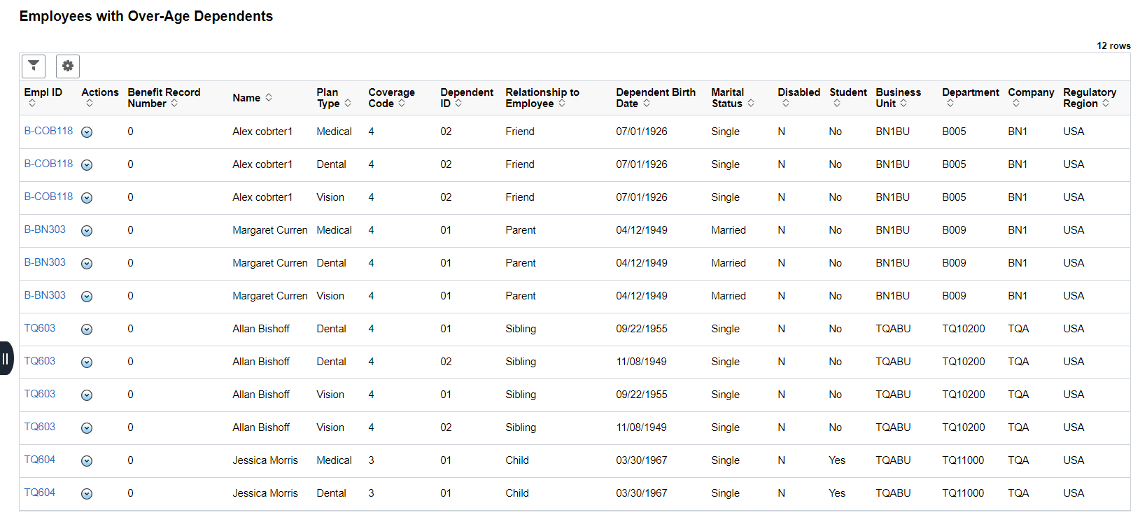

Employees with Over-Age Dependents Page
Use the Employees with Over-Age Dependents page to get a list of dependents of employees who are over the age as based on the PeopleSoft Human Resources Manage Base Benefits: Dependent Rules Table Page.
This example illustrates the fields and controls on the Employees with Over-Age Dependents Page.

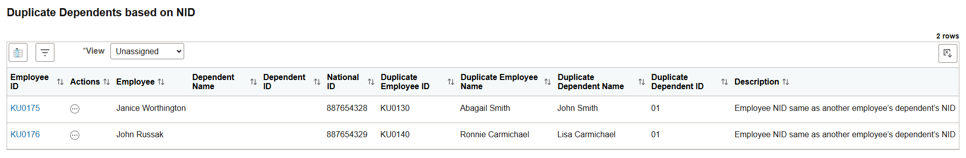

Duplicate Dependents based on NID
Use the Duplicate Dependents based on NID page to get a report on employees and their dependents with the same NID (National ID). Only active employees will appear on the first column.
This example illustrates the fields and controls on the Duplicate Dependents based on NID Page.
The work item helps to identify the following scenarios:
  • Employee whose NID matches with NID of another employee or another employee's dependents
  • Dependent whose NID matches with NID of another employee or another employee's dependents
Empl ID
Select the Empl ID link to access the Modify a Person page, and change the National ID (NID).
Actions
Select Actions to access the Related Actions menu View Duplicate Data. Select this option to open the Dependent/Beneficiary page and update the duplicate dependent’s NID. The updates can be saved directly on the modal window. If the duplicate involves a dependent’s NID, the modal will open the Update Dependent/Beneficiary page to update the duplicate dependent’s NID.
Work Management is enabled by default for Duplicate Dependents based on NID page. For more information on Work Management, see Using Work Management in Benefits WorkCenter and Enterprise Components: Understanding the Work Management Framework.

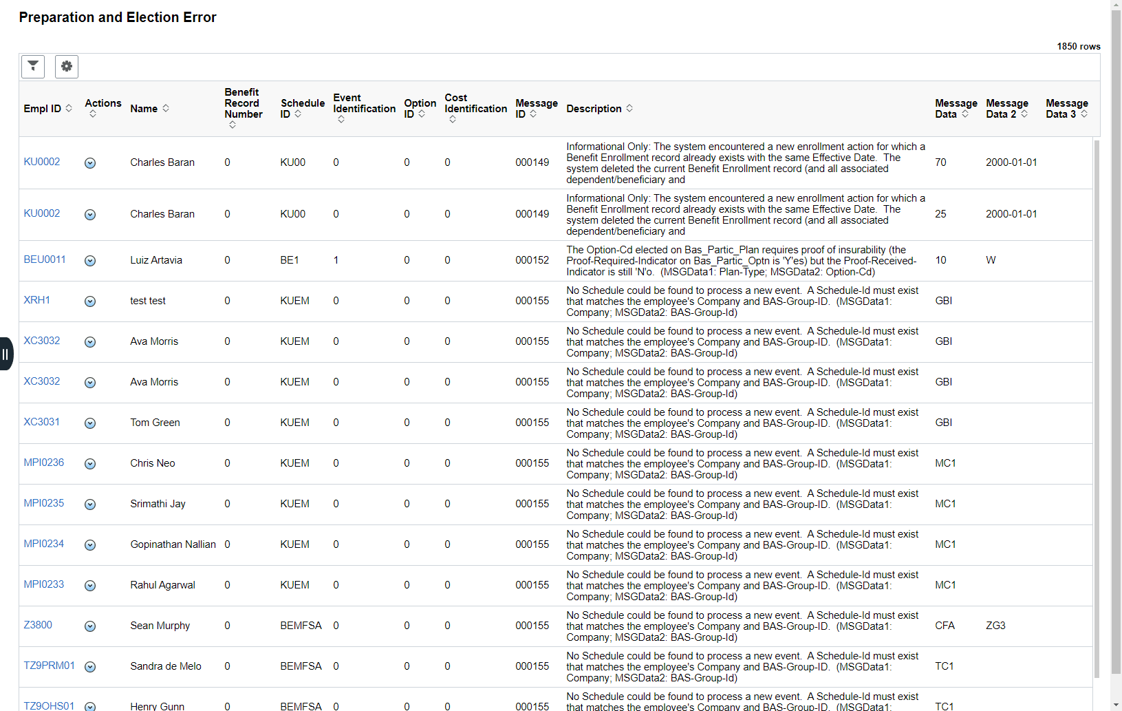

Preparation and Election Error Page
Use the Preparation and Election page to get reports on errors appearing during preparation and election of benefit plans.
This example illustrates the fields and controls on the Preparation and Election Error Page.

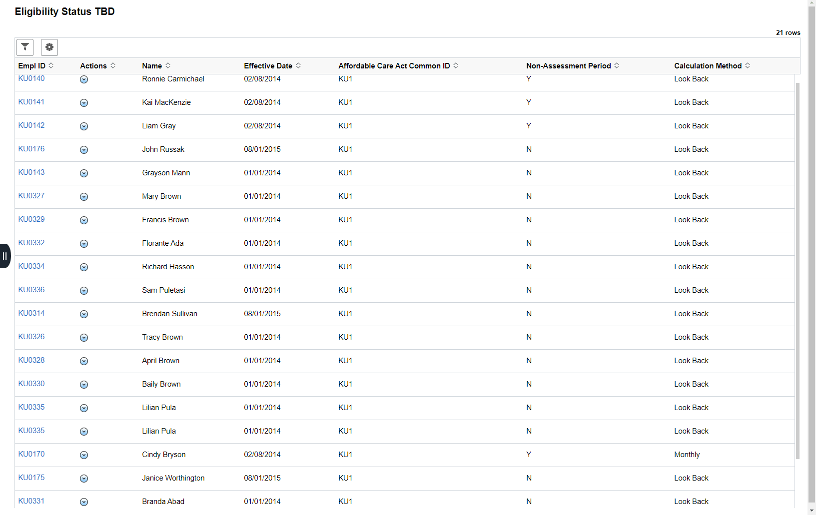

Eligibility Status TBD Page
Use the Eligibility Status TBD page to get a report on the employees with the ACA eligibility status as “To be Determined”.
This example illustrates the fields and controls on the Eligibility Status TBD Page.
