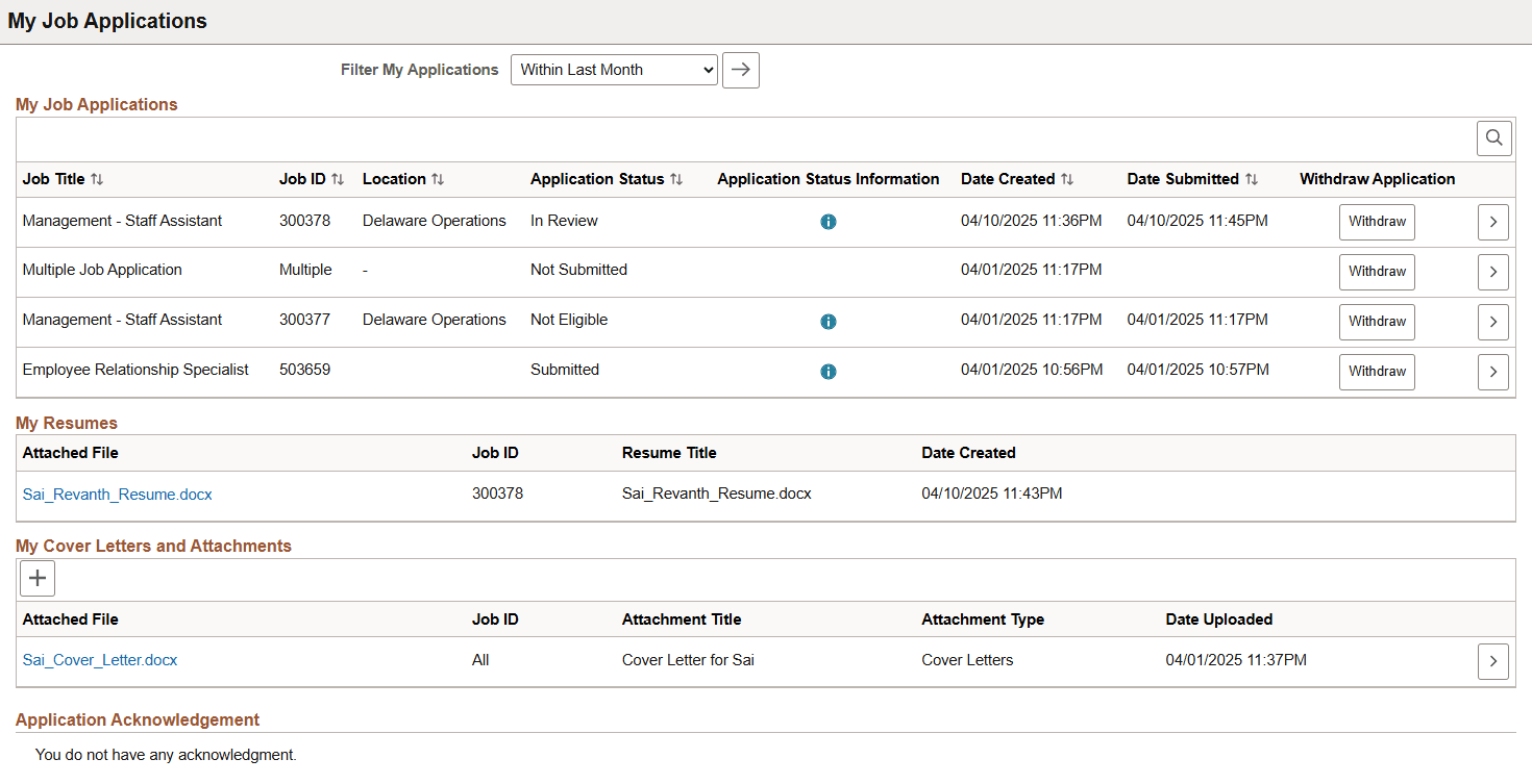

My Job Applications Page
Applicants use the My Job Applications page (HRS_CE_ACTVTY_FL) to:
  • Review summary information about applications, resumes, and attachments.
  • Withdraw applications.
  • Add and remove attachments that aren’t associated with an application.
Navigation:
  • Click the My Job Applications action on the Explore Jobs page.
  • Click the My Job Applications item in the Actions List.
From PUM Image 53, the existing Careers page has been renamed to Explore Jobs. If you are looking for the Careers page, please navigate to the Explore Jobs Page instead.
This example illustrated the My Job Applications page.
My Job Applications
This grid lists an applicant’s submitted and unsubmitted applications.
Field or Control Description
Filter My Applications drop down
Select an option from the drop down to filter the job applications based on time period. Available options are:
  1. All Applications
  2. Within Last Month
  3. Within Last Three Months
  4. Within Last Week
  5. Within Last Year
Click to Filter Applications iconClick to Filter Applications icon
Select to view the job applications based on the filter criteria.
Find My Job Applications iconFind My Job Applications icon
Select to enter a text and search for job applications.
Sort My Job Applications iconClick to sort icon
Select to sort job applications by corresponding column header such as Job Title, Job ID, Location, Status, Date Created, or Date Submitted.
Job Title
This field displays the job posting title unless the applicant initiated the application as a multi-job application. In this case, the field displays the text Multiple Job Application.
Note: Multiple Job Application refers only to applications where the applicant explicitly chose to include multiple jobs in a single application. For submitted multiple job applications, based on the site set up, applications will be broken down into individual applications. Once the ‘Split Multiple Jobs’ check box is selected on the Site Setup page, the applicants can view the status of each submitted application individually. For drafted Multiple Job Applications, this setting is not applicable. Drafted multiple job applications will not be shown separately. If a recruiter uses Talent Acquisition Manager to link an applicant to additional jobs, those jobs are technically added to an existing application. But although the application now has multiple jobs, each job that was linked using Talent Acquisition Manager appears in a separate row in this grid in Candidate Gateway, and each row in the grid shows the job posting title in the Job Title field.
Job ID
Displays the job opening ID for the application, or displays the word Multiple if the application is for multiple jobs.
Location
Displays the primary recruiting location for the job. If the application includes multiple jobs, this column displays a dash.
Application Status
The Application status is Submitted if the application has been submitted.
Note: The system does not update this status as the application moves through the recruiting process. Even if the application is rejected or the job opening is filled, the status remains Submitted.
The Application status is Not Eligible if an applicant failed prescreening for all job openings and was not allowed to continue the job application.
The Application status is Not Submitted if the application was saved for later and the applicant is able to continue with the job application.
The Application status is Withdrawn if the disposition is 130 Withdrawn. This is the disposition that the system assigns when an applicant or a recruiting user withdraws the application. However, if an unsubmitted application is withdrawn, it is logically deleted and disappears from the My Job Applications grid entirely rather than appearing with a Withdrawn status.
Note: For Multiple Job Application that is not submitted, the Application Status of Not Submitted is shown.
Application Status Information
Lists the application status information.
Review Application Status Information
Review the application status.
Date Created
Displays the date and time that the application was started, regardless of whether it was submitted on that date.
Date Submitted
Displays the date and time that the application was submitted. This column is blank for applications that have not been submitted.
Date Withdrawn
Displays the date and time that the application was withdrawn. This column is visible only if at least one application is in Withdrawn status.
Withdraw Application
An applicant clicks the Withdraw button in this column to withdraw an application. If the application (or at least one job in a multi-job application) is in a disposition that does not allow applicant withdrawal, a message informs the applicant that withdrawing the application is not allowed. Otherwise, the application is withdrawn.
Note: For submitted multiple job applications, based on the site set up, applications will be broken down into individual applications. Once the ‘Split Multiple Jobs’ check box is selected on the Site Setup page, the applicants can view the status of each submitted application and withdraw applications individually. For drafted Multiple Job Applications, this setting is not applicable. Drafted multiple job applications will not be shown separately and cannot be withdrawn individually.
Clicking the Withdraw button has different results depending on the type of application:
  • Withdrawing a draft application removes the application from this page.
  • Withdrawing a submitted application changes the Status to Withdrawn and hides the Withdraw button in the row.
The withdrawal process is discussed in more detail earlier in the Understanding Application Withdrawal section of this topic.
Open Application icon Open Application
If the application has been submitted, clicking this button displays the Application Summary Page.
If the application is unsubmitted, clicking this button opens the application so that the applicant can continue.
My Resumes
This grid lists all resumes that are associated with the applicant’s submitted applications. If a resume has been used more than once, it appears multiple times in the grid—once for each time it was used.
The grid does not include rows for unsubmitted applications or for withdrawn applications.
If the resume is an attachment, this field displays the file name. Clicking the file name opens the file.
If the resume was pasted into the application, this field displays the text Pasted Resume. Clicking this text displays the Resume page.
Although Fluid Candidate Gateway does not provide a way for applicants to paste resumes into applications, applicants use this page to see resumes that were previously pasted in using classic Candidate Gateway.
Job ID
Displays the job ID if the resume is from an application for a single job.
Displays Multiple if the resume is from a multi-job application.
This field is blank if the resume is from an application that does not include a job opening.
Resume Title
Displays the resume title that the applicant supplied during the application process. The default resume title is the file name.
Date Created
Displays the date and time that the applicant first added this resume to an application.
My Cover Letters and Attachments
This grid displays the applicant’s non-resume attachments, including attachments that were uploaded in Talent Acquisition Manager.
Attachments that are associated with unsubmitted or withdrawn applications do not appear here. However, a Talent Acquisition Manager user who views a withdrawn application can still see that application’s attachments.
Add icon Add Attachment
Applicants click this button to add an attachment. This button opens the Add Attachment page.
If no attachments have been uploaded yet, the Add Attachment button has a text label rather than appearing as an icon.
Attachments that are added here are not associated with a specific application.
Displays the file name of the attachment. Click to open the file.
Job ID
Displays a job ID if the attachment is associated with an application for a single job.
Displays Multiple if the attachment is associated with a multi-job application.
Displays All if the attachment is not associated with a job application. Because these attachments are associated with the applicant rather than with a specific job application, Talent Acquisition Manager users can see these attachments in all of the applicant’s applications.
Attachments that are uploaded on the My Job Applications page are not associated with specific job applications.
Attachment Title
Displays the descriptive title that the applicant supplied when adding the attachment.
Attachment Type
Displays the attachment type (not the file type) for the attachment.
An applicant who uploads a file must specify an attachment type. However, an attachment type is not required for attachments that are uploaded in Talent Acquisition Manager.
Date Uploaded
Displays the date and time that the attachment was uploaded.
Edit icon (fluid) (Edit button)
Applicants click this button to open the Edit Attachment page, where they can change the attachment information, upload a different file, or delete the attachment.
This button is available only for attachments that are not associated with a job application. These are attachments where the Job ID is All.

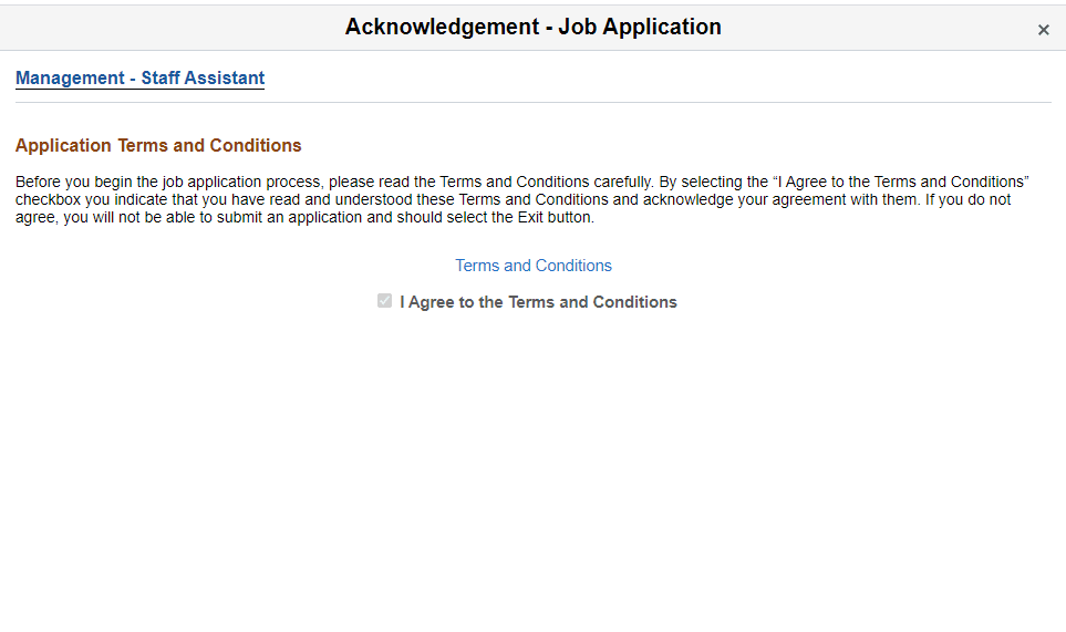

Application Acknowledgement
The Application Acknowledgement section displays all the application acknowledgements that the user has accepted. This section is available only if Acknowledgement is enabled in the Site setup page or if the applicant has as least one acknowledgement. This is only for the acknowledgements created using the Acknowledgement Framework. The grid has the following details:
Job Title
The job titles for which the application acknowledgement were accepted.
Job ID
The Job IDs for which the application acknowledgement were accepted.
Date/Time Stamp
The time at which the acknowledgements were accepted.
For the submitted Multiple Job Application, if the ‘Split Multiple Jobs’ is selected on the Site Setup page, the applicant can view the job applications separately.
Select the application acknowledgement row to view the details of the acknowledgement.
This example depicts the application acknowledgement details
Application acknowledgement details.

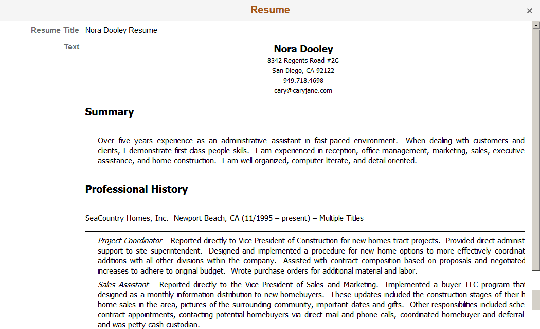

Resume Page
Applicants use the Resume page (HRS_APP_CE_RES_SCF) to view a resume that was pasted into the system.
Navigation:
In the Resumes grid on the My Job Applications page, click the Pasted Resume link that appears for resumes that were pasted into the system.
This example illustrates the Resume page.
Resume page for pasted resumes(fluid)
This is a read-only page. Close the modal window to return to the My Job Applications page.
