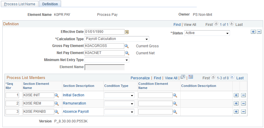

Use the Definition page (GP_PROCESS) to identify sections comprising the process list and the order of execution.
Navigation:
Set Up HCM, and then Product Related, and then Global Payroll & Absence Mgmt, and then Framework, and then Processing, and then Process Lists, and then Definition
This example illustrates the fields and controls on the Definition page.
Definition page
Field or Control Description
Calculation Type
Select the calculation type that identifies whether the process list can be used for absence or payroll processing. This field also determines which section types you can add to the process list. Values are: Absence Calculation and Payroll Calculation .
Gross Pay Element
Enter the accumulator element for gross pay. The system stores the gross amount in the payee's segment status record. This field is not available for absence process lists.
Net Pay Element
Select the net pay accumulator element the banking process uses when determining the payee's net pay. The system stores the net amount in the payee's segment status record. The information is also used during net pay validation for arrears processing. This field is not available for absence process lists.
Minimum Net Entry Type
This field is applicable when you use the net pay validation feature. Net pay validation occurs when a payee's deductions exceed net pay or a minimum net pay amount that you define. To prevent net pay from dropping below a minimum amount, select the type of element that defines the minimum amount. This works with net pay validation processing regardless of whether the processing occurs in processing order (not in a net pay validation subsection) or priority order (in a net pay validation section).
Values are Bracket - Numeric, Formula - Monetary & Decimal, and Variable - Numeric.
Minimum Net Element
Select the element that defines minimum net pay. Your selection in the Entry Type field determines the elements from which you can select.
Deduction net pay validation processing uses the minimum defined here. If you do not enter a minimum value, zero is used as the minimum during net pay validation
When you define this element, consider whether you want the system to recalculate it. Most likely, you will want one minimum net value for the entire pay run. If this is the case, you will want to deselect the Always Recalculate option.
Process List Members
Section Element Name
Select the name of the section that you're adding. The calculation type that you selected determines sections that can be added. You can use a section only once in a process list, but you can add the same section to more than one process list.
Condition Type
Select Formula or Variable to specify a condition for resolving the section that you're adding to the process list.
Condition Element Name
Required if you selected a condition type. Select the name of the element that defines the condition. If the element resolves to zero, the condition is considered false and the section isn't resolved. If the element resolves to a nonzero value (for example, -2, -1, 1, or 2), the condition is considered true and the system tries resolving the section.
