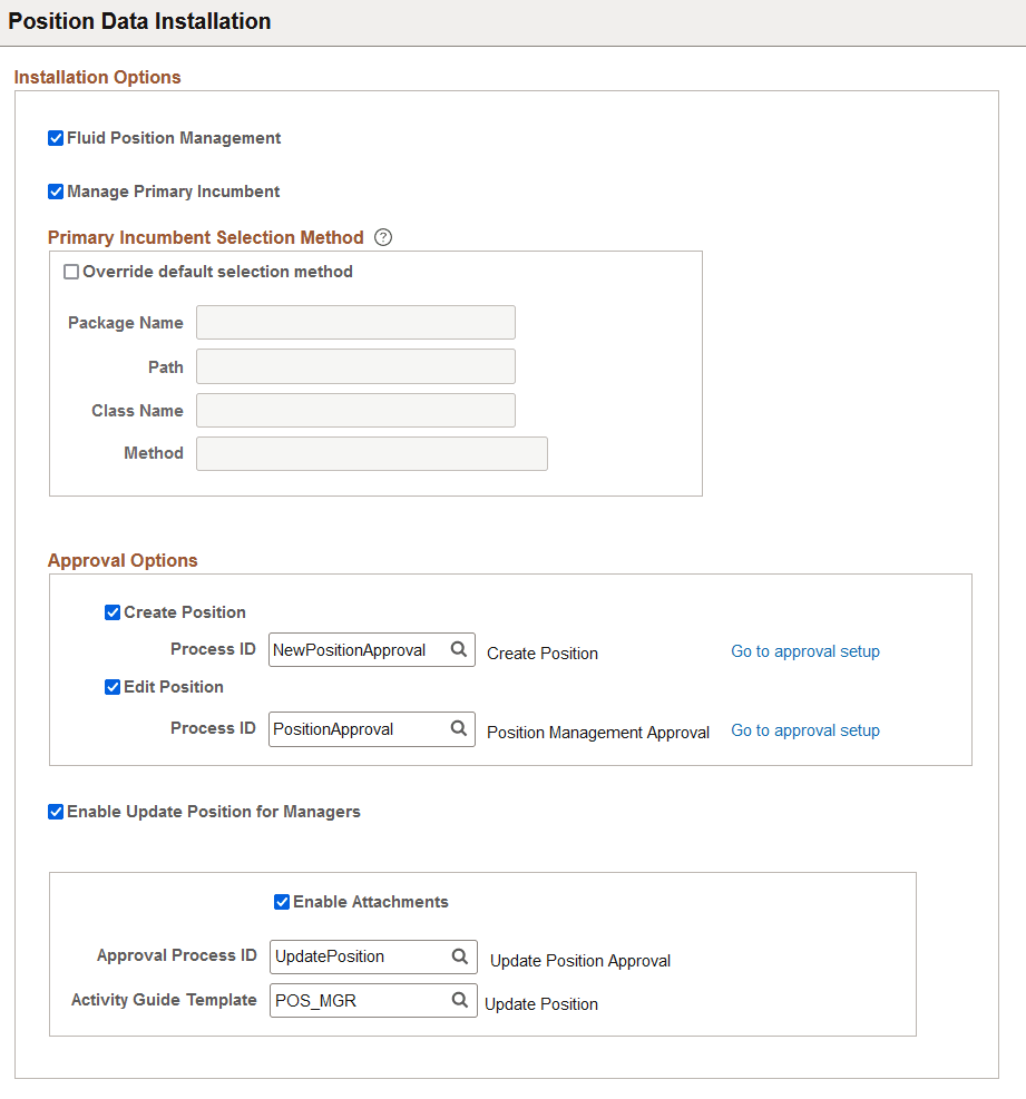

Position Data Installation Page
Use the Position Data Installation page (INSTALLATION_POS) to define installation settings for Position Management for fluid.
Navigation:
Set Up HCM, and then Install, and then Product Specific, and then Position Data Installation, and then Position Data Installation
This example illustrates the fields and controls on the Position Data Installation page.

Fluid Position Management
Select to enable the Manage Position pages to view, update, or create positions using fluid. If this option is deselected, when a user selects the Manage Position Tile, the system will issue a warning to enable Fluid Position Management. By selecting this option, you will also enable the Manage Primary Incumbent check box on this page.
Note: In order for users to access the Manage Position pages in fluid, you must assign the Manage Positions Fluid (HCCPHRFL3100) permission list to the administrator role managing positions.
Important: When you first enable Fluid Position Management functionality, you will need to run the one-time Sync Fluid Position Data (POS_SYNC_FLU) process to synchronize Position Management data from the existing classic records to the fluid records. See Setting Up and Maintaining Fluid Position Management.
Manage Primary Incumbent is a configurable feature for those who use Fluid Position Management but it’s not mandatory.
Select to identify and track primary incumbents for your positions. This option is deselected (off) by default. If this option is deselect, when a user clicks the Manage Primary Incumbents Tile, the system will issue a warning that the user is not authorized to access the component and to enable Manage Primary Incumbent on this Installation table.
Note: To track primary incumbent information, you must enable Fluid Position Management by selecting the Fluid Position Management check box on this page.
When you select this check box, the page displays the Primary Incumbent Selection Method section on this page. The primary incumbent selection method allows you to use the delivered selection method, or override the delivered method and use a method that suits your organization requirements to identify primary incumbents.
Note: To grant users Manage Primary Incumbent functionality in fluid, you must assign the Primary Incumbent Admin role to the administrator managing primary incumbents.
Important: When you first enable the Manage Primary Incumbent functionality, you will need to run the one-time Sync Incumbents (POSN_PRI_SYNC) process to bring data from classic position management and have the system assign a primary incumbent for every position in the database wherever an incumbent is available for a position. Then run the Nightly Refresh Primary Incumb (POSN_PRI_AE) on a regular basis. See also Setting Up and Maintaining Fluid Position Management.
This section is available when you select the Manage Primary Incumbent check box.
PeopleSoft Position Management delivers logic to auto assign a primary incumbent when the current primary incumbent leaves the position. You can accept the delivered logic, or use this section to enter your own custom app class method to define the selection logic.
Field or Control Description
Override default section method
Select this check box to override the delivered logic of auto assigning a primary incumbent. This opens up the remaining fields in this section.
Deselect to use the system delivered logic.
Note: PeopleSoft selects the primary incumbent based on the same logic used in Job Data to show the Reports To manager information on the Job Data - PeopleSoft Human Resources Administer Workforce: Job Information Page, which selects the top most employee in the list of current incumbents.
Package Name
Select the ID of the application package that contains the method selection logic.
Path
Enter a path that uses a specific class within the package.
Class Name
Enter the name of the application class that contains the selection logic.
Note: This application class method should retrieve an Empl ID that assigns this employee as the primary incumbent.
Method
Enter the method name of the application class ID that identifies the selection logic.
Running the Nightly Refresh Primary Incumbent Process
Important:
You will need to run the Nightly Refresh Primary Incumb (POSN_PRI_AE) process on a regularly scheduled basis, or manually as needed, to maintain the current primary and incumbent information.
Approval Options
Use this section to configure approval related information for Fluid Position Management. You can define if approval is needed when creating or adding position data rows, when correcting existing position data rows, or for both.
Approvals need to be enabled to use this functionality.
Create Position and Process ID
Select to require approvals when a new position data row is added. Then, associate the approval process ID that should be used when entering new position data. The Process ID field is required if you have enabled the Create Position approval option. When you enable the approval check box, the process ID will prepopulated with the NewPositionApproval transaction, but you can override this.
Edit Position and Process ID
Select to require approvals when any position data is corrected. Then, enter the approval process ID that should be used when editing position data. The Process ID field is required if you have enabled the Edit Position approval option. When you enable the approval check box, the process ID will prepopulated with the PositionApproval transaction, but you can override this.
You can associate the same process ID for the above mentioned Approval options.
If you enter your own approval process definition ID for creating a new row or for updating existing position data, you will also need to update the Approval Process definition (Approval Framework: Defining the Setup Process Definitions Component), the Page Composer setup (Enterprise Components: Understanding Page Composer), and Mobile Approvals options.
Go to approval setup
Click this link to open a new browser window and access the approval setup Approval Framework: Register Transactions Page. You can then view or update the existing registered approval transaction setup for the process ID you entered. When no ID is entered, the system will direct you to the Register Transactions search page where you can review all transaction registries.
On the submission of a position transaction, the approval chain will appear on the following pages:
Enabling Update Position for Managers
Enable Update Position for Managers
Select to allow a manager to update an empty position from the PeopleSoft eProfile Manager Desktop: My Team – Summary Page. When enabled and a manager selects the Related Actions icon next to the empty position, the Update Position menu item is available. When you select this item, additional fields for managers to modify positions appear on the page. The fields can be configured using Page and Field Configuration.
Note: Use the Application Fundamentals: Direct Reports Transaction Configuration Page to configure the My Team component to show empty positions.
Enable Attachments
Select to allow the manager to add attachments when updating a position.
Approval Process ID
This field is required when Enable Update Position for Managers is selected.
Enter the process ID that will drive approvals for manager position update requests. The system provides the UpdatePosition value by default, but you can change this.
Activity Guide Template
Enter the activity guide that the manager will use when initiating the position update request. The system delivers the POS_MGR (Update Position) activity guide template. For more information on activity guide templates, see Enterprise Components: Understanding the Activity Guide Composer.
