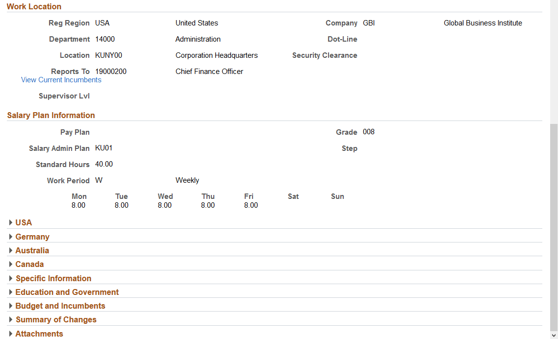

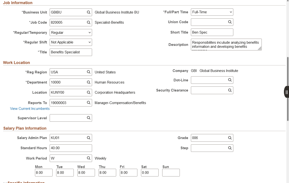

Manage/Create Position - Position Data Page
POSITION_DATA_1_FL
Enter a description and job details about the position.

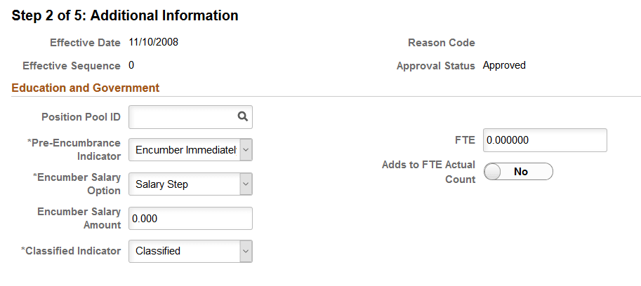

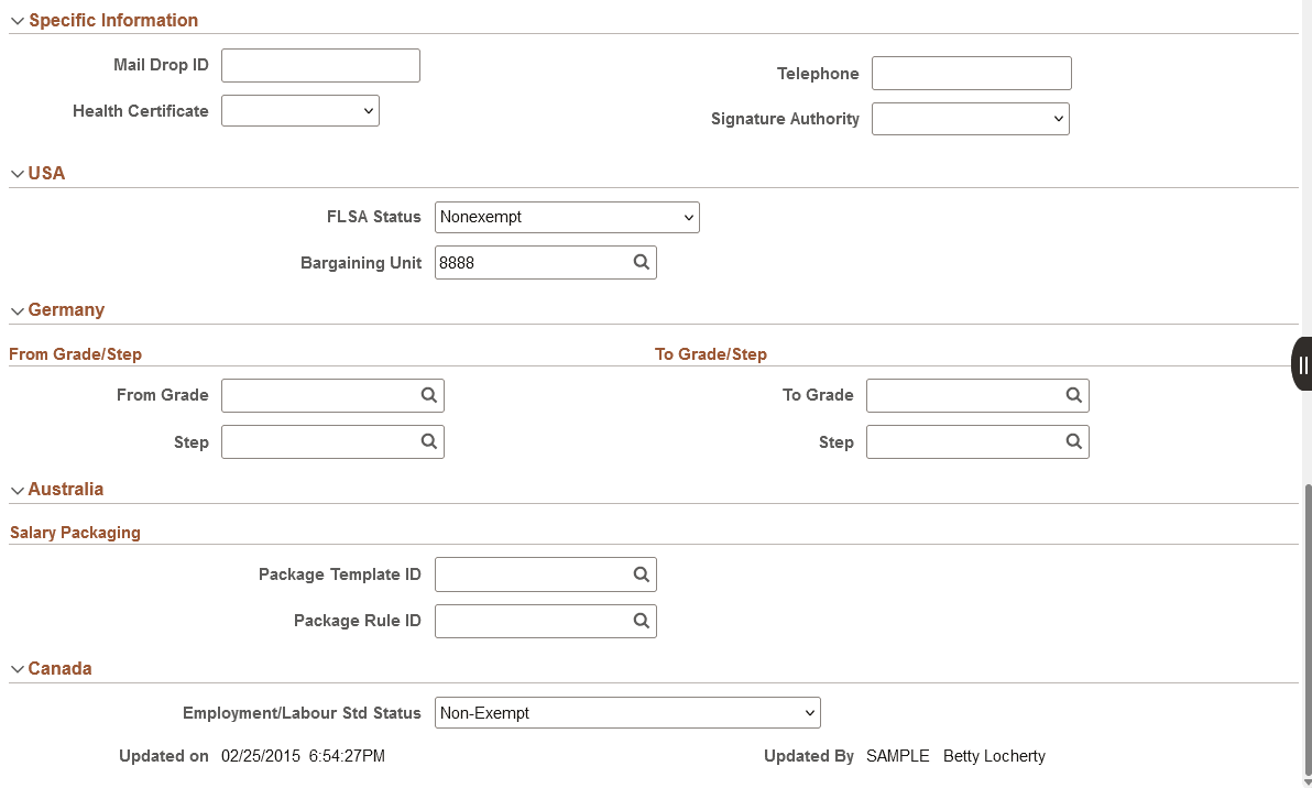

Manage/Create Position - Additional Information Page
POSITION_DATA_5_FL
Enter Education and Government information that is specific to the position.

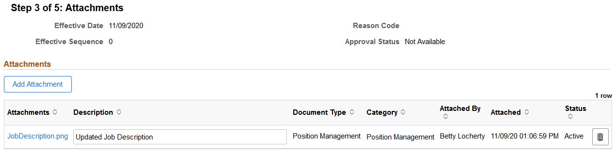

Manage/Create Position - Attachments Page
POSITION_ATTACH_FL
Add or view attachments for a position.

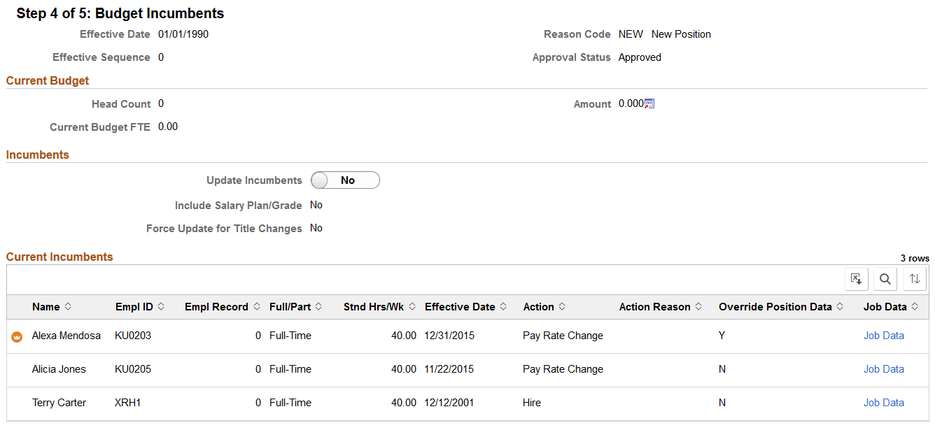

Manage/Create Position - Budget Incumbents Page
POSITION_DATA_6_FL
Review the position's current budget and incumbents.

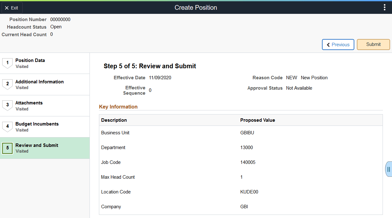

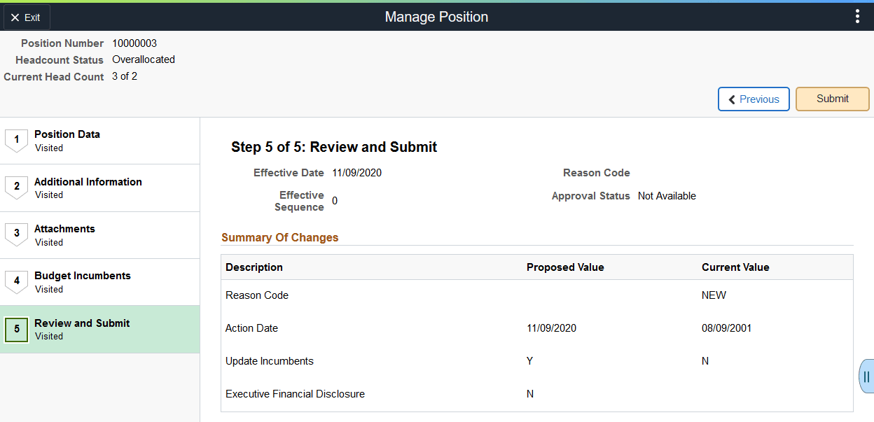

Manage/Create Position - Review and Submit Page
POSITION_SUMM_FL
Review a summary of the changes to this position and submit your position data for approvals.

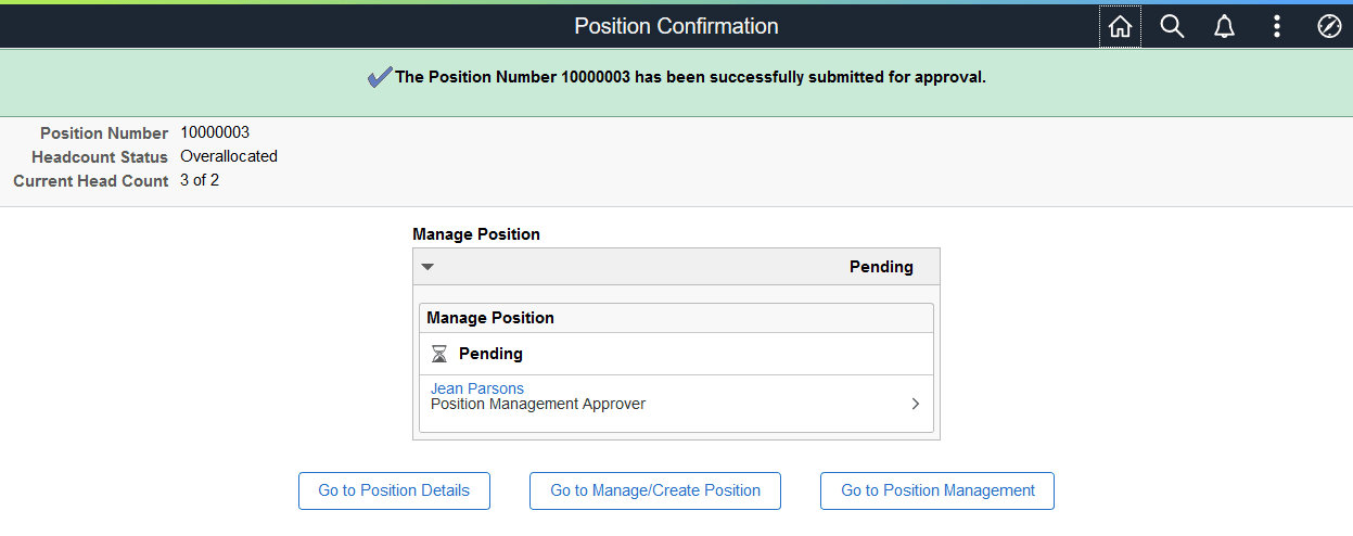

Position Confirmation Page
POS_SUB_CNF_FL
Confirm that your position updates have been submitted.

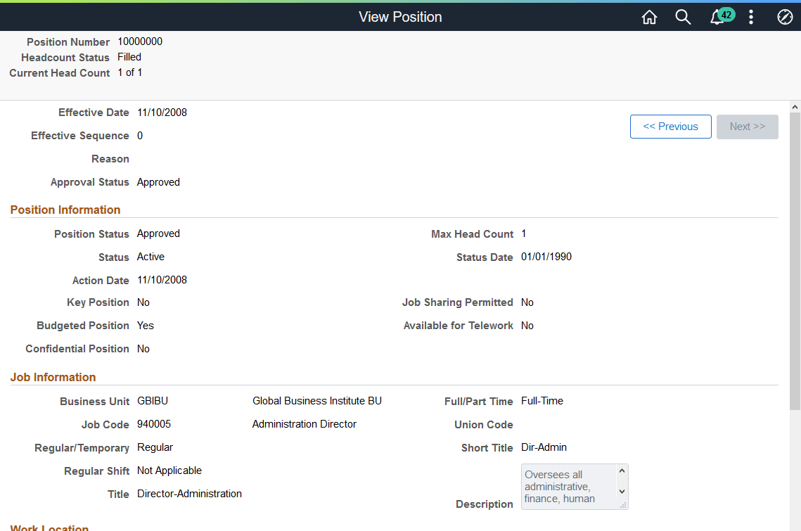

View Position Page
POSITION_VIEW_FL
View a complete summary of the position details by effective date.

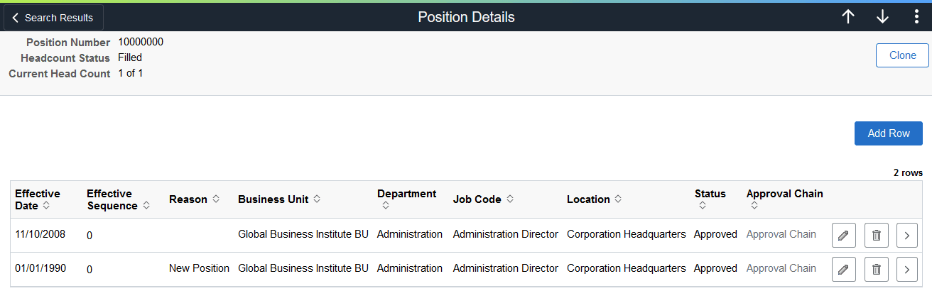

Position Details Page
Use the Position Details page (POSITION_DETAIL_FL) to add, clone, view, edit, or delete an effective dated row for a position.
Navigation:
Select a position from the search page.
This example illustrates the fields and controls on the Position Details page.
The position header (gray sub-banner) displays the unique number assigned to the position as well as the headcount status information. When you add or clone a position, you can specify the position number when creating a new position or you can enable the system to assign the next number for you (when you save) by accepting the default value 00000000.
Modifying the Effective Date of a row will not modify the Effective Sequence in the remaining rows automatically
To avoid maintaining two different sets of position numbers, it is best practice to either always assign numbers manually or always enable the system to do it; do not do both.
Field or Control Description
Previous in List icon button (Previous in List) and Next in List icon button (Next in List) icon buttons
Click the up and down arrow icon buttons to scroll through the position search results list that was generated in previous step of this process.
Clone button (Clone) button
Click to clone the properties of this position. The system will open the Clone Page where you will enter a new position number and effective date.
Add Row button (Add Row) button
Click this button to open the Request Details Page and identify the effective date and reason for a new effective dated row. When you enter an effective date that is equal to the previous effective dated row, the system will increase the Effective Sequence field value by one.
The grid lists all the effective dated rows for this position. When there is more than one row for a date, the system uses the effective sequence to distinguish the rows.

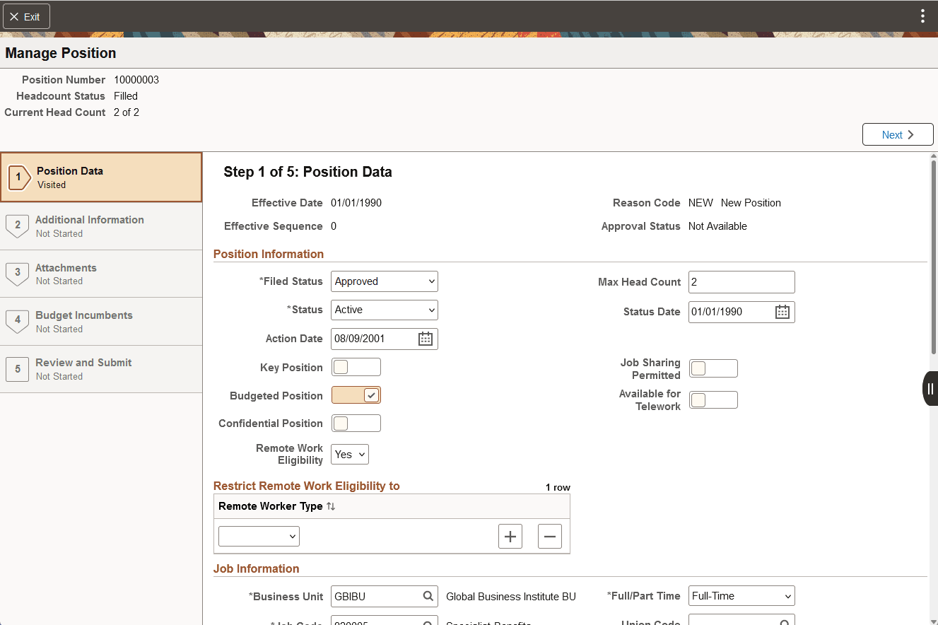

This example illustrates the layout for the Manage Position (and Create Position) pages.
Manage Position or Create Position page layout
Throughout this topic, the page illustrations show sections of the position management process without the context of the left panel activity guide step list. Even though the framework is not illustrated, remember that all steps appear within that framework.
Page Banner
The top of PeopleSoft pages is called the page banner.
  • When updating or viewing an existing position, the banner will display the component title Manage Position.
  • When creating a new position, the banner will display the component title Create Position.
Although the component name differs, the pages, fields, and controls are the same throughout these components unless otherwise specified.

The Review and Submit page does not display the Next button. Instead it displays a Submit button.
Submit button Submit button
This button appears on the Manage/Create Position - Review and Submit Page only.
Note: Your position data will not be saved to the system until you click the Submit button.

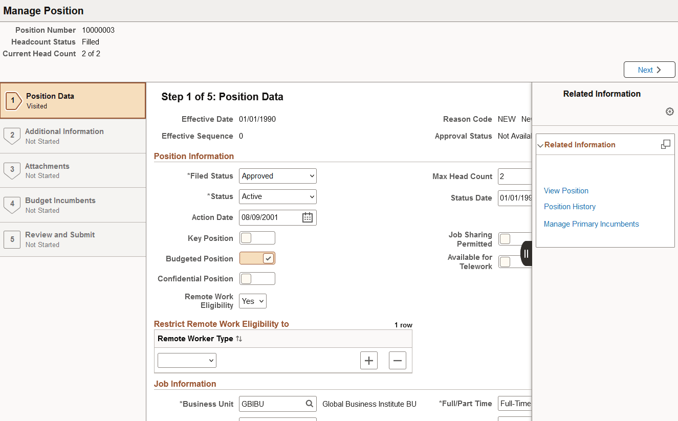

This example illustrates the supplementary panel options for the Manage Position pages.
Supplementary Panel for the Manage Position pages
Supplementary Panel tab (Supplementary Panel tab)
Click this tab to open the Related Information panel and view related content.
Personalize Related Content icon [Personalize RC (Related Content) icon]
This icon appears at the top of the Related Information panel. Click to open the Personalize page. This page lists the available related content so you can choose whether the Related Information panel shows or hides each item.
Display <related content item> in Modal Window icon (Display <Related Content Item> in Modal Window icon)
This icon appears at the top of each individual related content item in the Related Information panel. Click to expand the item to open a modal dialog with a larger interactive version of the content.
Related Information
For Manage Position, this supplementary pane includes the following links:
  • View Position
    Click this link to open the View Position Page in a new browser window and view historical records about this position you are viewing or updating.
  • Position History
    Click this link to open the Position History Page in a new browser window and view information on incumbents currently and previously assigned to this position.
  • Manage Primary Incumbents
    Click this link to open the Manage Primary Incumbents Page in a new browser window where you can identify and manage primary incumbents for this position.
    Note: This link is available when primary incumbents is enabled on the Position Data Installation Page.
Note: Users will need security access to these pages to view or update information.
For information on how to use the Related Information panel (also known as the Unified Related Content Analytics pane), see PeopleTools: Pivot Grid, “Working with Simplified Analytics,” Accessing Simplified Analytics.
Use the (Manage Position or Create Position) - Position Data page (POSITION_DATA_1_FL) to enter a description and job details about the position.
Navigation:
To access the Manage or Create Position pages, start at the Position Management Dashboard, select the Manage Position Tile, then do one of the following:
  • Click the + Add button from the Manage/Create Position search page to add a new position.
  • Enter search criteria on the Manage/Create Position search page and select a position. This will take you to the Position Details Page where you can:
    • Click the Clone button to enter the new position number and effective date.
    • Click the Add Row button to add a new effective dated row.
    • Click the Edit (pencil) button for a row to view and update existing information.
This page displays first by default, or click the Previous button or select the Position Data tab from the left panel navigation steps if you have moved to another page.
This example illustrates the fields and controls on the Position Data page (1 of 3).
Manage Position or Create Position - Position Data page (1 of 3)
This example illustrates the fields and controls on the Position Data page (2 of 3).
Manage Position or Create Position - Position Data page (2 of 3)
This example illustrates the fields and controls on the Position Data page (3 of 3).
Manage Position or Create Position - Position Data page (3 of 3)
Position Information
Filed Status
Indicate when the position is Approved, Frozen, or Proposed.
Max Head Count (maximum head count)
Enter the maximum head count allowed for this position. The default value is 1 because positions normally have a one-to-one relationship with employees (a position usually has one person assigned to it). However, if this position permits job sharing or can be assigned to more than one person, change the head count to the appropriate number.
Status Date
Indicate the date for the position status.
Key Position
Swipe this field to Yes if it is a key position.
Key positions are used when creating succession plans for your organization. For more information on succession plans, see PeopleSoft Human Resources Plan Careers and Successions: Setting Up Succession Planning.
Budgeted Position
This field is set on by default. If this position's status is Proposed or Frozen, deselect this field. Otherwise, leave it set to on for reporting purposes, so that the system knows that this is an approved position.
Confidential Position
Select if this position is confidential.
Job Sharing Permitted
Select if job sharing is permitted for this position. If job sharing is permitted, indicate the position's maximum head count (the maximum number of people who can share the position) in the Max Head Count field near the top of this page.
Available for Telework
(Classic) Select if this position typically allows workers to work remote.
Note: Selecting this option does not enable Fluid Remote Worker functionality. Use the Remote Work Eligibility field for Fluid functionality.
(USF) When creating a U.S. federal position, select this option to enable the Remote/Telework Type field in the US Federal Government section.
Note: (USF) Federal functionality is not tied to the Fluid Remote Worker feature. Selecting this check box does not enable Fluid Remote Worker functionality for Federal users.

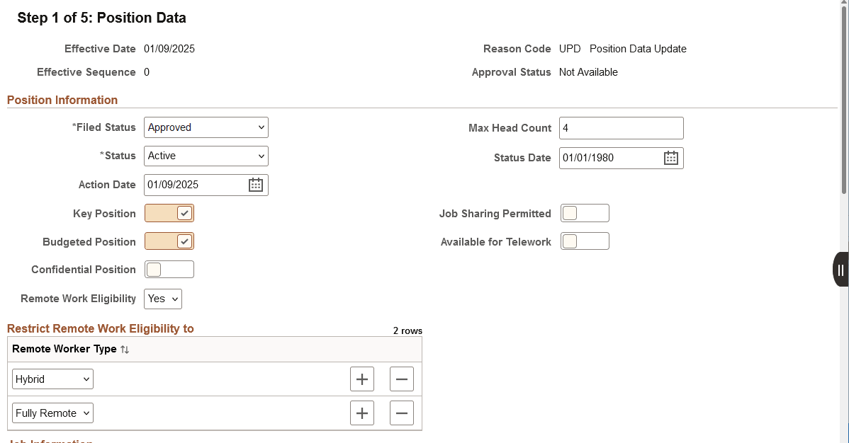

Important: Remote work eligibility can be defined for the job code as well as position. When remote work eligibility is defined for both the employee's position and job code, the position configuration always takes precedence.
Indicate if this position is eligible for remote work. Options include:
  • Blank: No eligibility is defined.
    When no eligibility is defined, employees in this position can be eligible for remote work types if the job code for an employee allows remote work or the override is enabled.
  • No: Select to indicate that this position is not eligible for remote work.
    Since eligibility is defined, employees in this position will be eligible for remote work only if the override is enabled. This setting overrides the job code setting.
  • Yes: Select this option to indicate that this position is eligible for remote work.
    The page displays the Restrict Remote Worker Eligibility to grid, where you can select remote worker types that are eligible with this position, which allows you to restrict the type of remote work employees can request.
    Note:By enabling remote worker eligibility, the system will display the Remote Worker tile in fluid for employees in this position who have been granted the Fluid Remote Worker Employee role.
To override the position remote worker eligibility settings, see the PeopleSoft Human Resources Administer Workforce: Remote Worker Configuration Page.
To understand the rules that drive remote worker eligibility and the values available to the employee, see PeopleSoft Human Resources Administer Workforce: Understanding Remote Work Eligibility for Employee Requests.
These videos provide an overview of the Fluid Remote Worker feature:
Video: Image Highlight, PeopleSoft HCM Update Image 40: Remote Worker
Video: PeopleSoft Remote Worker
Restrict Remote Work Eligibility to
This section is available when you select Yes for the Remote Work Eligibility field.
Remote Worker Type
Select which remote worker types are eligible with this position. Delivered Remote Worker Type translate values are Hybrid and Fully Remote. Employees in this position can select only from the values entered here. For example, if only Hybrid is defined for a position, only the Hybrid option will be available for the employee when entering a remote worker request.
Note: When you do not select remote worker types and this grid is left blank, all remote worker types by default are eligible and available for employees with this position.
See also PeopleSoft Human Resources Administer Workforce: Understanding Remote Work Eligibility for Employee Requests.
This video provides an overview of the PeopleSoft Insights feature:
Video: Image Highlights, PeopleSoft HCM Update Image 51: Restrict Remote Worker Type by Job Code/Position and Limit Retroactive Requests
Job Information
Business Unit
Enter the business unit for the position.
Job Code
Select the job code that is associated with this position. The job title associated with this job code is defaulted into the (position) title field when a job code is selected.
(E&G) In Education and Government systems, you can select only job codes where the Used by Position Management check box is selected on the Application Fundamentals: Evaluation Criteria Page in the Job Code Table component.
Regular/Temporary
The system enters a default value of Regular for a new position. If the position is temporary, select Temporary from the available options.
Note: (USF) Federal users: If the position is Temporary, enter a date in the Not To Exceed Date field on the PeopleSoft Human Resources Administer Workforce: Request Data - Data Control Page page.
Regular Shift
If your organization assign shifts to positions, select a regular shift code.
Title
This field displays a title for the selected position. This field is defaulted from the title associated with the job code. You can override this default value by typing in a new title.
Note: If you have Update Incumbents selected on the Manage/Create Position - Budget Incumbents Page, modifications to the position title will be reflected on each incumbents job data as a change in the employee's job title. This job title can be seen on the Job Information page of the Job Data component.
Full/Part Time (full-time or part-time)
The system enters a default value of Full-Time for a new position. If the position is part-time, select Part-Time from the available options.
Short Title
Enter a short title of the position. When you select a job code on the Job Information page, this field displays the short title associated with that job code. You can override the default value.
Union Code
Enter the union code for the position.
Description
Enter a detailed position description, if required, for this position.
Work Location
Reg Region (regulatory region)
Enter a regulatory region for the position.
Department
Select the department that this position is associated with from the list of available options.
Location
Select the location that this position is associated with from the list of available options.
Reports To
To establish reporting relationships, select the position number that this position reports to from the list of available options. The position title will appear after the field. Click the View Current Incumbents link next to this field to view persons assigned to this reports to position.
If this is the top position record, enter the position's number here. For example, in the CEO's position record, enter the CEO's position number in this field.
This link is available when you have populated the Reports To field.
Click this link to open the Current Incumbents Page and view incumbents of the reports to position. If no incumbent exist for this reports to position, clicking the link will create a message stating there are no incumbents,
Supervisor Lvl (supervisor level)
Select the supervisor level, if applicable, associated with the position from the list of available options.
Company
When you select a department this field displays the associated company and is unavailable for entry. If the department that you select has no associated company, select one from the list of available options.
Dot-Line (dotted-line)
If there is a dotted line reporting relationship to another position, select that position number from the list of available options.
Security Clearance
Select a value for a type of security clearance that can be held by a person.
Salary Plan Information
Salary Admin Plan (salary administration plan)
Select the salary plan associated with the position from the list of available options. The value that you select appears on the Job Data component when you assign a new employee to a position.
Standard Hours
Enter the standard hours worked in the associated Work Period for this position. For example, if the Work Period is Weekly, the Standard Hours might be 40.00.
Work Period
Select the work period associated with this position. The work period is the smallest unit of time that employers use to communicate working hours to their employees.
If you select a W (Weekly) work period, enter the hours worked per day in the fields provided.
Grade
Select the grade associated with the position from the list of available options.
Step
Select the step associated with the position from the list of available options.
Specific Information
Mail Drop ID and Telephone
Enter the mail drop ID and work phone number assigned to this position, if applicable.
Health Certificate
Select the health certificate required for this position from the list of available options, if applicable.
Signature Authority
Select the signature authority assigned to this position from the list of available options, if applicable.
(USA) United States
FLSA Status (Fair Labor Standards Act status)
Determine the appropriate coverage under the Fair Labor Standards Act, and select either Administrative, Computer Employee, Executive, Highly Compensated Employees, Management, No FLSA Required, Nonexempt, Nonexempt Alt Overtime, Outside Salesperson, or Professional.
Bargaining Unit
Enter the bargaining unit associated with this position.
(DEU) Germany
From Grade/Step, From Grade, and Step or To Grade/Step, To Grade, and Step
Enter the salary grade and step from which the salary range begins and which the salary range ends for this position.
(DEU) German Public Sector
Service Class Group
Enter a service class group. Valid values are:
  • 1 – Without University Degree (Mit Hochschulabschluß)
  • 2 – With University Degree (Ohne Hochschulabschluß)
  • ED – Simple Service (einfacher Dienst)
  • GD Upper Service (gehobener Dienst)
  • HD – Supreme Service (höherer Dienst)
  • MD – Midrange Service (Mittlerer Dienst)
Allowance
Indicate whether this position is eligible for additional allowance.
For customers using Position Management, a change to the Service Class Group field or a change to the Allowance selection will not automatically be updated to Job. The Update Incumbent functionality only covers a few select fields.
(AUS) Australia
Package Template ID
Select a salary package template ID.
Package Rule ID
Select a salary package rule ID.
(CAN) Canada
Employment/Labour Std Status (employment and labour standards status)
Choose whether this position is Exempt or Non-Exempt according to the provincial Employment Standards Act or Labour Standards Act.
The default value is Non-Exempt until you select a job code, at which point the default value comes from the job code table.
The value that you select becomes the default value for the Employment/Labour Std Status field on worker job records that are associated with this position.

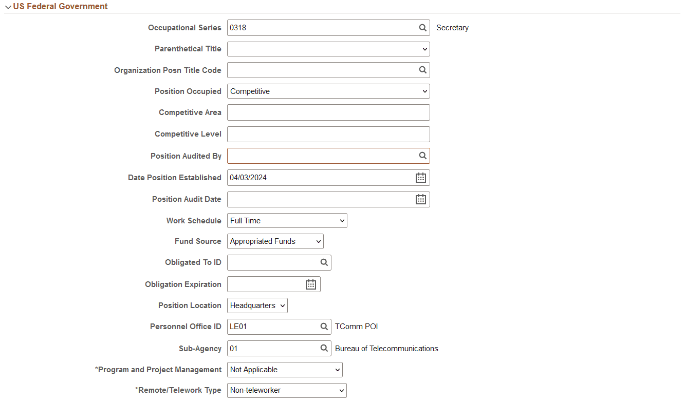

(USF) US Federal Government
These fields are available when you work in a federalized (U.S. Federal) database:
This example illustrates the fields and controls on the fluid Position Data page, US Federal Government section (1 of 2).
Manage Position or Create Position - Position Data page, US Federal Government section (1 of 2)
This example illustrates the fields and controls on the fluid Position Data page, US Federal Government section (2 of 2).
Manage Position or Create Position - Position Data page, US Federal Government section (2 of 2)
Occupational Series
Enter the occupational series that is associated with this position.
Parenthetical Title
Enter the parenthetical designation of the position. Select from Data Transcribing, Office Automation, Stenography, or Typing.
Organization Posn Title Code
Enter an official title for this position. These values are defined on the Official Position Titles Page.
Position Occupied
Identify the type of appointment which can occupy the position. Values are Competitive, Excepted, SES (senior executive service) Career Reserved, and SES General. This is a CPDF reported field.
Work Schedule
Select the work schedule for this position.
Fund Source
Select from Appropriated Funds, External Funds, Non-Appropriated Funds, or Other Funds.
Position Location
Indicate if this position is located at Headquarters or in the Field.
Personnel Office ID
Select the identification number for the personnel office of your agency.
Sub Agency
Select the sub-agency to which this position belongs.
Program and Project Management
Note: This field is available for position rows with the effective date of August 2, 2023 or later.
Specify the managerial position for this position, which can be used for reporting to the OPF. When you associate a new job code to the position, the value from the job code will be provided by default, if a value exists. If there is no value assigned at the job code, Not Applicable will be provided as the default value. You can override any of these values at this level, however, you must provide a valid value in order to save the USF position successfully.
Note: This field is available for position rows with the effective date of September 1, 2023 or later and editable when the Available for Telework option is selected on this page (Position Data page).
Identify the remote worker/teleworker agreement type for this position, which can be used for reporting to the OPF. You must enter a valid value in order to save the USF position successfully.

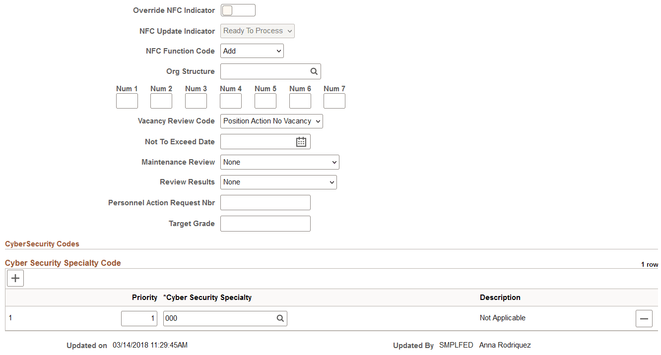

Override NFC Indicator
Select to override the value in the NFC Update Indicator field.
Displays the status of the transaction in relation to NFC, as maintained by the user or system. Options in this field include:
  • In Process – This job code has been run through the export program and will be sent to NFC.
  • Not Ready to Process – User intends to exclude this position from export to NFC.
  • Other – Status maintained by system user.
  • Ready To Process – User intends to include this position in the next NFC export.
  • SINQ Error – This position has not successfully passed NFC's PINE Edits and needs correction.
NFC Function Code
Identifies the task to be performed by NFC on a primary record. Options in this field include Add, Change, Delete/Restore, Inactivate, and Reactivate.
Cyber Security Speciality
Enter a cyber security specialty code that should be associated with this position. Select the specialty area where the work of the position or incumbent is predominantly done. These codes are maintained on the Cyber Security Specialty USF Page.
Note: Cyber Security Codes for Position is stored in a new child record POS_FED_CYB_CD. Data in POSITION_DATA. GVT_CYBER_SEC_CD is marked obsolete and should not be used. Add button and Priority fields are visible only for row with Effective Date on or after December 1st, 2016.

Use the (Manage Position or Create Position) - Additional Information page (POSITION_DATA_5_FL) to enter Education and Government information that is specific to the position.
Navigation:
  • Click the + Add button from the Manage/Create Position search page to create a new position.
After accessing the Manage Position component, click the Previous or Next button or select the Additional Information tab from the left panel navigation steps.
This example illustrates the fields and controls on the Additional Information page.
Manage Position or Create Position - Additional Information page
(E&G) Education and Government
Position Pool ID
If appropriate, select a position pool ID from the list of available options. This code maps to the position pool with which this position should be budgeted in Commitment Accounting.
Position pools enable you to group related positions together for budgeting purposes. For instance, you could group all positions related to your PeopleSoft HCM implementation project in a single position pool and then assign a budget to that pool.
Pre-Encumbrance Indicator
Indicate if you want the position to encumber immediately. Values include: Encumber Immediately, Encumber on Requisition, or No Encumbrance.
Encumber Salary Option
If you encumber salaries using Manage Commitment Accounting, select an encumber salary option. The system uses the option that you select here to determine salary when it encumbers the salaries of vacant positions.
Encumber Salary Amount
If you select User Specified Amount as the Encumber Salary Option, enter the salary amount to encumber.
Classified Indicator
Associate the position with an FTE (full time equivalents classification) that you established on the Department Budget FTE page.
When you hire a worker into a position in the Workforce Administration menu, the system displays the FTE data tied to the position in the Job Data pages for the worker.
FTE (full time equivalents)
Enter the FTE value for this position to be used for defining an FTE budget in Manage Commitment Accounting.
Adds to FTE Actual Count
Swipe to Yes to include this position when processing FTE edits for budgeting purposes. Swipe to No if you don't want to include this position when processing FTE edits.
Important:
The FTE fields are provided by default to the employee’s Job record when Education and Government has been enabled in the system. Review the (E&G) Changing FTE Data documentation for considerations you should take when updating any fields that impact the FTE value of the position or a person’s job.
Use the (Manage Position or Create Position) - Attachments page (POSITION_ATTACH_FL) to add or view attachments for a position.
Navigation:
After accessing the Manage Position component (by navigating as specified in either of the previous bullets), click the Previous or Next button or select the Attachments tab from the left panel navigation steps.
This example illustrates the fields and controls on the Attachments page.
Manage Position - Attachments page
Use this section to manage attachments by uploading, deleting, or updating attachments using fluid. Attachments are not accessible from the classic pages. When a user submits position for approval, all attachments on this page will be sent with the request.
Add Attachment button Add Attachment button
Click this button to access the File Attachment page and upload files.
Attachments and Description
Select the link to download and view the attachment. Enter a description, or the field will use the attachment file name as the description upon saving the page, which you can overwrite.
Delete button (Delete) button
Click this button to remove an attachment from this position.
Managers use fluid Approvals to view position requests using the Pending Approvals - Create (or Manage or Update) Position Page.
The following video provides an overview and demonstration of the Fluid Attachment framework:
Video: PeopleSoft Fluid HCM Attachments
Use the (Manage Position or Create Position) - Budget Incumbents page (POSITION_DATA_6_FL) to review the position's current budget and incumbents.
Navigation:
To access the Manage Position pages start at the Position Management Dashboard, select the Manage Position Tile, then do one of the following:
    • Click the Add Rowbutton to add a new effective dated row.
After accessing the Manage Position component, click the Previous or Next button or select the Budget Incumbents tab from the left panel navigation steps.
This example illustrates the fields and controls on the Budget Incumbents page.
Manage Position or Create Position - Budget Incumbents page
Current Budget
The Current Budget group box displays the position'sHead Count,Current Budgeted FTE, and Amount.
Incumbents
Update Incumbents
Swipe to Yes to have the system automatically update incumbent job data on the Job Data component. The default setting for new positions is No. A warning appears if Yes is selected when you save a new position.
Note: If you use Guided Self-Service to update position data, be sure that the Update Incumbents check box is set to Yes. This configuration is necessary so that the position data updates made through Guided Self-Service flow through to incumbent job records. It is safe to ignore the warning that appears if the Update Incumbents check box is selected when you save a new position. For more information, see PeopleSoft eProfile Manager Desktop: Understanding Updates to Position Data in the Guided Self-Service documentation.
If the employee record is using position data and Update Incumbents is set to Yes, then you can also check Include Salary Plan/Grade, which makes the Salary Plan, Grade, and Step fields controlled by the position and cannot be modified in Job Data.
If Update Incumbents is set to No, then the Include Salary Plan/Grade field is unavailable.
Note: (USF) Federal users don't currently use this field.
Swipe to Yes to include the salary plan and grade in the incumbents update. When set to Yes, then salary plan and grade are included in the incumbent update. When you set Include Salary Plan/Grade, to No then the salary plan and grade are not included in the incumbent update.
Note: If the position data military Rank field is populated, then the Include Salary Plan/Grade field is unavailable for data entry.
Update for Title Change
Swipe to Yes to make position title changes trigger the update incumbent process. If Yes is selected when you create a new position data row with a reason of TTL (Title Change) and a change to the data in the Title field, then the system creates a corresponding row in the incumbents’ Job Data records. The new job data row has the action code Position Change and the Action Reason Title Change.
Note that the job title is not actually stored on the job record. The job title that appears next to the Position Number field on the Work Location page is pulled from the position data record based on the effective date of the job data row.
Current Incumbents
After you assign an employee to the position, this group box displays the incumbent's employee information and a Job Data link.
Primary incumbent icon (Primary Incumbent icon)
This icon is available when Manage Primary Incumbents is enabled on the Position Data Installation Page and a person has been defined as the primary incumbent.
Indicates that this person is the current primary incumbent.
To manage primary incumbents for a position see the Managing Primary Incumbent Information for a Position topic.
Job Data
Select this link to open a new browser window and access the Job Data component for this employee. From here you can review the employee’s job data.
When Fluid Job Data is not enabled, the system will direct the user to the classic Job Data pages (see the PeopleSoft Human Resources Administer Workforce: (Classic) Adding Organizational Instances documentation for viewing job data).
When Fluid Job Data is enabled on the PeopleSoft Human Resources Administer Workforce: Person and Job Installation - Job Data Page, the system will open the PeopleSoft Human Resources Administer Workforce: Job Actions Summary Page in fluid, based on the access of the user.
Use the (Manage Position or Create Position) - Review and Submit page (POSITION_SUMM_FL) to review a summary of the changes to this position and submit your position data for approvals.
Navigation:
After accessing the Manage Position component, click the Next button or select the Review and Submit tab from the left panel navigation steps.
This example illustrates the fields and controls on the Manage Position - Review and Submit page when you are updating an existing position.
This example illustrates the fields and controls on the Create Position - Review and Submit page when you are creating a new position.
The Submit button appears on this page only.
Click this button to save your position. If approvals are required for updating or creating positions, the request will be sent to the approving managers, where they will use the Pending Approvals - Create (or Manage or Update) Position Page to take action on a position request.
Note: Your position data will not be saved until you click the Submit button. If you exit out of the Manage Position pages without submitting your changes, your data will be discarded.
When a position has been successfully submitted, the system will display the Position Confirmation Page.
Summary Of Changes
This section is available when you are viewing or updating an existing position.
Use this section to review changes you have made to a position. The page will display the proposed value side-by-side with the current value for the changed fields.

This section is available when you are creating a new position.
Use this section to review key values you have entered for this position.
Use the Position Confirmation page (POS_SUB_CNF_FL) to confirm that your position updates have been submitted.
Navigation:
Click the Submit button on the Manage/Create Position - Review and Submit Page.
This example illustrates the fields and controls on the Position Confirmation page when approvals are turned off.
Position Confirmation Page When Approvals are Not Required
This example illustrates the fields and controls on the Position Confirmation page when approvals are required.
When approvals are configured and enabled on the Position Data Installation Page, the message at the top of the page will indicate that it was submit for approvals and the approval status fields will show the approval status and approval chain of the request. The position administrator can enable approvals when creating a new position or for editing an existing position.
Go to Position Details button
Click this button to go to the Position Details Page for this position.
Go to Manage/Create Position button
Click this button to return to the search page and create another position or look up an existing position.
Go to Position Management button
Click this button to go to the Position Management Dashboard where you can set up or view summaries of Position Management data.
Approving Managers will use the Pending Approvals - Create (or Manage or Update) Position Page to review and respond to position transaction requests.
View Position Page
Use the View Position page (POSITION_VIEW_FL) to view a complete summary of the position details by effective date.
Navigation:
This example illustrates the View Position page (1 of 2).
This example illustrates the View Position page (2 of 2).
<< Previous and Next >> buttons
Click these buttons to scroll through all the effective dated rows for this position.
Fields and data found in this page map to those fields located on the various Manage Position pages, as listed is this documentation:
