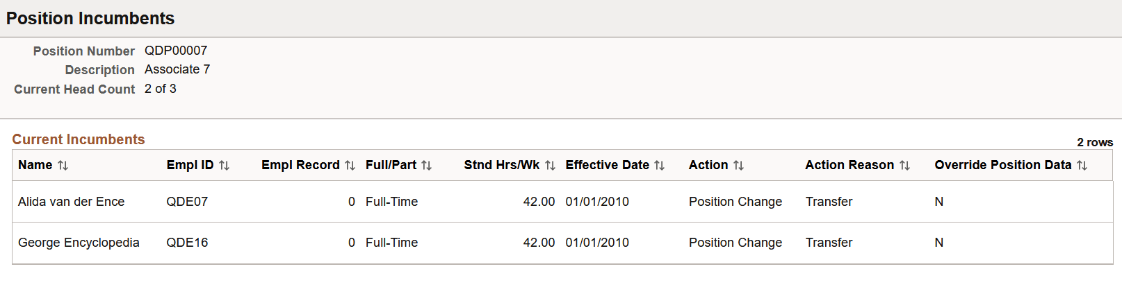

Position Incumbents Page
POSN_INCUM_ALL_FL
View a list of incumbents associated with a position.

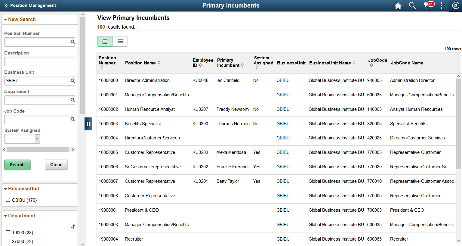

Click the tile to open the View Primary Incumbents (Search) Page and search for a position.
Important:
You must have Manage Primary Incumbent enabled on the Position Data Installation Page to be able to access this tile and pages.
Use the View Primary Incumbents search page to search for a position for which you want to manage primary incumbent information.
Navigation:
To grant users Manage Primary Incumbent functionality in fluid, you must assign the Primary Incumbent Admin role to the administrator managing primary incumbents.
This example illustrates the fields and controls on the View Primary Incumbents (Search) page.
Important:
After you first enable the Manage Primary Incumbent functionality, you will need to run the one-time Sync Incumbents (POSN_PRI_SYNC) process (PeopleTools, and then Process Scheduler, and then Schedule Process Requests) to have the system assign a primary incumbent for every position in the database.
Left Search/Facet Panel
Use this section to enter criteria and narrow your search results.
Field or Control Description
New Search
This section appears by default when you first access the page.
You can use the following search criteria in the left collapsible panel to locate a specific existing position:
  • Position Number
  • Description
  • Business Unit
  • Department
  • Job Code
  • System Assigned:
    • No — Positions where you have manually assigned a primary incumbent.
    • Not Applicable — Positions that have not been assigned a primary incumbent.
    • Yes — Positions where the system assigned a primary incumbent.
Enter the search criteria and click Search. Partial word searches are not valid.
After you enter the initial search criteria, the main panel will display the results, and the search/facet panel will display addition facets that correspond to the positions listed in the search results.

View Primary Incumbents Panel
Search results appear in the main panel of the page. Use this section to view valid positions from your search results.
Grid view icon (Grid view) or List view icon (List view)
Click either the Grid icon or List icon to display data represented by the icon type. Grid view is the default display.
Position Number and Position Name
Displays the position number and name of those positions that meet the search criteria.
Employee ID and Primary Incumbent
Displays the ID and name of the employee who has been assigned as the primary incumbent for this position. When there is no current primary incumbent, these fields will be blank.
System Assigned
Displays the following values:
  • Yes: Indicates that system automatically assigned this incumbent to this position.
  • No; Indicates that you manually assigned this incumbent to this position.
  • <Blank>: Indicates that there are no current incumbents assigned to this position.
The remaining columns on this page help identify the job of this position.
Select a row to access the Manage Primary Incumbents Page and view or edit incumbent data and assigned primary incumbent details.

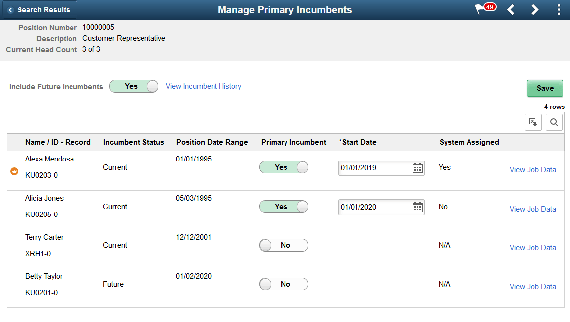

Use the Manage Primary Incumbents page (POSN_PRI_INCUMB_FL) to review position incumbent data and assign a primary incumbent for a position.
Navigation:
Then select a position from the View Primary Incumbents (Search) Page search results.
This example illustrates the fields and controls on the Manage Primary Incumbents page.
Important:
After you first enable the Manage Primary Incumbent functionality, you will need to run the one-time Sync Incumbents (POSN_PRI_SYNC) process to have the system assign a primary incumbent for every position in the database.
The system will not submit an approval request when a primary incumbent is not defined.
This page shows a list of incumbents assigned to this position, sorted first by primary incumbent and then by those identified as future primary incumbents. If no current incumbents exist for this position, the list will display the message that there are no current incumbents.
Include Future Incumbents
Swipe to Yes to have the list display any employees that have been assigned to this position with a future effective date.
  • If no future incumbents exist, the system will issue a message that there are no future incumbents for this position.
  • If future incumbents exist, they will appear in the list with an Incumbent Status of Future.
Swipe to No to show only those employees who are current incumbents of this position.
View Incumbent History link
Click this link to access the Primary Incumbent History Page and view previous primary incumbents for this position. If no previous primary incumbents exist, a message will display indicating that there is no primary incumbent history to view.
Primary incumbent icon (Primary Incumbent icon)
This crown icon indicates who is the current primary incumbent for this position.
Note: There can be only one primary incumbent at a time. Use the Start Date on this page to indicate when a person should assume the role of the primary incumbent. The person with the most current start date is considered the primary incumbent. If the current primary incumbent leaves the position, the system will use the selection method defined on the Position Data Installation Page to auto assign the next primary incumbent.
When a primary incumbent leaves the position, the system will send a push notification to the position administrator to review this page and make changes if necessary.
Name / ID - Record
Displays the name, ID, and employment record number of the incumbents for this position. The primary incumbent will also appear at the top of the list. Any other incumbents that are marked as a primary incumbent for a future date will appear under the current primary incumbent.
Incumbent Status
Indicates if this is a current or future incumbent of this position.
Note: Run the Nightly Refresh Primary Incumb (POSN_PRI_AE) process (PeopleTools, and then Process Scheduler, and then Schedule Process Requests) manually or on a regularly scheduled basis to ensure all future dated rows that have become current are updated.
Position Date Range
Shows when the person entered this position.
If a person was previously in this position and has since returned to this position, the date fields will show the initial date range (start and end dates) this person was in this position. It does not show the date he or she reentered this position.
Primary Incumbent
Swipe the Primary Incumbent field to Yes to indicate that this person should be defined as either the current or future incumbent.
When you select Yes, you are required to enter the start date that this person became or will become the primary incumbent.
Note: Only one current primary incumbent is allowed at a time, but you can indicate several individuals for a future date.
Start Date
Enter the date the person became or will become the primary incumbent. You cannot enter a date that precedes the date of the current primary incumbent or the date that this person enters the position.
When primary incumbents are identified, the page will sort the incumbents first by the Start Date value.
Note: Only one primary incumbent is allowed at a time, but you can indicate several individuals for the future role of primary incumbent. When the start date for a person becomes current, he or she will be assigned as the primary incumbent, and the previous primary incumbent will return to the incumbent list. To see the history of who has held the position of primary incumbent, select the View Incumbent History link at the top of the page.
System Assigned
Displays how the person was assigned as a primary incumbent. Valid values are:
    Auto assignments may occur under the following conditions:
    • You ran the Sync Incumbents (POSN_PRI_SYC) process to have the system assign a primary incumbent to positions that have incumbents but no primary assigned.
    • The current primary incumbent has moved out of this position and this person was the next in line based on the auto assign logic defined on the Position Data Installation Page.
    • You assign a person to a position that does not currently have a primary incumbent. This person will become the primary incumbent, even if another incumbent already exists.
    If a person has been marked as a future primary incumbent and the nightly build identifies the Start Date value as current, the system will assigned a value of No, since you manually identifies this person as a primary incumbent.
  • N/A: Indicates that this person has not been assigned as a current or future primary incumbent for this position.
View Job Data
Click this link to open a new browser window and view the person’s Job Data.
When Fluid Job Data is not enabled, the system will direct the user to the classic Job Data pages (see the PeopleSoft Human Resources Administer Workforce: (Classic) Adding Organizational Instances documentation for viewing job data).
When Fluid Job Data is enabled on the PeopleSoft Human Resources Administer Workforce: Person and Job Installation - Job Data Page, the system will open the PeopleSoft Human Resources Administer Workforce: Job Actions Summary Page in fluid, based on the access of the user.
To return to the Manage Primary Incumbents page, select the appropriate browser window.
Save
Click to save any changes you made to this page. You must select at least one primary incumbent to save the page. This can be future dated. Note that future dated primary incumbents will not appear in the Primary Incumbent field on the View Primary Incumbents (Search) Page.
The HR and position primary incumbent administrators will be notified of any changes to this page.

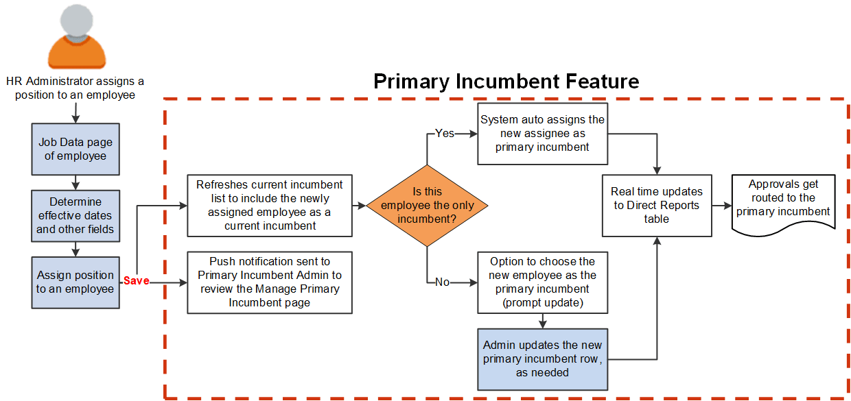

—Scenario 1: Employee Assigned to a Position—
Job data Actions that may result in an employee getting assigned to a position may include a Transfer, Promotion, Location Change, Department Change, and so forth.
This example demonstrates what happens to the primary incumbent flow when an employee is assigned to a position.
Primary incumbent impact when employee assigned to a position
When an HR administrator updates an employee’s Job Data, which assigns an employee to a position, the system performs the following steps:
  1. Sends the primary incumbent administrator a push notification informing him or her to review the Manage Primary Incumbents Page.
  2. Updates the incumbent list for the position to include the employee that was just assigned to the position.
  3. Checks to see if the position to which the employee was just assigned has any incumbents.
    • If this employee is the only incumbent, the system automatically assigns this person as the primary incumbent.
    • If this employee is not the only incumbent, the primary incumbent administrator can review and update the Manage Primary Incumbent page as needed.
  4. The Direct Reports table is updated to reflect the new primary incumbent, if any. Any new approval requests will be sent to the current primary incumbent.

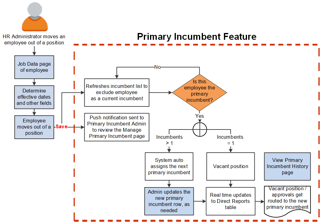

—Scenario 2: Employee Moves Out of a Position—
Job data Actions and reasons that may result in an employee moving out of a position may include a Transfer, Promotion, Location Change, Department Change, Death, Retirement with Pay, Retirement, Termination, Terminated with Pay, Retirement-Pension Administration, and so forth.
This example demonstrates what happens to the primary incumbent flow when an employee moves out of a position.
Primary incumbent impact when employee moves out of a position
When an HR administrator updates an employee’s Job Data, which removes the employee from a position, the system performs the following steps:
  2. Updates the incumbent list for the position to exclude the employee that was just removed from the position.
  3. Checks to see if the employee being removed from the incumbent list is the primary incumbent.
    • If this employee is not the primary incumbent, nothing needs to happen.
    • If this employee is the primary incumbent, the system determines how many employees are in the position prior to this employee’s removal.
      – If there is more than one incumbent, the system uses the auto assignment selection method, as defined on the Position Data Installation Page, to assign the next primary incumbent. The primary incumbent administrator can review and update the Manage Primary Incumbent page as needed.
      – If there is only the one incumbent, the system will mark this position as a vacant position and no primary incumbent is assigned. The primary incumbent administrator can view the Primary Incumbent History Page to see that the employee that left the position has been moved to history.
  4. The Direct Reports table is updated to reflect the new primary incumbent information. Any new approval requests will be sent to the new primary incumbent, if any.

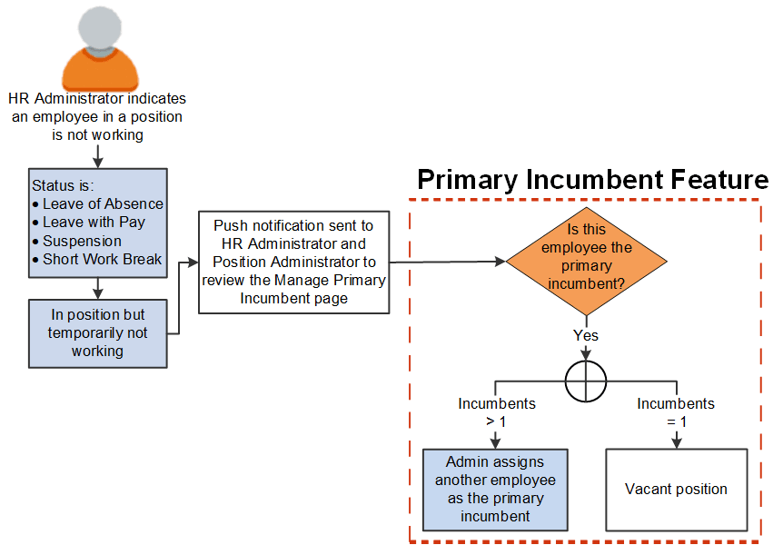

—Scenario 3: Employee is Associated with a Position but Temporarily Not Working—
Job data Actions and reasons that may result in an employee temporarily not working may include a Leave of Absence, Leave with Pay, Suspension, Short Work Break, and so forth.
This example demonstrates what happens to the primary incumbent flow when an employee is in a position but temporarily is not working.
Primary incumbent impact when employee in a position is temporarily not working
When an HR administrator updates an employee’s Job Data in such a way that the employee is still in a position but is temporarily not working (i.e.- Leave of Absence, Leave with Pay, Suspension, or Short Work Break), the system performs the following steps:
  1. Sends the primary incumbent administrator a push notification informing them to review the Manage Primary Incumbents Page.
  2. Checks to see if the employee is the primary incumbent.
    • If this employee is the primary incumbent, the system determines how many employees are in the position.
      – If there is more than one incumbent, the primary incumbent administrator should review and update the Manage Primary Incumbent page to assign a new primary incumbent.
Use the Position Incumbents page (POSN_INCUM_ALL_FL) to view a list of incumbents associated with a position.
Navigation:
Select one of the following links for a position within the Position Details grid of the Position Management Insights Dashboard.
  • Incumbents List link
  • "Reports To" Incumbents List link
This example illustrates the fields and controls on the Position Incumbents page.
