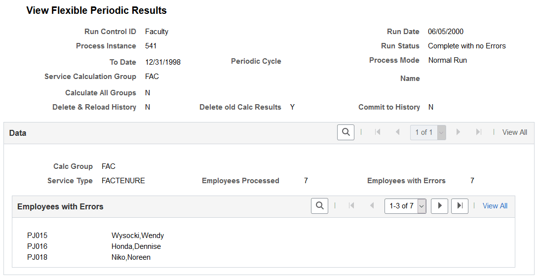

View Flexible Periodic Results Page or Review Tenure Run Results
Use the View Flexible Periodic Results or Review Tenure Run Results page (EG_PRDIC_RSLTS) to view the results of the tenure calculation process, such as the employee's tenure status, what was processed, and whether the run was successful or not.
This information is temporary and changes when you run the calculation process in Update to History mode.
Navigation:
  • Workforce Administration, and then Flexible Service EG, and then View Flexible Periodic Results, and then View Flexible Periodic Results
  • Workforce Development, and then Faculty Events, and then Calculate Tenure, and then Review Tenure Run Results, and then Review Tenure Run Results
This example illustrates the fields on the View Flexible Periodic Results page.
Field or Control Description
Run Date
Displays the date that the calculation process ran.
Process Instance
Displays the calculation process instance number.
Run Status
Displays basic information about the calculation process, including whether the system encountered problems.
To Date
Displays the end date of the period covered in this calculation process.
Periodic Cycle
Displays the periodic cycle for this run control ID.
Process Mode
Displays the period processing mode from the Perform Tenure Calculations page (for track faculty events) or the Service Calc page (for track flexible service).
Service Calculation Group
Displays the calculation group included in this calculation process run.
Name
Displays the employee's ID number if you are running the calculation process for an individual employee.
Calculate All Groups
Displays N (no).
Delete & Reload History, Delete old Calc Results, and Commit to History
Displays Y (yes) or N (no), depending on the period processing mode that you selected.
Service Type
Displays the service type included in the calculation process.
Employees Processed
Displays the number of employees processed during this calculation.
Employees with Errors
Displays the number of employee records the system designated as erroneous during the calculation process.

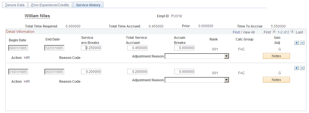

Service History Page
Use the Service History page (EG_SVC_HIST) to view the service history for employees and enter service adjustments and codes.
Maintain adjustment action and reason codes on the HR Action/Category page.
Navigation:
Workforce Development, and then Faculty Events, and then Calculate Tenure, and then Create Tenure Data, and then Service History
This example illustrates the fields and controls on the Service History page.
Total Time Required
Displays the total number of service years required from the Tenure Data page.
Total Time Accrued
Displays the number of years accrued toward tenure.
Prior
Displays tenure credits for prior experience from the Prior Experience/Credits page.
Time to Accrue
Displays the remaining number of years before tenure is granted.
Begin Date and End Date
Displays the beginning and ending dates of the tenure in this calculation process. You cannot change these dates if the service history for the period already exists.
Service w/o Breaks (service without breaks)
Displays the percent of FTE accrued without service breaks.
Total Service Accrued
Displays the total percentage of services accrued. This field increases incrementally when you run the calculation process.
Accum Breaks (accumulated breaks)
Displays the accumulated service breaks.
Rank
Displays the rank for the calculation group.
Calc Group (calculation group)
Displays the calculation group, such as FAC.
Gen/Adj (generated or adjustment)
If the calculation process creates the line, this field displays G (generated). If it is entered online, it displays A (adjustment).
Action
Displays the job action, such as LOA (leave of absence), occurring within the requested period.
Reason Code
Displays the reason code associated with the action that makes it count toward accrued tenure.
Adjustment Reason
Select the reason tenure is added to the total tenure accrued. Use this field to adjust tenure accrual history records. You can add a new row or adjust an existing row. You can also modify a record generated by the system. However, running a calculation process in Delete_Rebuild History mode purges the record.
Notes
Select this button to display notes regarding the employee's tenure history.
