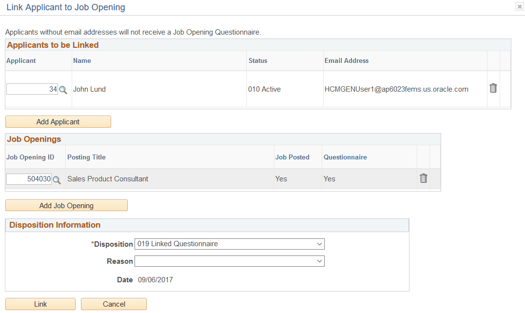

Link Applicant to Job Opening Page
Use the Link Applicant to Job Opening page (HRS_GACT_RCM_STS) to link an applicant to a job opening.

This example illustrates the Link to Job Opening page.
Applicants To Be Linked
Field or Control Description
Applicant
Displays the applicant ID for the applicant who is being linked to the job opening.
This grid is prepopulated with the applicants that were selected when you initiated the Link Applicant to Job action. If you click the Add Applicant button, a new row is added to the grid, and you identify the applicant by entering the applicant ID in this field.
Name
Displays the name of the applicant who is being linked to the job opening.
Status
Displays the status of the applicant who is being linked to the job opening, enabling users to confirm that the applicant is active.
Email Address
Displays the applicant’s email address.
If an applicant is linked to a job opening that includes a questionnaire, the system sends the applicant an email notification requesting that the applicant reapply for the job. Reapplying enables the applicant to answer the questionnaire.
Note: Applicants without email addresses cannot receive email notifications. Therefore, when linking applicants to job openings with questionnaires, recruiters should consider other ways to notify applicants who do not have email addresses.
Add Applicant
Click this button to add a blank row to the Applicants to be Linked grid, then enter the Applicant ID to identify the applicant.
Job Openings
Job Opening ID
Select the job openings to which you want to link the applicant. If you access this page from the Applicant Search tab of the Manage Job Opening page, the system creates a row for the current job opening ID.
Security prevents you from adding any job openings that you do not already have permission to access.
See Job Opening Security.
Posting Title
Displays the primary posting title of the job opening.
Job Posted
Displays Yes if there is an active posting for the job opening or No if there is not.
The system displays a warning if you link applicants to unposted job openings. You can choose whether to continue or cancel.
Note: Notifications asking applicants to reapply to job openings with questionnaires include a link to the Candidate Gateway job posting. Therefore, if the job is not posted, no email is sent.
Questionnaire
Displays Yes if the job opening includes a Skills and/or Employment questionnaire or No if it does not. A job opening has a questionnaire if it is associated with any questions, regardless of whether the questions are used in screening.
When you link an applicant to a posted job opening with a Skills and/or Employment questionnaire, the system sends the applicant an email with directions for signing on to Candidate Gateway and submitting an application for the job. The questionnaire is embedded in the online application.
When linking to job openings with questionnaires, pay particular attention to:
  • Whether the applicants have email addresses so that they can receive the notification.
  • Whether the job opening is posted. When the job is not posted, no email is sent.
  • The disposition you assign for the linked job opening: use disposition 019 (Linked Questionnaire).
Disposition Information
Use this group box to enter the initial disposition for the applicants with regard to the job openings to which they are being linked.
Disposition and Reason
Select a disposition and an optional reason to assign for all linkages that you are creating.
The default disposition is the one with the identifier 015. The delivered label for this disposition is 015 Linked.
If you are linking applicants to a job that has a questionnaire, change the disposition to status code 019. The delivered label for this disposition is 019 Linked Questionnaire. This disposition indicates that the application does not include the job opening’s questionnaire, which can only be completed when the applicant applies using Candidate Gateway. If the applicant reapplies based on the invitation that the system sends, the new application remains separate from the original linked application, and both the applicant and the recruiter see two separate applications for the job opening.
Using the 019 Linked Questionnaire disposition for a job opening that doesn't have a questionnaire, or using any other disposition for a job opening that does have a questionnaire, causes the system to issue a warning when you click the Link button.
Date
Displays the current date. The applicant is linked to the job as of this date.
Buttons
Link
Click to complete the linking action. A warning message appears if any of the included applicants have an Inactive status.
Cancel
Click to return to the previous page without linking any applicants to job openings.
