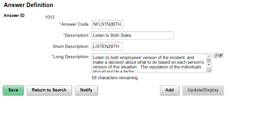

Recruiting Answer Definition Page
Use the Recruiting Answer Definition page (HRS_ANSWER_DEF) to set up answer definitions.
Navigation:
Set Up HCM, and then Product Related, and then Recruiting, and then Screening, and then Recruiting Answer Definition, and then Recruiting Answer Definition
This example illustrates the Recruiting Answer Definition page.
Field or Control Description
Answer Code
Enter a code that identifies this answer. This code appears only on search pages and lookup dialog boxes. The system does not require this to be a unique code.
Description
Enter an identifying name for this answer. A descriptive name helps you when you reference the answer definition from within a question definition. Other pages that display answers, however, use the full text of the answer rather than these shorter identifiers.
Long Description
Enter the complete text of this answer.

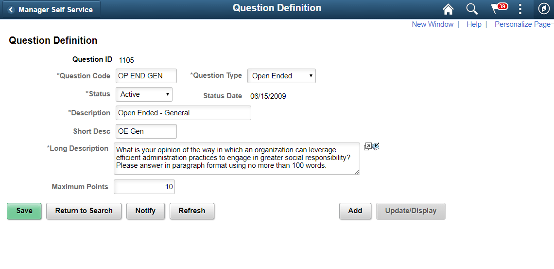

Recruiting Question Definition Page
Use the Recruiting Question Definition page (HRS_QSTN_DEF) to set up question definitions.
Navigation:
Set Up HCM, and then Product Related, and then Recruiting, and then Screening, and then Recruiting Question Definition, and then Recruiting Question Definition

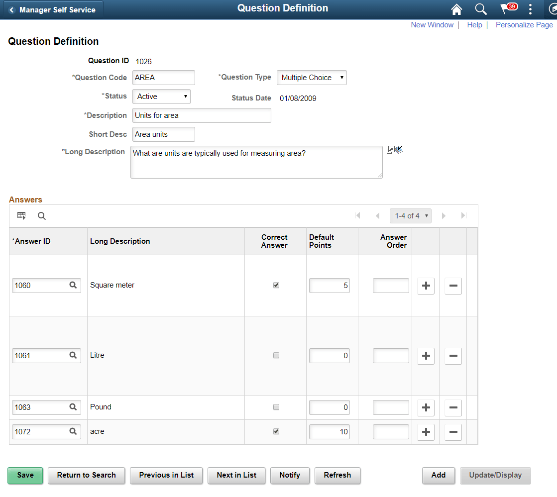

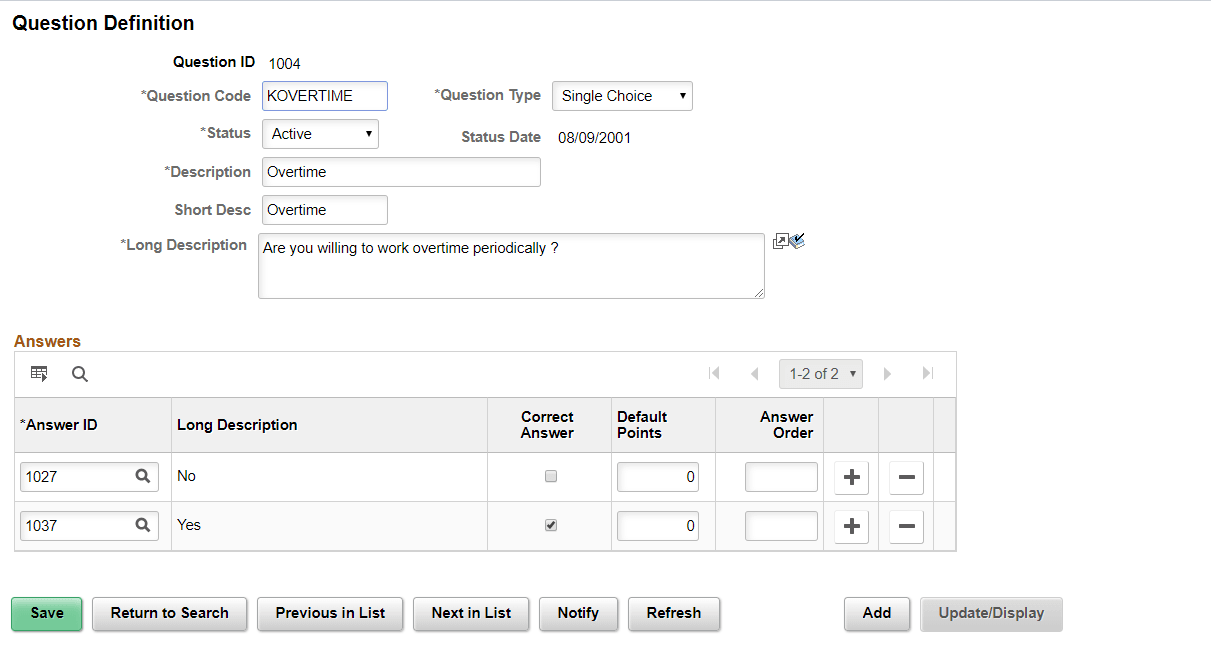

This example illustrates the Recruiting Question Definition page for Single Choice question.
Question Definition page for Multiple Choice question.

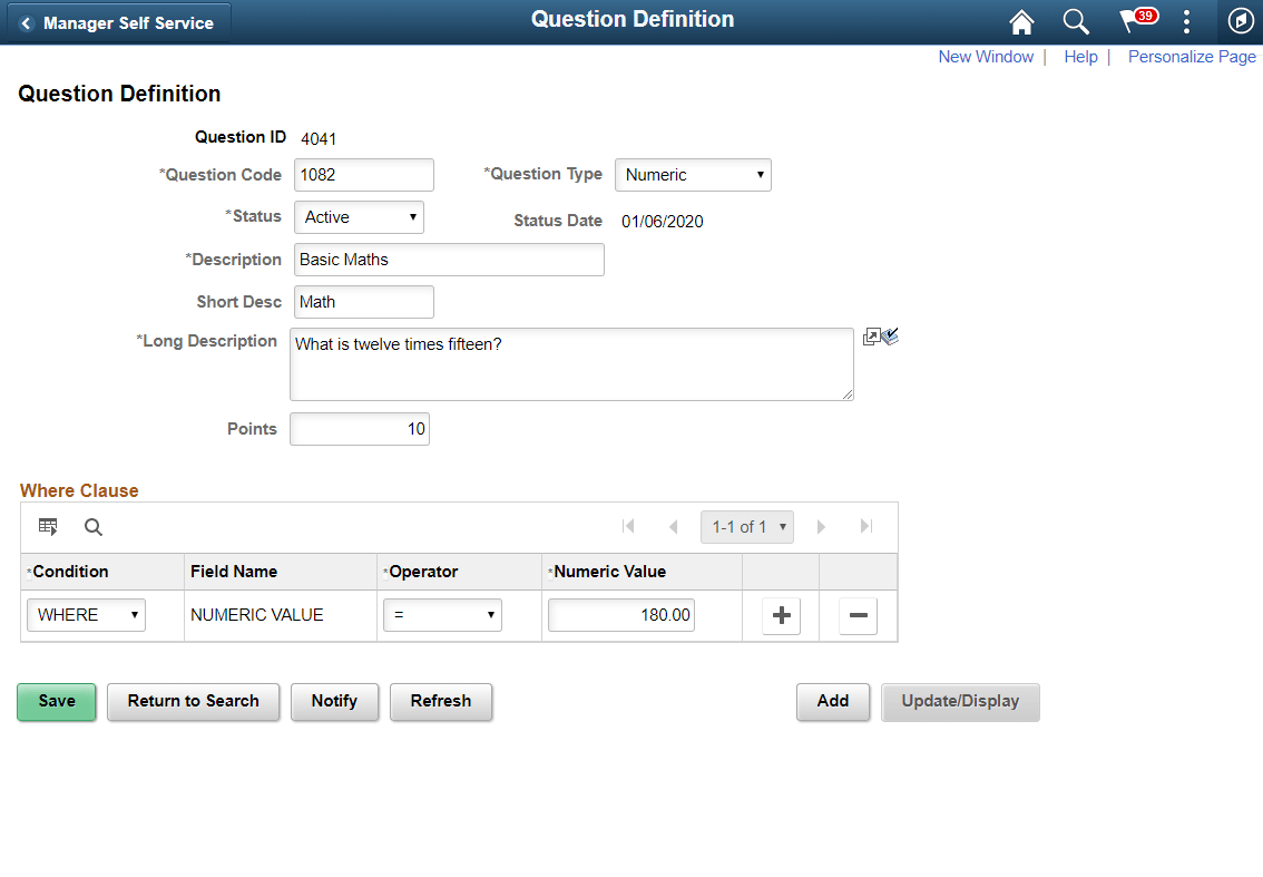

Question Definition page for Numeric question.

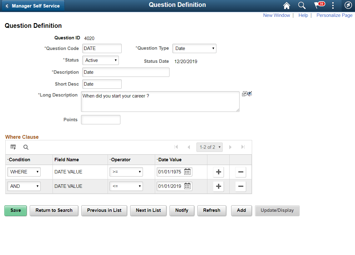

Question Definition page for Date type question.
Question Definition page for open ended question.
Question Code
Enter a code that identifies the question. This code appears only on search pages and lookup dialog boxes. The system does not require this to be a unique code.
Question Type
Choose the appropriate question type. The Answers grid changes based on the question type selected. The different question types are:
  • Date .Use this question type if the answer is a date value. Choosing this question type displays a Where Clause answer grid. Users can set the date or the date range using the operators in the Where Clause grid.
  • Multiple Choice. Use this question type if there are more than one correct answer for a question. The question must have at least two possible answers.
  • Numeric. Use this question type if the answer is a number. Choosing this question type displays a Where Clause answer grid. Users can set the number or the number range using the operators in the Where Clause grid.
  • Open Ended. Use this question type if there is no predefined answer for the question. Because open ended questions do not have predefined answer sets, selecting this removes the Answers grid from the page and replaces it with the Maximum Points field.
  • Single Choice. Use this question type when there is only one correct answer to be selected for the question. The question can have multiple correct answers with points for each of those answers but the user can select only one answer.
Status and Status Date
Indicate whether the definition is Active or Inactive. Whenever you change the status, the system changes the status date to the current date.
Description and Short Description
Enter an identifying name for this question. A descriptive name helps recruiters identify the question when they manage the list of questions in a job opening or question set.
Long Description
Enter the complete text of this question.
Maximum Points
If this is an open-ended question, enter the maximum number of points (up to 100) that an applicant can receive for answering this question. The actual number of points that the applicant receives is determined by averaging scores that evaluators manually assign. Evaluators who have not yet evaluated the answer are not included in the calculation.
Answers
This grid does not appear for open-ended, Date and Numeric type questions. Multiple-choice questions must include at least two answers. Single choice questions can have more than one correct answer but the candidate can choose only one answer. The answers appear as check boxes in the online questionnaire. For Date type and Numeric questions, a Where Clause appears where you can specify the condition for the correct answer.
Answer ID
Select an answer to link to the question.
Long Description
After you enter an answer ID, the text of the answer (the long description on the Answer Definition page) appears in this column.
Correct Answer
Select the check box next to any answer that is correct answer for the question. There can be more than one correct answer.
There must be at least one correct answer.
Default Points
Enter the default number of points that an applicant who selects this answer receives during screening. You can assign points to both correct and incorrect answers, depending on your business processes. When applicants can choose more than one answer, the screening process adds the points for all chosen answers to calculate the total points that the applicant is awarded for the question.
It is possible to assign negative points to incorrect answers.
Recruiters can override the correct answer and default point value of an answer when configuring criteria for a specific screening level in a specific job opening.
Answer Order
Optionally enter numbers to set the order of the answers. This order is used wherever questions and answers appear in Candidate Gateway and Talent Acquisition Manager.
If you enter an order for some answers but not others, the answers without orders appear first, followed by the ordered answers.
If multiple answers have the same value (or with no value) in this field, the system uses the Answer ID to order those answers.
Note: If the Randomize Screening Answers field on the Recruiting Installation – Jobs Page page has a Yes value, then the system disregards the answer order and presents answers in random order.

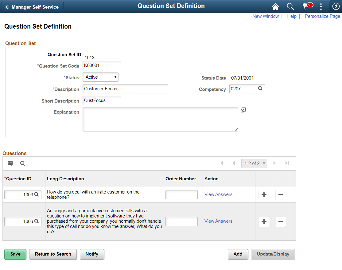

Recruiting Question Set Page
Use the Recruiting Question Set page (HRS_QSTN_SET_DEF) to set up question set definitions.
Navigation:
Set Up HCM, and then Product Related, and then Recruiting, and then Screening, and then Recruiting Question Set, and then Recruiting Question Set
This example illustrates the Recruiting Question Set page.
Question Set Definition page
Question Set Code
Enter a code that identifies this question set. This code appears only on search pages and lookup dialog boxes. The system does not require this to be a unique code.
Description
Enter an identifying name for this question set. A descriptive name helps recruiters identify the question set when prompting for a question set to add to a job opening.
Competency
Optionally identify the competency that is assessed through the applicant's answers to the questions in the question set. This is informational only; the competency does not affect the job opening, nor is it added to the job opening when you load the question set.
Explanation
Enter details about the purpose or contents of the question set. This is helpful to anyone who needs to update the question set. It is not visible to users who add the question set to a job opening.
Questions
Question ID
Enter the ID of each question that you want to add to the question set.
Long Description
After you enter a question ID, the text of the question (the long description on the Question Definition page) appears in this column.
Order Number
Enter numbers to control the default order of the questions in the set. When you load the question set into a job opening, these become the default order numbers in the Screening Questions grid. Users can then modify the order numbers for the individual job opening.
The system does not prevent you from assigning the same order number to multiple questions. When you load question set definitions into a job opening, review the default order numbers and update them as necessary to create an unambiguous question order.
Because this field accepts only integers, consider using non-consecutive numbers to make it easier to insert additional questions between existing questions.
Note: If the Randomize Screening Questions field on the Recruiting Installation - Jobs page has a Yes value, then the system disregards the question order and presents questions to applicants in random order.
Action
Displays a link to the Question Answers page.

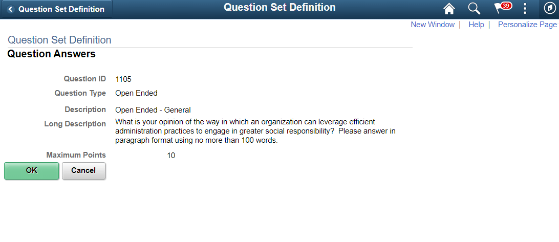

For open-ended questions, the link text is Open Ended. When you click this link, the Question Answers page displays the text and the maximum point value of the open-ended question.
For other questions, the link text is View Answers. When you click this link, the Question Answers page displays the question, its correct and incorrect answers, and the default point value of each answer.

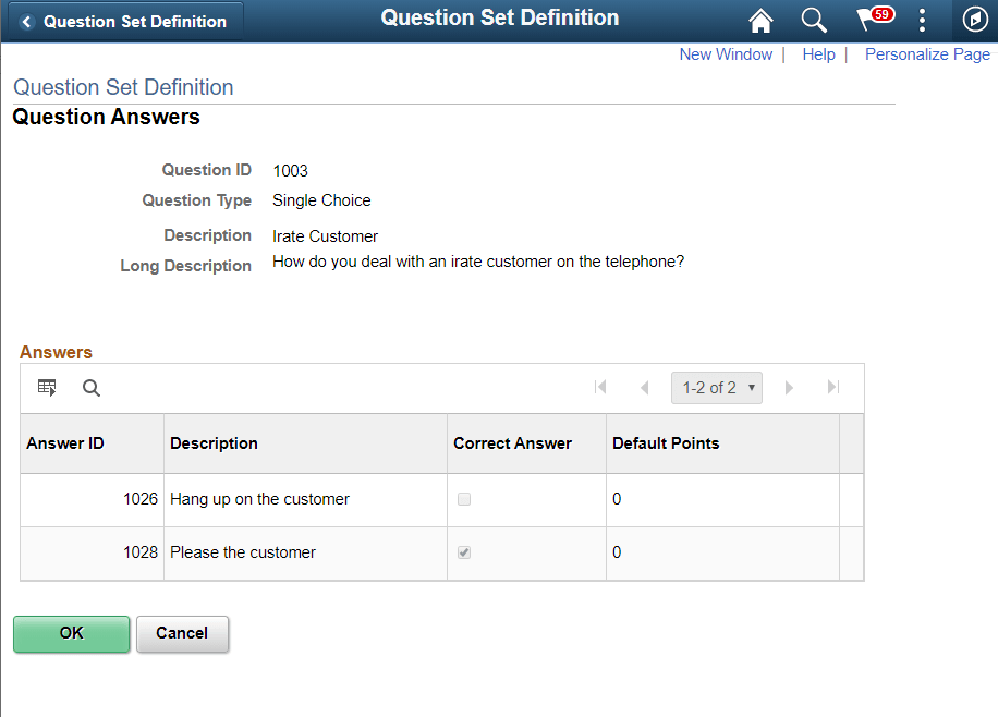

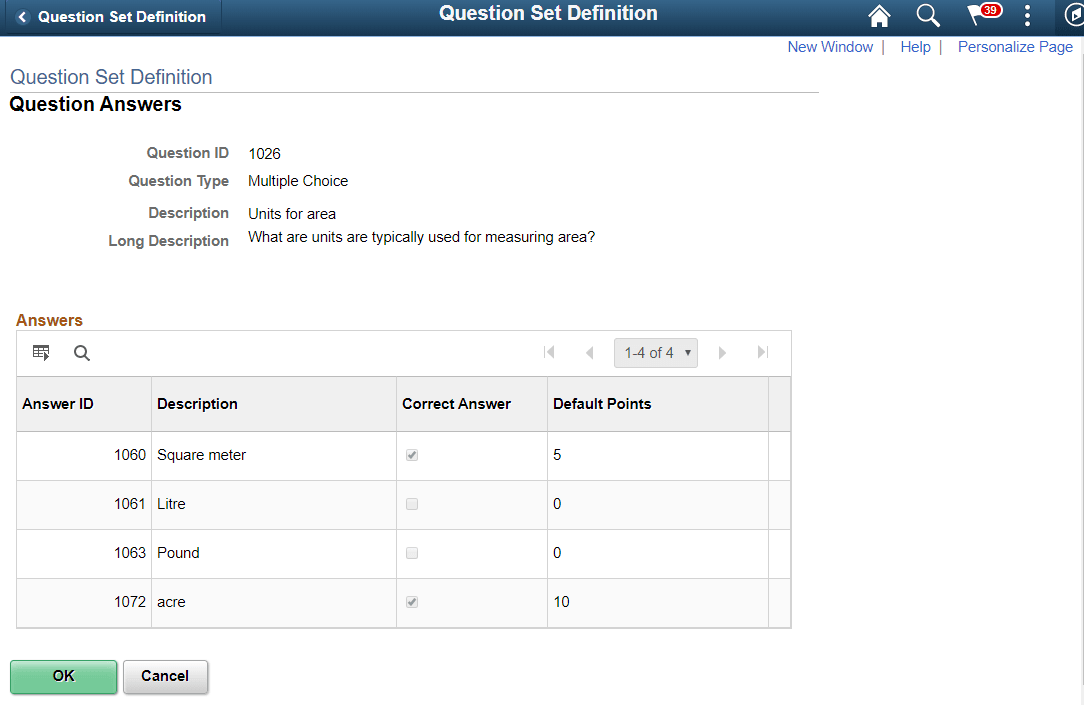

Question Answers Page
Use the Question Answers page (HRS_QSTN_SET_ANS) to view answers to questions.
Navigation:
Click the link in the Action column of the Questions grid on the Question Set Definition page.
This example illustrates the Questions Answers page for a multiple-choice question.
Questions Answers page: multiple-choice question
Question Answer page: Multiple Choice question
This example illustrates the Question Answers page for an open-ended question.
Question Answers page: open-ended question

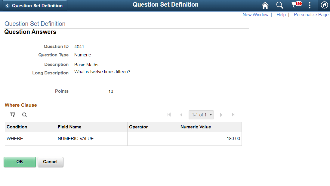

Question Answers page: numeric question.

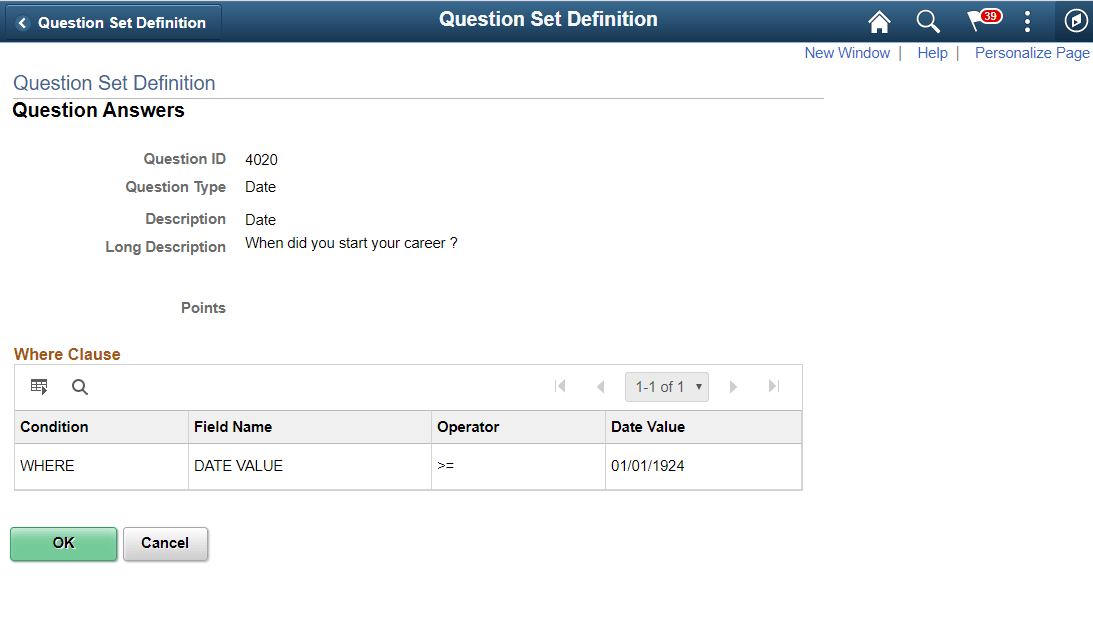

Question Answers page: Date type question
For multiple-choice questions, this page displays the answer choices and their default point values.
For open-ended questions, this page displays the question and its maximum point value.
For Numeric and Date value questions, this page displays the where clause and the default points values.
