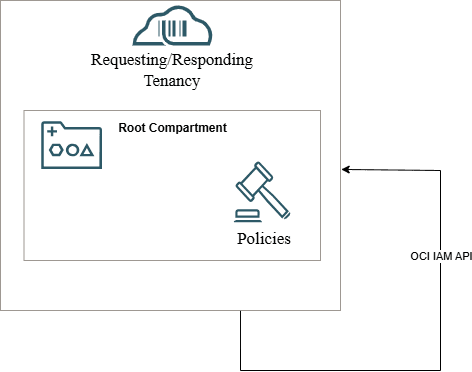

Policy Placement when Oracle Access Governance Service Instance (Requester) and OCI Tenancy (Responder) being governed are in the same tenancy
- Host tenancy on which the Oracle Access Governance Service Instance resides. This is the requesting tenancy which needs to access the OCI IAM API from a responding tenancy, so that data can be retrieved/updated for the identities that are being governed.
 - Tenancy where OCI IAM identity data is present.
In this use case you only have to deploy the generated policies to the one tenancy. They will cover the access required for the tenancy as both requestor and responder.

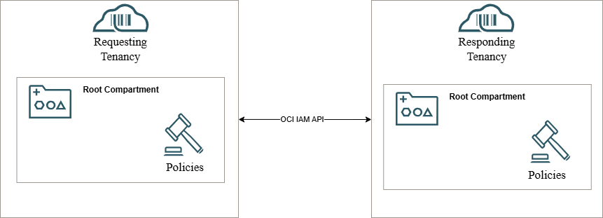

Policy Placement when Oracle Access Governance Service Instance (Requester) and OCI Tenancy (Responder) being governed are in different tenancies
- Policies relevant to the requesting tenancy should be deployed to the OCI where your Oracle Access Governance Service Instance resides.
 - Policies relevant to the responding tenancy should be deployed to the tenancy where your OCI IAM identity data is present.
