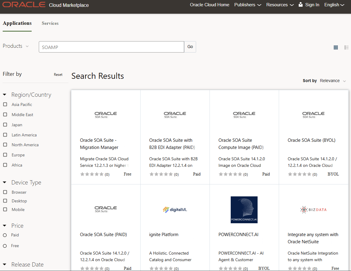

To provision an Oracle SOA Suite on Marketplace instance:
- Navigate to the SOA Suite 14.1.2.0 listing on Marketplace by
direct URL or by browsing in Oracle Cloud Infrastructure:
- Direct URL:
- In your browser, enter
https://cloudmarketplace.oracle.com/marketplace/en_US/homePage.jspx?tag=SOAMP.The Marketplace listings for SOA Suite 14.1.2.0 are displayed.
- Click the title for the listing you want to use to open the landing page, and review the information on the Overview page.
- Click Get
App.
- Select your Oracle Cloud Infrastructure region and click Sign In.
- Sign in to the Oracle Cloud Infrastructure Console.
- Browsing:
- Open the navigation menu and click Marketplace. Under Marketplace, click All Applications.
- In the Marketplace search field, enter
SOA.The Marketplace listings for SOA Suite 14.1.2 are displayed.
- Direct URL:
- Accept the terms and restrictions, then click Launch
Stack.
