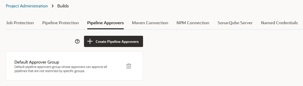

In the left navigator, click Project Administration
Go to the Pipeline Approvers tab.
Notice that a Default Approver Group has already been set up for the project. This group has no members initially. Its approvers can approve any pipelines that isn’t restricted by a specific approval group. If the default group has no approvers, however, nobody will be allowed to add any approvers to any pipelines in the project. Note that pipelines can’t be added to this group.
Add the default pipeline approvers now:
Select the default group. The Configure Pipeline Approvers dialog displays.
In the Configure Pipeline Approvers dialog, click in the Approvers field and select one or more approvers from the list and add them as default approvers.
Click Save.

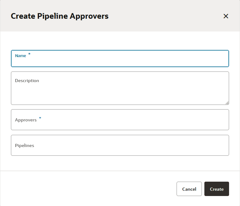

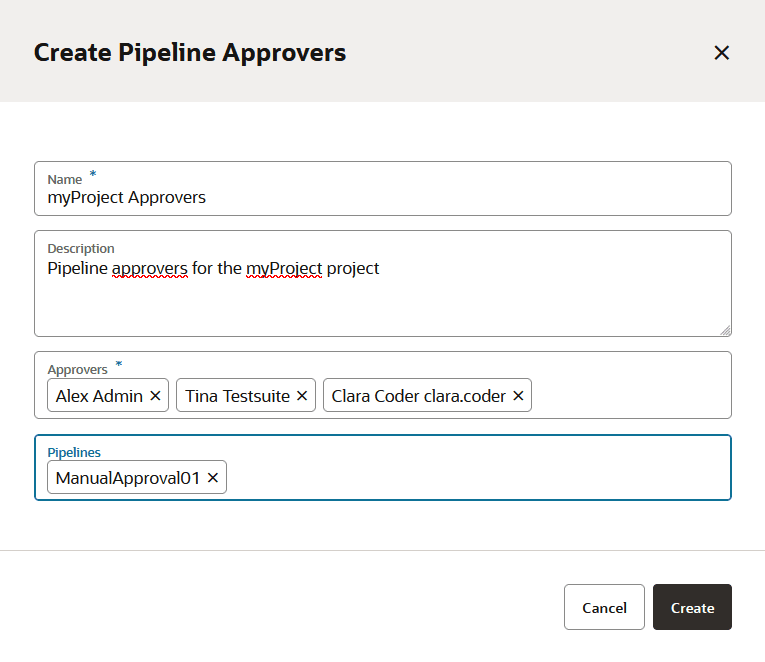

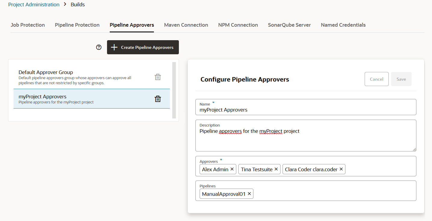

Click + Create Pipeline Approvers.
The Create Pipeline Approvers dialog displays.
Enter a name for your group in the Name field (required) and optionally describe the group in the Description field.
Click in the Approvers (Required) area and select the project members you want to add as approvers. You can also add individual members from alocal group, which are listed along the left panel. (Local groups are created at the Organizational level and added to the current project.) To add a team member from a local group, click the Approvers dropdown and select the member you want to add.
This step is required. Approvers you add to this approvers group will also appear in the list of approvers that you can select in the Pipeline Designer, when you configure the Manual Approval item (node). See Add a Manual Approval Item to Your Pipeline at Design Time.
Note: Users in Oracle Cloud Application environments that have multiple VB Studio instances in different identity stripes have username strings that include the environment name, where that user has been defined. Since a unique user may have been defined for multiple environments, this format ensures that one identity can be distinguished from that user’s other unique identities. This should help you select the correct user to add.
Click in the Pipelines area and optionally add the pipeline(s) that will require pipeline approvals.
Click Create.
You can see the group you just added, on the left, under the Default Pipeline Approvers group.

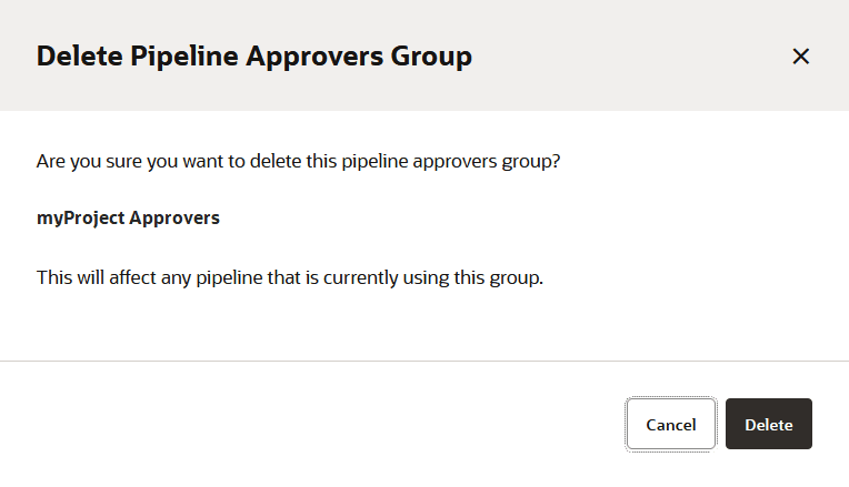

When you no longer need the group, click Delete
. You’ll be prompted to verify that you do want to remove your pipeline approvers group.
Click the Delete button and remove the group. Otherwise, click Cancel.

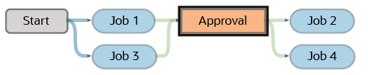

Let’s step through this process using an example. We could start with a very simple pipeline that has two jobs and an approval but it may be more interesting and realistic to create one that has joins and forks. If you already have a pipeline with two jobs, each connected to the Start node, you can skip to step 8 and start there. Otherwise, start at the beginning.
In the left navigator, click Builds
Click the Pipelines tab.
Click + Create Pipeline. The Create Pipeline dialog is displayed.
In Name and Description, enter a unique name and a description, respectively, then optionally select the appropriate check boxes for autostarting the pipeline and disable manual or automatic builds of the jobs that are part of the pipeline when the pipeline is running.
Click Create. The pipeline configuration page opens immediately after you create the pipeline.

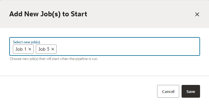

To add a new start job, right-click the Start node, and select Add New Start Jobs.
Search for and select the jobs that you want to add, then click Save. Here we’ve selected Job 1 and Job 3.

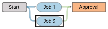

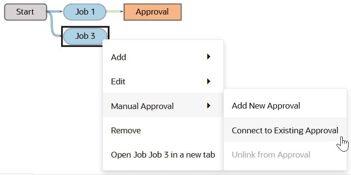

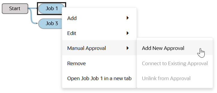

Right click the first job (Job 1) and select Manual Approval, then select Add New Approval.
Right-click the second job (Job 3) and select Manual Approval, then select Connect to Existing Approval.
The Connect to Existing Approval dialog opens.
Click the Select Approval field and, from the dropdown list, select the approval to invoke when this job completes (Approval, in this example), then click Save to close the dialog.
The approval will wait for both jobs to finish before notifying any approvers you configure.

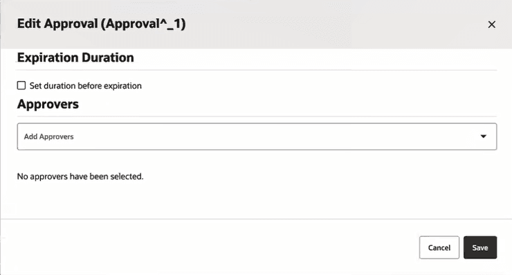

Right click the approval item, select Edit Approval.
The Edit Approval dialog is displayed.

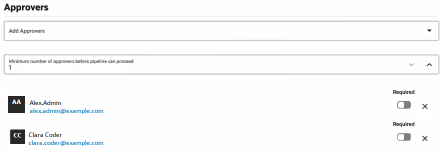

In the Approvers section, click the Add Approvers field and use the selector to choose the approvers that can approve this manual approval from the list displayed.
Here we’ve selected Alex Admin and Clara Coder.
Toggle the Required setting to on to make the approver’s approval mandatory.
Repeat for all the project members you want to be approvers.
If you select more than one approver from the list, you’ll see a field for setting the Minimum number of approvers before the pipeline can proceed field filled in with one approver, who is required.
The minimum number must always be equal to or greater than the total number of required approvers. For example, if Alex Admin and Clara Coder are both selected as required reviewers, then the minimum number of approvers must be at least two. If you wanted either Alex Admin or Clara Coder’s approval to allow the pipeline to continue, then you would set both of them to not required and set the number of approvers to 1.

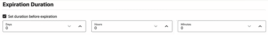

In the Expiration Duration section, click the Set duration before expiration check box.
Description of the illustration edit-approval-duration-checkbox-selected.png
Use the Days, Hours, and Minutes selectors or enter values to set the length of time to wait for an approval. If you enter or select a value of 72 in the Hours field, for example, it will be converted to a value of 3 in the Days field. Similarly, 25 hours will be converted to 1 day and 1 hour.
Click Save to exit the values you set.

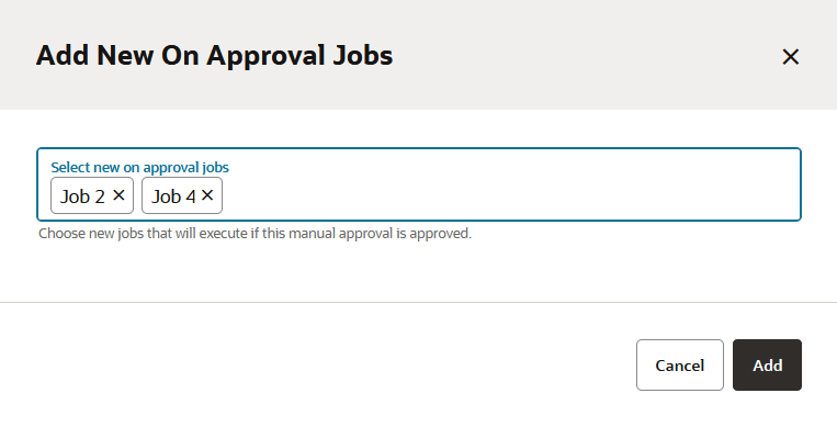

Right-click the approval item again and select the Add New On Approval Jobs option. The Add New On Approval Jobs dialog displays.
Select a new on approval job, or select multiple jobs.
We’re adding two jobs, Job 2 and Job 4.
Click Add to add the two jobs to the pipeline.

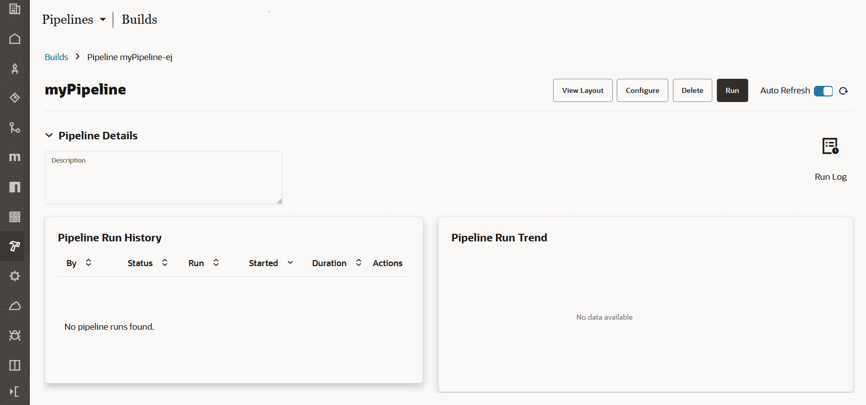

Click Save to save the pipeline.
The Pipeline Details screen is displayed.
Click Run to run the pipeline. If you don’t see a notification, go to the Profile tab your user account and, under User Preferences, check that the user has been verified. See Add Manual Pipeline Approvals.

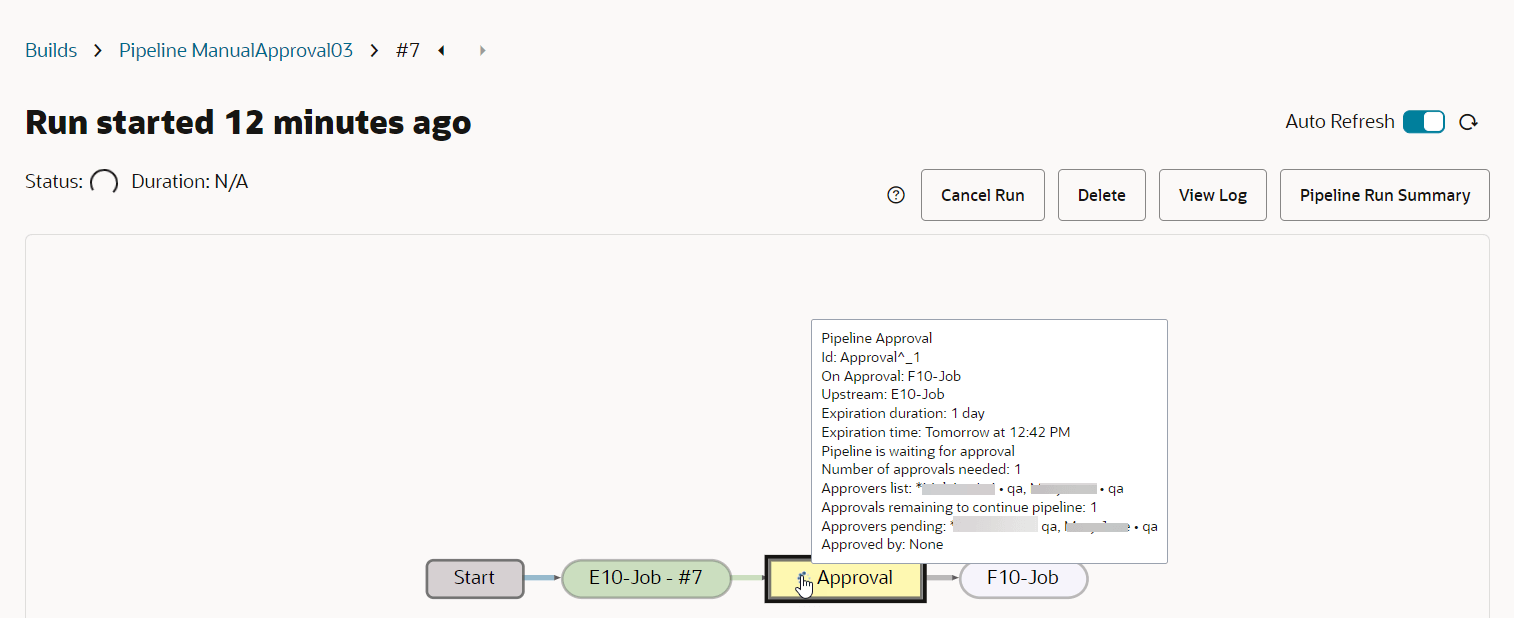

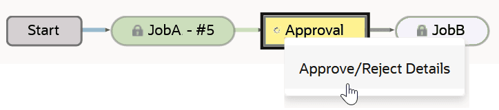

If you’re an approver, you can either approve or reject a Manual Approval action from the Pipeline Run page, where the graph or layout for the pipeline run is displayed. You can also add comments about why you approved or rejected the approval.
In the graph, locate the yellow Approval item.

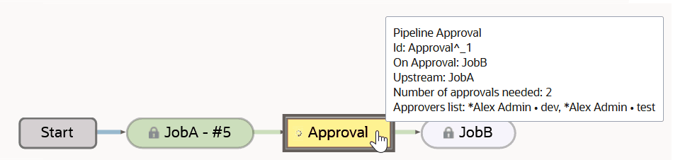

The approval node is yellow, which indicates that some action is needed. The spinner indicates that the approval process is ongoing and likely in a waiting state.
Hover over the approval node.
You’ll see that the pipeline is waiting for approval, how many approvals are needed, how many approvals have been approved, who the approvers are, how many approvals are pending, the length of time before the approval expires (and will be automatically rejected), and so on.

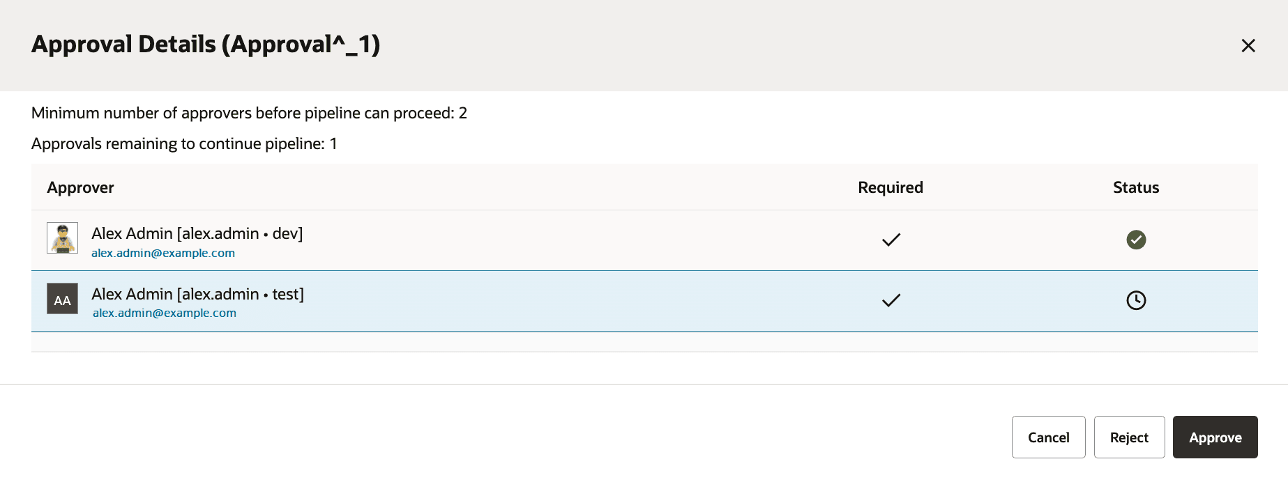

Right click the approval item and select Approve/Reject Details.
The Approval Details dialog is displayed.
Two approvals are needed. It looks like alex.admin-dev already approved, so now alex.admin-test (the blue stripe indicates that that’s you) needs to approve or reject the run.
Select one of the options:
Select Approve.
A confirmation message shows that an approval has been submitted. The pipeline will continue executing. After the approval has been completed, the approval item will turn green, and any downstream jobs will too after they successfully execute.

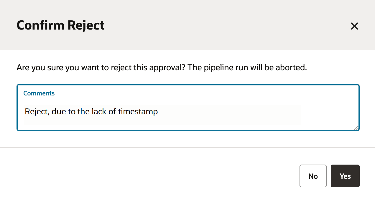

Select Reject.
You’ll be prompted to confirm that you want to reject the approval and will be allowed to add a comment explaining why you chose this action.

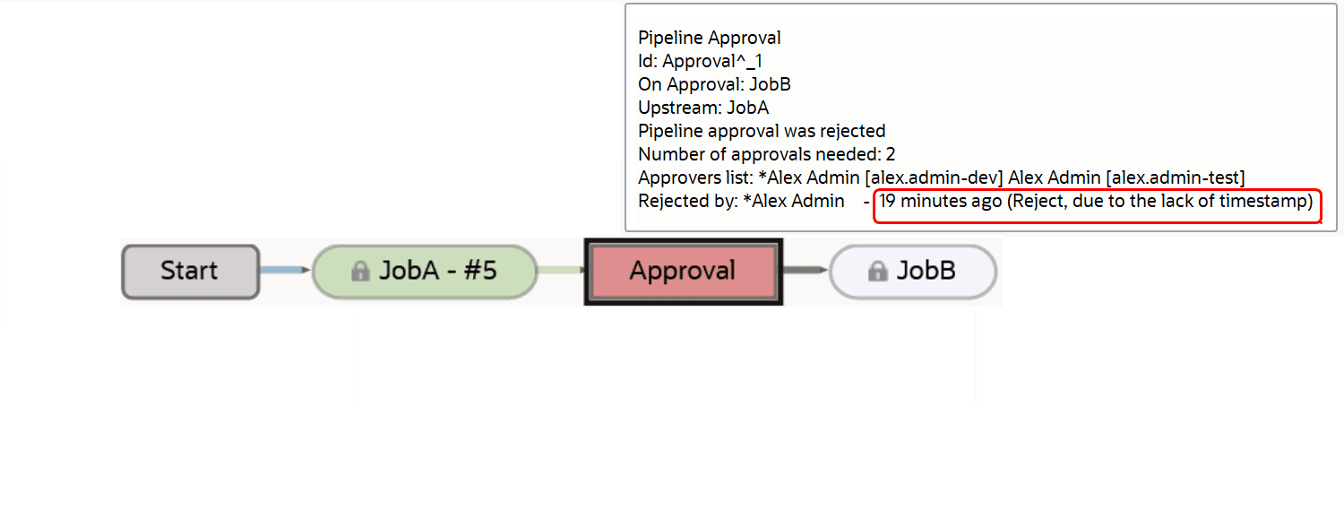

The approval item turns red and the pipeline execution halts. No downstream jobs are executed so they remain white, instead of completing and turning green. When you mouse over the approval node, you’ll see that it was rejected and the comment that was added in the confirmation window.
The red thumbs down icon

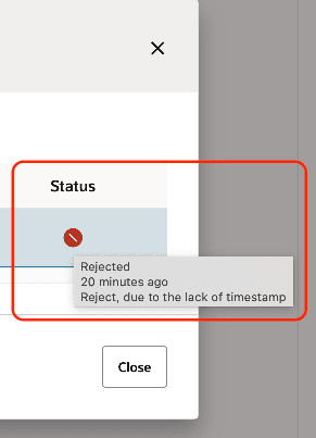

, at the top of the screen, indicates that the pipeline run was rejected.Tip: If you mouse over the rejected icon in the Status column of the Approval Details screen, this is representative of what you may see.
Description of the illustration mouseover-reject-status-approval-details-window.png
Notice the timestamp that shows when the approval was rejected and any comments that were added explaining why.
If an expiration duration was set for the manual approval but nobody approves it during the specified interval, the build system automatically rejects the approval. The activities stream displays the reason for the rejection. In addition, the Pipeline Run Summary screen and the notification email that is sent to required approvers also indicate why the approval was rejected.
Note: Currently, you can’t resume a pipeline after it has been rejected. You’ll need to address and correct the issue(s) that caused an approver to reject completing the pipeline run and then restart the pipeline and approval process.

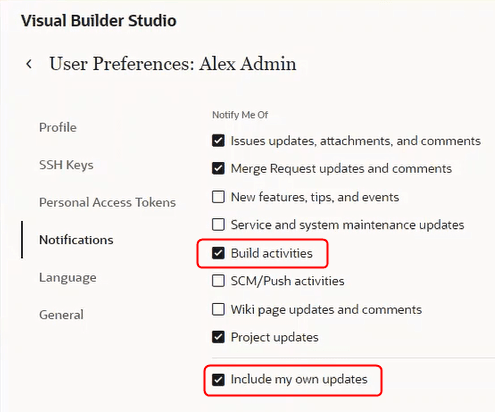

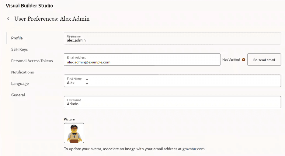

As an approver, there are a few tasks that you need to do to ensure that you can receive email notifications about pipeline approvals:
Make sure you verified your email address or you won’t receive any VB Studio email notifications at all.
You don’t want to see this message.
Make sure you enabled notifications for Build activities and that you’re also set up to include your own updates.
The check boxes encircled in red need to be selected.
To check both items, click the user avatar and select Preferences. See Configure Your Global Email Notifications for additional information about these items that you need to check and potentially address.
