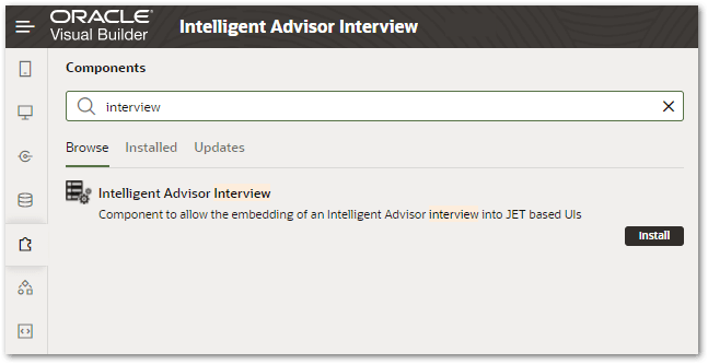

  3. Install the Intelligent Advisor Interview component. To do this:
    1. Open the Components tab in the Navigator.
    2. Type "interview" in the search field. The Intelligent Advisor Interview component should be listed.
      The Components browser in VBCS showing the Intelligent Advisor interview component
    3. Click the Install button for the Intelligent Advisor Interview component. For more information, see Get Components From the Component Exchange.

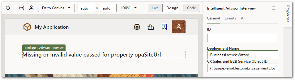

  5. Specify the deployment for the Intelligent Advisor Interview component. To do this:
    1. On the canvas or in the Page Structure view, select the Intelligent Advisor Interview component.
    2. In the right-hand Properties pane, select the General tab.
    3. Enter the name of the interview in the Deployment Name field.
      The Deployment Name setting for an Intelligent Advisor interview in a web application in VBCS
    For more information, see The Properties Pane.

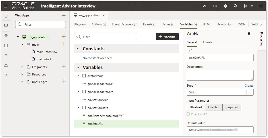

  6. Specify the Intelligent Advisor Hub for the interview. To do this:
    1. Select the application node (for example, my_application) in the Web Apps pane to open the application in the designer.
    2. Open the Variables tab.
    3. Select the opaSiteURL variable.
    4. In the right-hand Properties pane, enter the Intelligent Advisor Hub URL in the Default Value field. Note that only the server is required and not the opa-hub name. (For example, https://myserver.com.)
      The opaSiteURL settings for a web application in VBCS
    For more information, see What are Variables and Types?.

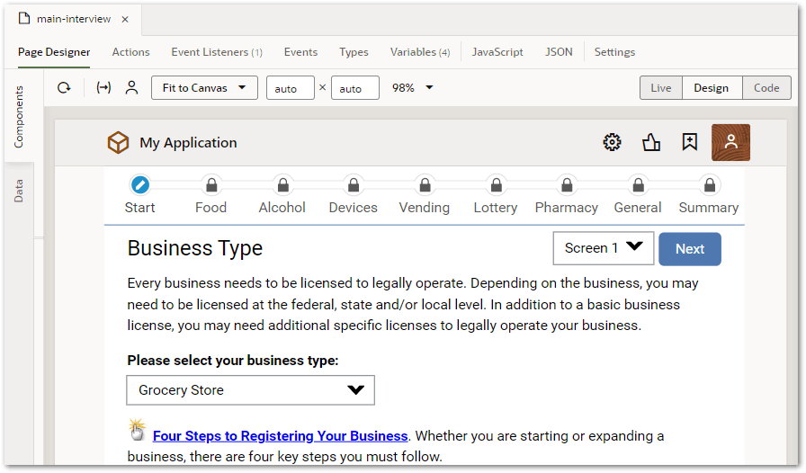

    If you now return to the page where you added the Intelligent Advisor Interview component, you should see the first screen in the Intelligent Advisor interview displayed. (Note that if you are embedding an interview for logged-in users in Oracle Fusion, you will not see the Intelligent Advisor interview here yet. See Add an Interview to Digital Customer Service for the extra steps required.)
    An Intelligent Advisor interview embedded on a page in a web application in VBCS

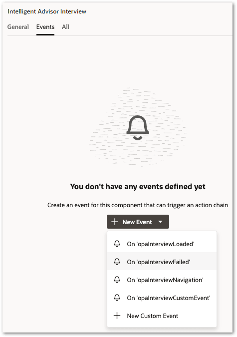

  8. (Optional) Add any of the predefined Intelligent Advisor events that you want the Intelligent Advisor Interview component to fire. To do this:
    2. In the right-hand Properties pane, select the Events tab.
    3. Click the + New Event button and in the drop-down menu, select one of the predefined Intelligent Advisor events.
      The Intelligent Advisor Interview component pre-defined events
      The options are:
      • On 'opaInterviewLoaded' - Triggered when an interview is successfully loaded. The name of the deployment is passed in the event detail.
      • On 'opaInterviewFailed' - Triggered when an interview fails to load. Note that the opaInterviewFailed event will not fire as a result of a Cross-Origin Resource Sharing (CORS) error when the Visual Builder site has not been added to the list of accepted CORS hosts in Intelligent Advisor Hub. This is expected behavior due to the way that browsers handle HTTP requests that fail due to CORS errors.
      • On 'opaInterviewNavigation' - Triggered when an interview is completed and suggests a navigation target. The URL for the navigation target is passed in the event detail.
      • On 'opaInterviewCustomEvent' - Triggered when a custom event is raised in an interview extension.
      The Actions editor is displayed for the new action.
    4. Drag the desired actions from the Actions palette into the action chain. For more information, see Create an Action Chain.
