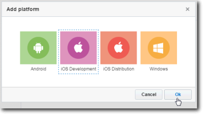

On the Platform page, click the Add Platform button.
On the Add platform dialog, select iOS Development, and then click Ok.

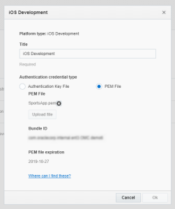

The iOS Development dialog is displayed. It assumes that you have a .PEM file ready to upload. If you do not, proceed to step [1.2]. If you do, skip to step [1.3]
[1.2] The next step involves creating an Authentication file. Responsys supports Authentication Key Files and Push SSL Certificates (known as a .PEM file) via Apple’s iOS Provisioning Portal. These Authentication files give us permission to speak to Apple’s servers, which ultimately communicate with your application. If you are using .PEM files, at this stage, you will only need to create a Development Push SSL Certificate because you aren’t ready to ship or distribute your app yet.
This process can be a bit tricky, so we’ve created guides dedicated solely to generating the necessary files:
[1.3] Once you have generated the Authentication file, head back to the Mobile App Development Console to upload the file.
[1.3.1] On the iOS Development dialog, enter the app title (unique for your app and platform), and then click the Upload button.
[1.3.2] Browse to the location on your computer where the .PEM file is located, select it, and finish the upload.
[1.3.3] Click the Add button to complete the setup.

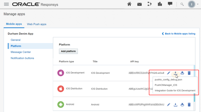

[1.4] Next, download our iOS OracleCXResponsys and a configuration file called pushio_config_debug.json. Click the Downloads menu of the iOS Development row to download these files.
Downloading the PushIO SDK files
Note: You can check your pushio_config_debug.json file by opening the file in TextEdit. You should see a populated bundleId value that matches your application, as well as an apiKey value that matches what you see listed on your iOS Development Platform page.
