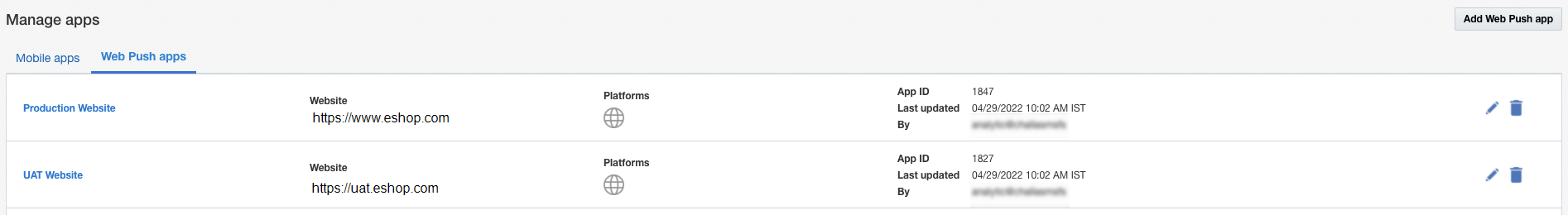

We are Deploying the Responsys Web Push Solution on our Website. We have a UAT / QA Website and a Production Website. How do we get started with the Integration?
First, Integrate and Test Web Push on the UAT / QA Website. Once the Integration is validated on the UAT / QA Website, promote it to the Production Website.
- Add Two Separate Web Push Apps, one for the UAT Website and another for the Production Website - it is highly recommended to maintain separate Web Push Apps (Tags, Service Workers) for the UAT Website and Production Website.
- Setting up Web Push Apps in Responsys: Oracle Responsys Developer - Setting up Web Push Apps.
Integrate Web Push Solution on UAT Website using the Web Push Tag, Service Worker from the UAT Website's Web Push App.

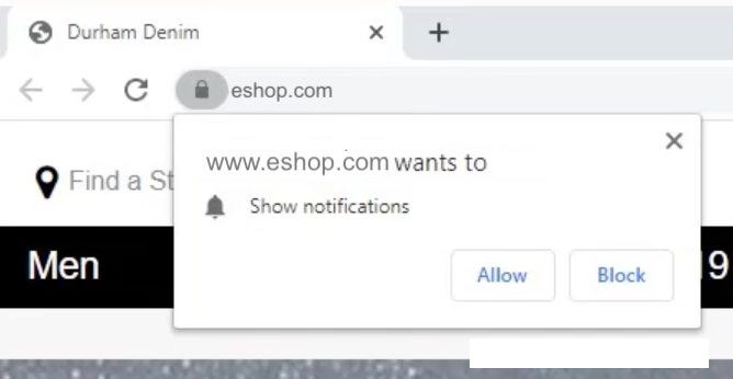

What does the Web Push Permission Prompt/ Pop-up look like? What is the Visual Design and Language of the pop-up?
Browsers issue the Web Push Permission prompt. Each browser has its own Visual Design and Language, but they are similar to the below example from Chrome on MacBook. You can try opening a Website that supports Web Push on different Browser and OS combinations to understand the Visual Design and Language of each Browser's Web Push Permission prompt.
