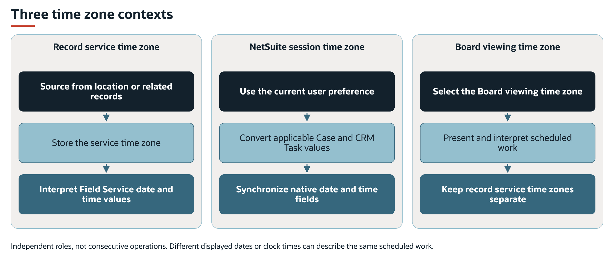

Three Time Zone Contexts
Three time zones can be relevant to the same service work:
Independent roles, not consecutive operations. Different displayed dates or clock times can describe the same scheduled work.
  • The record's service time zone identifies the time context of the work. The field is Time Zone on an asset and Field Service Time Zone on the other supported records.
  • The current NetSuite user's time zone uses the user's preference. It supplies the final sourcing fallback where applicable and the session context for native date and time conversion.
  • The Schedule Board viewing time zone controls how the board presents and interprets scheduled work. It can differ from both the record's time zone and the user's NetSuite preference.
Sourcing chooses a time zone for a record. Synchronization converts applicable date and time values between the record's time zone and the NetSuite session time zone. Changing the board's viewing time zone does not, by itself, replace every record's service time zone.
Field Service values and native values can show different dates or clock times for the same scheduled work. Parent and child records can have different service time zones, including cases on one project and tasks on one case.
