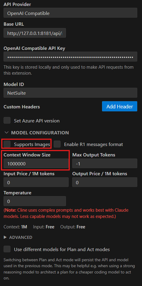

Configure your context window to 1,000,000 tokens and disable image support.
SuiteCloud Developer Assistant uses Cline as the interface to interact with large language models capable of supporting a 1,000,000-token context window. However, Cline defaults to a 128,000-token (128k) context window for OpenAI-compatible providers. This default can significantly limit the assistant's capabilities and may cause context truncation or compaction issues. You can manually configure Cline to use the full 1,000,000-token context window for better results.
Because images are not supported, disabling image options prevents confusion and error messages by making it clear that image uploads are not available.
To configure your context window to 1,000,000 tokens:
In VS Code, open the activity bar and click the Cline extension.
At the top of the Cline panel, click the gear icon to open the provider and model configuration.
In the Model Configuration section, locate the Model Context Window or Context Window Size setting.
Change the value from
128000(128k) to1000000(1M). -
Click Done to save the changes.
To disable image support:
In the Model Configuration section, clear the Supports Images box.

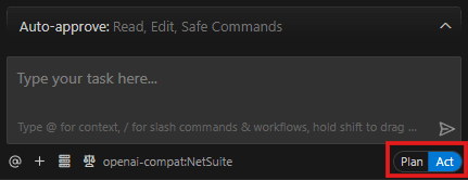

To switch between the Plan and Act modes, refer to the Plan/Act switch next to the provider and model selector.

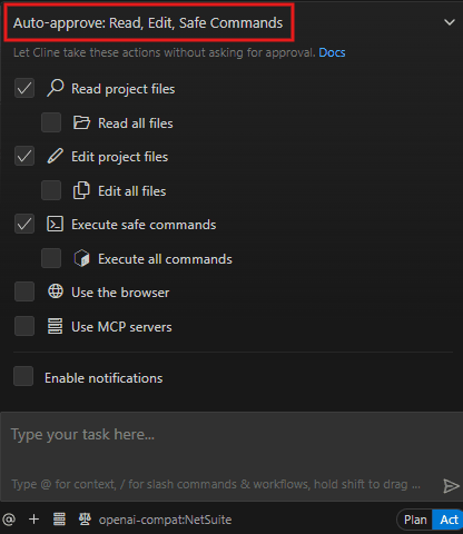

To enable or disable the automation options:
Click the Auto-approve tab located above the Cline chat box.
Select the actions you want Cline to take without requesting approval.

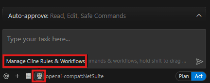

To access Cline rules and workflows, click the Manage Cline Rules & Workflows icon to the left of the provider and model selector.
