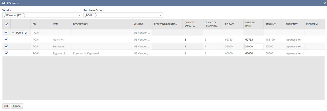

  5. In the Add PO Items window, select a Vendor to show purchase orders for that vendor.
  6. Select one or multiple Purchase Orders.
    NetSuite groups vendors and purchase orders under collapsed headers. Click the arrow to show all items.
    Add PO Items window with sample purchase order lines.
    You can edit the Expected Quantity and Expected Rate columns.
    You can split the quantity ordered across multiple shipments. On the item line, set Quantity Expected to the number of items in the current shipment. The Quantity Remaining field updates automatically.
  7. To include all items from a purchase order in the main form, check the box beside that purchase order.
  8. Click OK.
