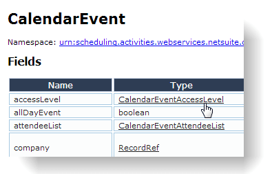

Many values listed in the Type column of the Fields table are links that take you directly to another reference page in the SOAP Schema Browser. These links include sublists, enumerations, BaseRef, and RecordRef. Click these links to view the object's reference page.

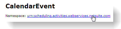

To browse objects in the same namespace as the record you are viewing, click the URL below the name of the record. The left pane will update with a tabbed list of all objects in that namespace. See also Navigating to a Different Object.
